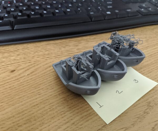

Hi All,
I finished assembling the MK3S kit, ran all the calibrations, and fine tune the print of the Prusa logo.  All great.

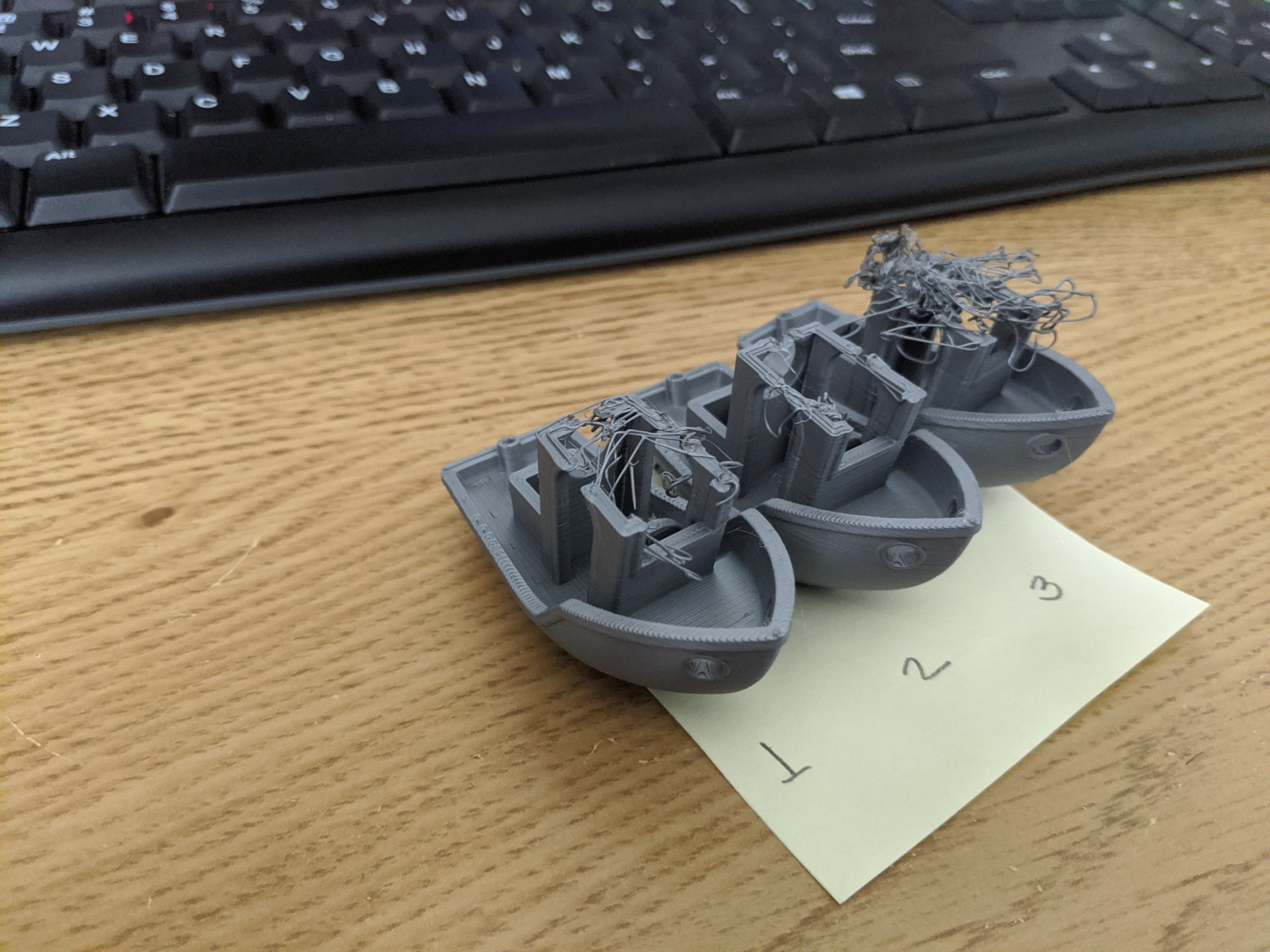

Then I proceeded to print 3D Benchy from the provided SD card using the provided filament from the kit.  I have fine tuned 1st layer calibration, belt tension, xyz axes, and I have not been able to finish the print.  The model looses adhesion from the bed and the print goes kaput (see attached photos).  The model detaches from the bed approximately about the same height (give or take).  I am using the double sided textured PEI.  I have cleaned the PEI with isopropyl alcohol 91% before every print.

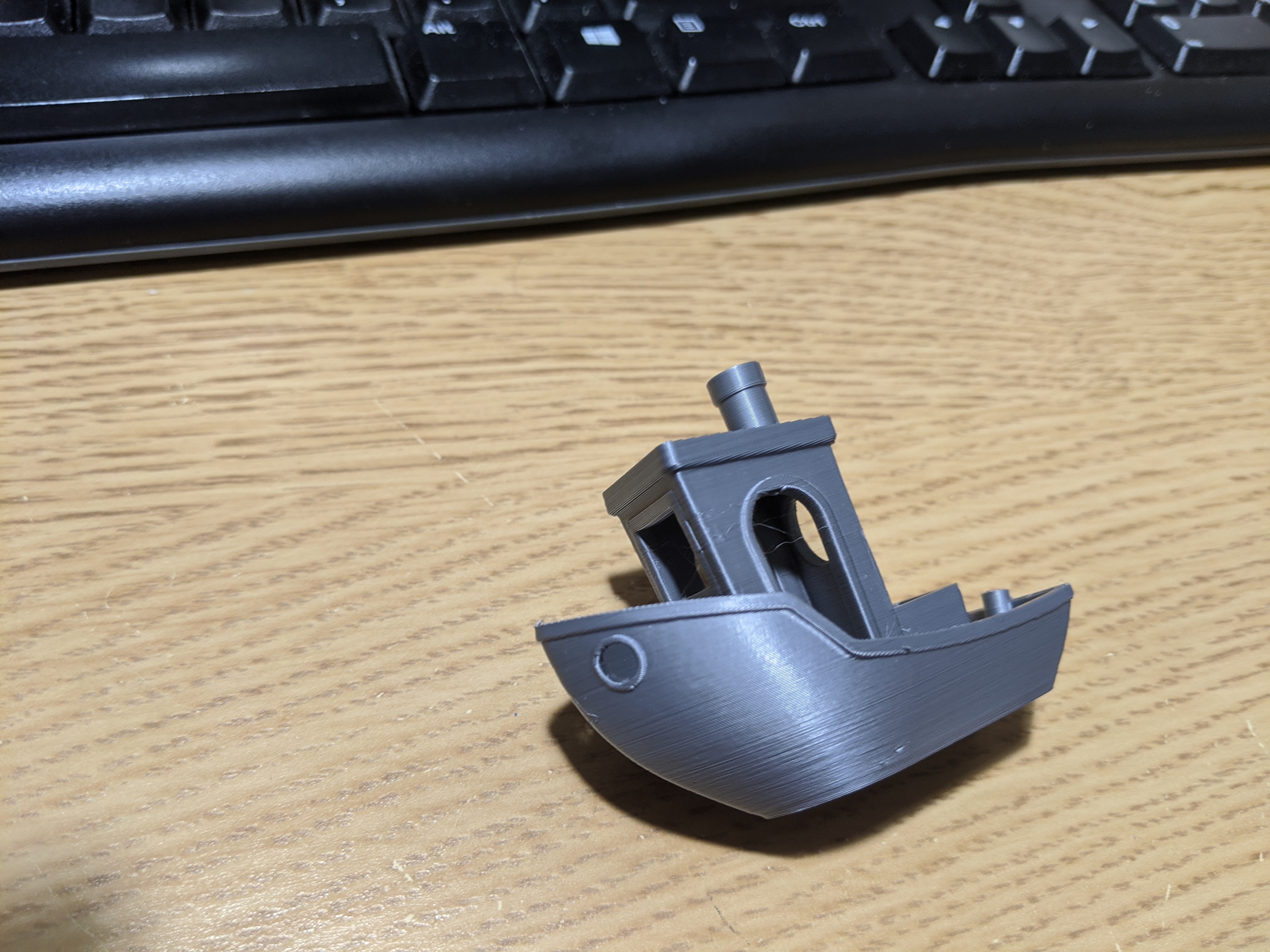

I did a print of the 3D Benchy at 75% speed and it was successful.
What else can I try to fix this problem?  Is the 3D Benchy supposed to be successful at 100% speed?
Thank you!
Using 75% speed Model loses adhesion about the same height.

@gkmakeit
This is the successful model back.
These are the failed models back
I hope this gives a clue.
Posted : 06/08/2020 4:29 am

Thank you for the suggestions peter-m26.  I cleaned the bed with soap water, increased the temperature of the bed to 70C, and printed at 100% speed.  I got these results:
There is a little issue on the back left edge, but at least it printed all the way through.

I would bring the nozzle down a little more, doesn't look like it's smooshing down enough.
Also check the movement of your X, Y and Z, make sure the belts are tensioned correctly. I've seen loose belts cause corners and radiuses to look similar to what you are seeing.
Good luck!
