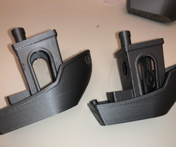

Hey,
I'm trying to improve the print quality of my new MK3s, that I assembled last week. I'm using the 3dBenchy as benchmark, using Prusa Silver PLA.
In the first print I've noticed something like ghosting. Then I've printed a fleet on benchys, trying to:
1. improved the X and Y belt tensioning several times. I've started from 286/290 and ended up to 258/268
2. re-assembled the Y carriage to check the bearrings alignment
3. moved the printer to the floor
4. sliced the stl instead of using the one in the SD card
5. moved the benchy to the corner
6. rotated the benchy orthogonal to the axes
The strange thing is that, after each test, I'm getting "exaclty" the same result, and the ghosting pattern looks the same !
The only different result I've got is using the standard 0.15 Quality profile, but with the "external perimeters speed" to 10 mm/s instead of 25 mm/s. This is clearly improving the quality.
Can you help me? What's the "out of the box" quality of the Benchy printed on your Prusa?
Thank you!

There are signs of both: Ghosting and VFA

Firstly, compared to some, your first prints are really good.
Next, read this thread and see what you think then prepare to go off down the rabbit hole 😉
https://forum.prusa3d.com/forum/original-prusa-i3-mk3s-mk3-user-mods-octoprint-enclosures-nozzles-.../stepper-motor-upgrades-to-eliminate-vfa-s-vertical-fine-artifacts/
BTW, did you lubricate your bearings?, if not, then do it NOW!.
I'm an advocate of light machine oil regularly, but a semi fluid lithium grease would be better as it tends to stay in the bearings longer so no need for as frequent lubrication as with oil. Also, do not fully pack the bearings with grease, and do not use grease with PTFE in it, although it will all still be better than nothing at all.

I'm trying to investigate why, if I set an "external perimeter speed" equal to 15 mm/s or less, ghosting is disappearing.
I've printed a calibration cube of 50mm, rotated 60 deg, to get some evidence of which axis is contributing to the ghosting. External perimeter speed set to 45 mm
This is the front side: you can see more ghosting on the left side and after the letter. My interpretation is the x axis is the main contributor, because the vector is 60 deg. It looks like that is the acceleration that is creating the ghosting.
This is the right side. Less ghosting. Does this confirm that the problem is the accelleartion of the x axis?
Back view: ghosting in the acceleration phase of the X axis?
Left view: Ghosting after the letter. Always the acceleration?
What do you think about this?

I'm going to focus on slicer settings as I don't see anything in your pics that looks unusual.
Slowing down perimeter speeds does several things:
  • It reduces the effect of acceleration and jerk between turning a corner and moving the nozzle up to full speed. Acceleration and jerk are well-known contributors to ghosting. This is more of a happy side effect. Prusa has made significant changes to the Mk3 acceleration and jerk settings since original release.
  • It reduces bed sway on direction changes. Compare faces on the X & Y walls to see if movement of the heavy bed impacts the severity of ghosting.
  • It gives the filament more time to heat and extrude evenly. This is more of an issue with adhesion.
You can try the extruder linearity correction calibration procedure to see it if helps with the moire patterning. I found it beneficial. It's always hard to tell from pics if this is a problem or just a lighting issue.
Did you notice any change moving the printer onto the floor? A vibrating surface can contribute to issues. I wound up mounting my Mk3 on a concrete paver when I moved it to a cabinet.
Edit: How big is that XY cube? It looks large in the pics.

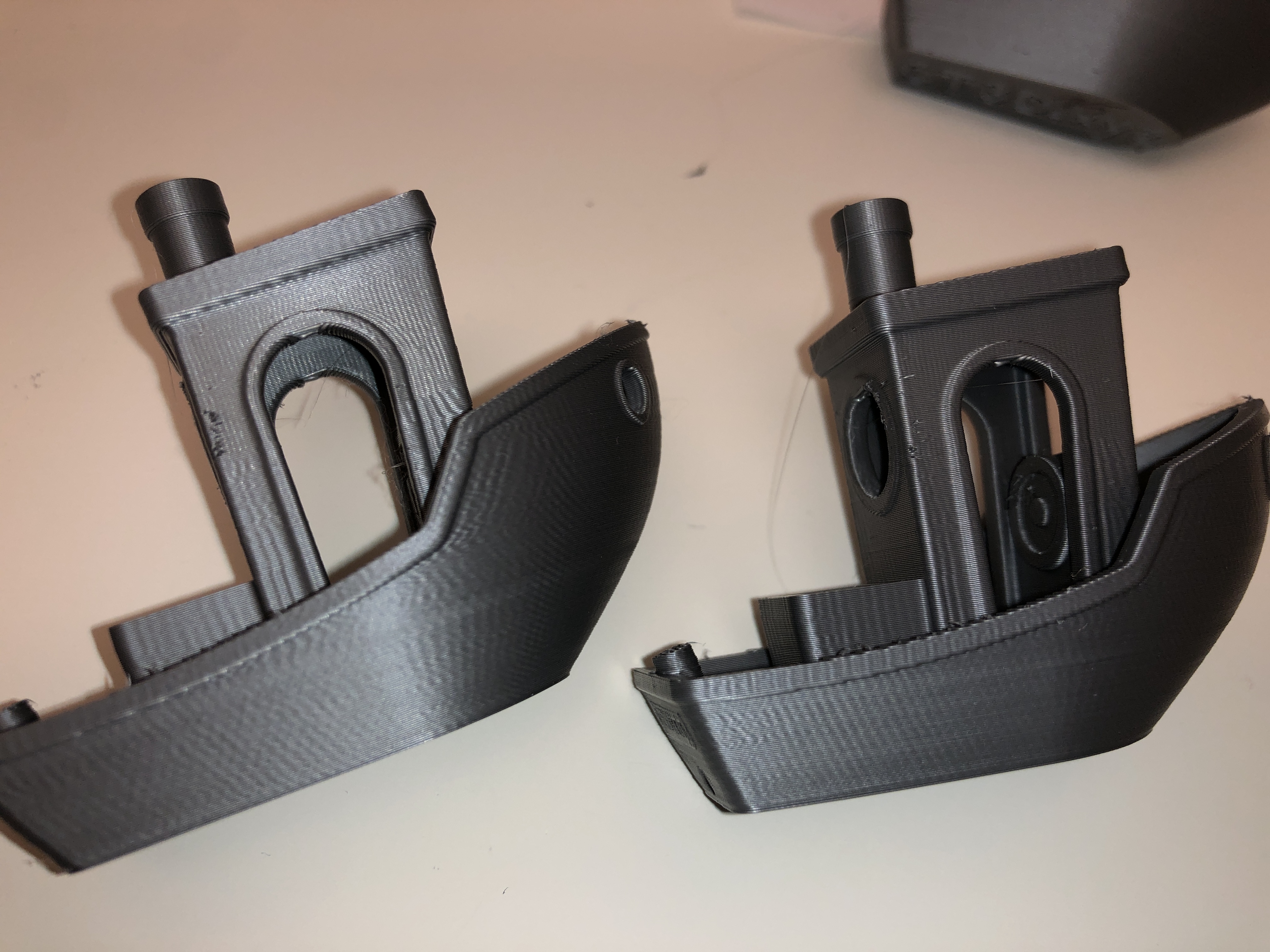

I've replaced the X bearings and the Y bearings with new fully lubricated bearings. I've done the full calibration.
I've reprinted the benchy. Same ghosting, same pattern, same result 🙁
I'm running out of options and ideas.

That appears to be extruder (non-)linearity. If the E-linearity calibration Bobstro mentioned does not affect it significantly, then really the only way to get rid of it is to change to a different extruder or extruder motor (0.9 degree steps). Personally I run a skelestruder with 3.5:1 gearing which eliminates that artifact nicely.
But beware, surface finish is a rabbit hole. The next thing that will show up is VFAs, which are reduced by changing the X/Y motors for 0.9 degree steppers, at that point ringing becomes the most prominent visual artifact.

Another quick update.
I've done several other tests. I've tried different types of feet, rigid, absorbing, and the factory ones. I've moved the printer to a marble base 45x45x6 cm. Weight 30 kg!
Long story short: the quality cannot be improved. The only way to improve the print is to lower the speed. It looks like that 15-20 mm/s for external perimeters is the best parameter you can use.
I think the real problem is the x-axis and x-carriage stability. The two rods are not so stable (eg. you can easily move the x-carriage 1-2 mms on the Y-axis). That's the reason why I'm getting ghosting especially in the movements that are simultaneously involving X and Y movements.
Example of a 45 deg perimeters. Up: 30 mm/s with different acceleration(200 to 1000mm/s2), Bottom 40 mm/s.
Example of only x movement perimeter
