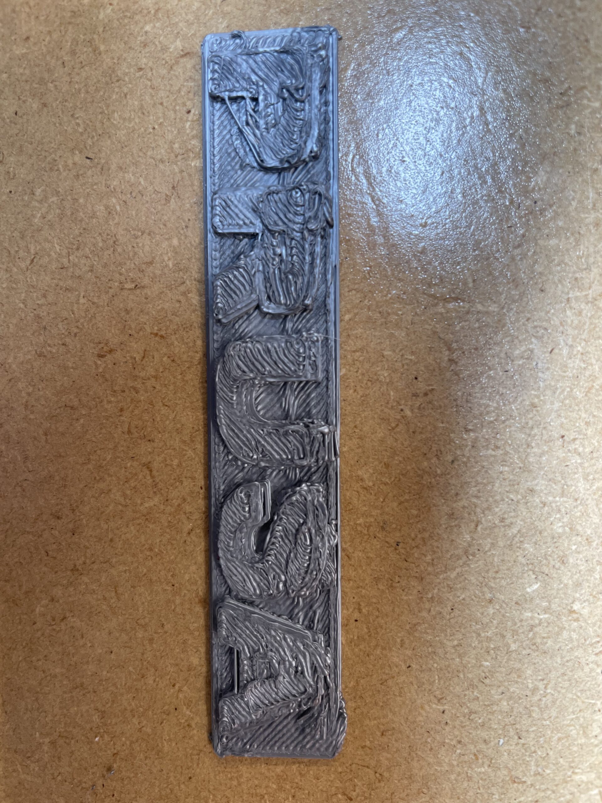

I’m brand new to this and I’m making my first prints from the samples supplied on the SD card using Prusa PLA.
I think I’ve set the first layer Z offset ok as the prints are not moving and take some effort to remove.
I’ve attached an image of the Prusa logo file which is quite messy.
I haven’t changed any parameters and I was hoping being a sample it would work out of the box.
Image below:
any help appreciated.
Thank you.

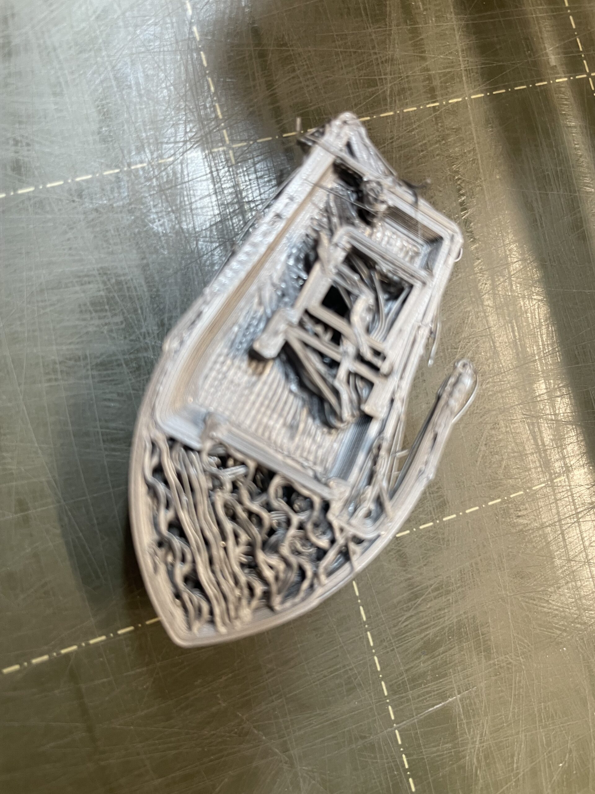

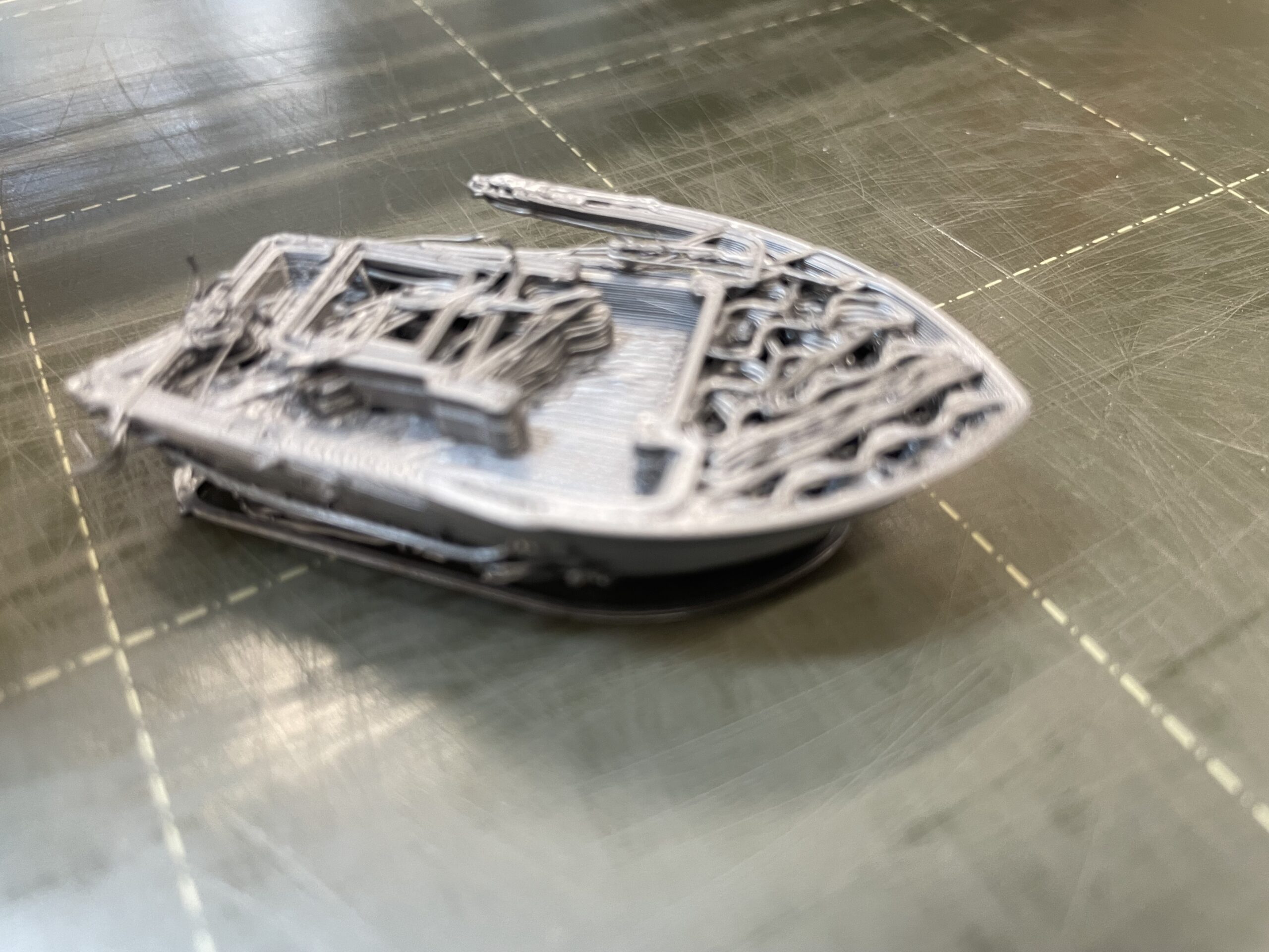

As a follow up here is a partly printed Benchy.
I think I have a way to go!

What did you do to your PEI sheet?? Or did you buy a used prusa printer it it looked like this from the beginning?
Do not use gcodes from SD card or downloads, slice the objects yourself and use prusa slicer: 0.2 mm quality / correct filament (or generic) / original printer profile
