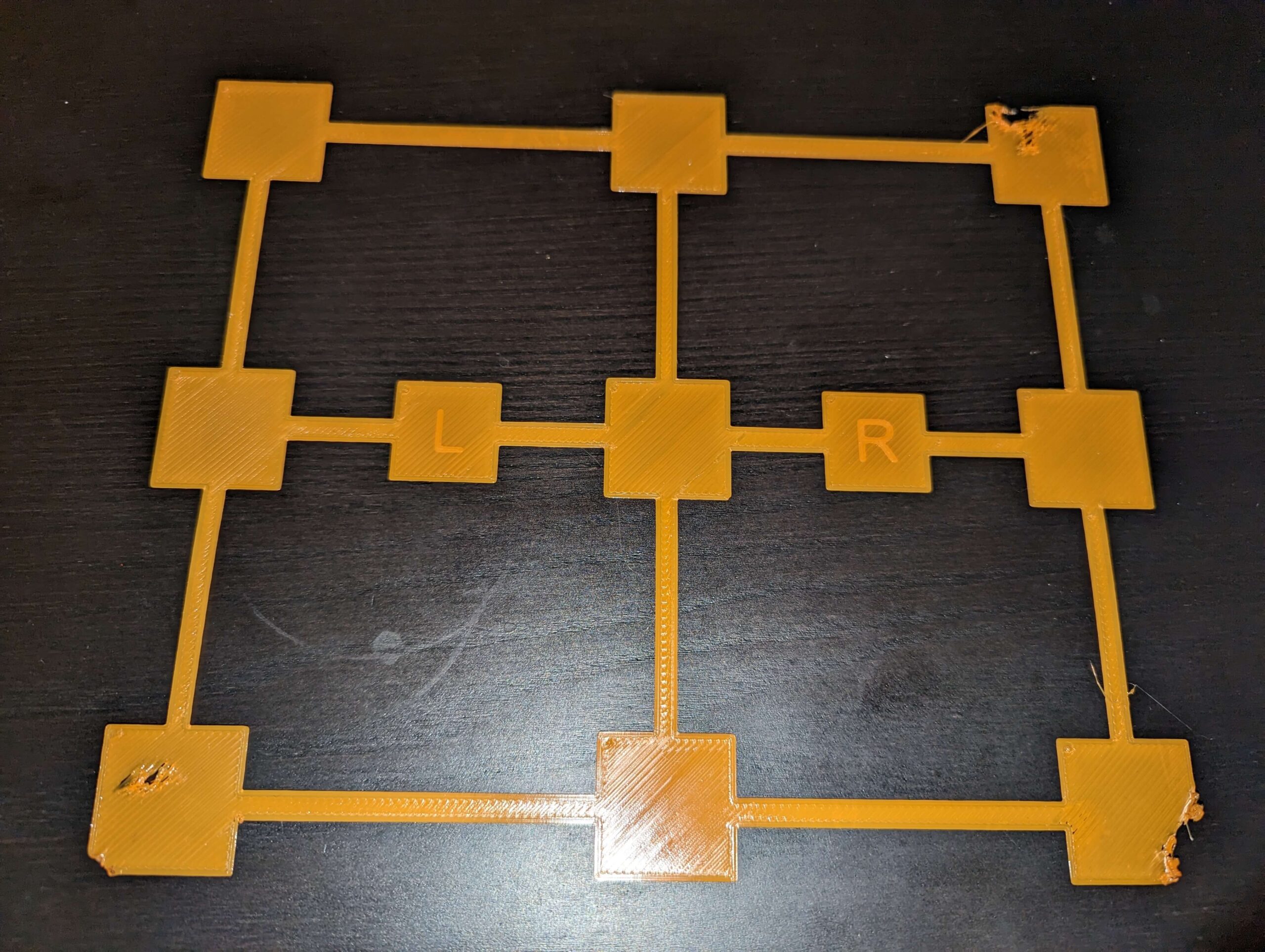

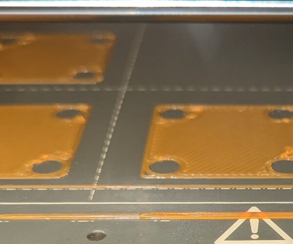

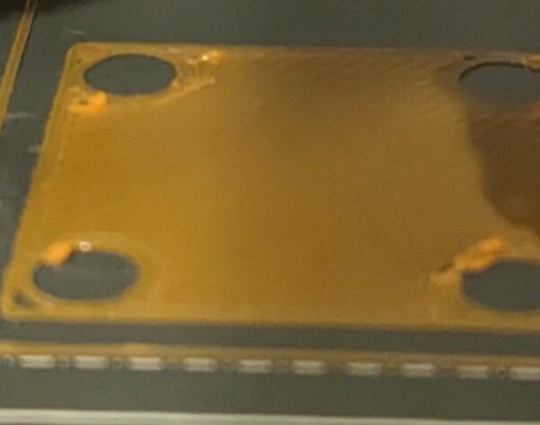

I have recently been printing a bunch of gridfinity items and to increase the speed I have switched to a .6mm nozzle.  I tightened the nozzle using a torque wrench to the specifications of 2.5 Nm.
I have tuned the first layer and it looks good to me.   Right now I am at -.700, if I go to -.750 I get artifacts on the first layer.  I am using Overture PLA with the default settings for that filament in PrusaSlicer (2.5).  The first layer has a height of .2mm.
What I am seeing (picture attached) is that across the first layer is fine unless there is a circle in it.
Any suggestions on what I should be investigating to fix this?

Yur pictures are not quir sharp enough to be sure but your first layer may be a bit low, too much squish, and there is something on the print-sheet - smears? debris? that may be interfering too.
A thorough clean of the print-sheet and revisiting your first layer 'Z' calibration should fix it.

The print sheet is clean.  I used dish soap recently and use IPA (91%) in between uses.  I think that is just an artifact of me cropping out the rest of the picture which zoomed it in.  I can try and take a closer picture.
I will re-do my 1st layer calibration, but those have been coming out perfect.  The only time I get these artifacts is when it is trying to print circles (it seems).  Is 1st layer calibration impacted by the shape?

If adhesion is low, for whichever reason, it's more likely to pick up on the curve.

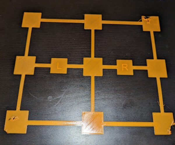

Thanks. I was using that to adjust my first layer and agree its a nice design to use.  I am now starting to think my mesh bed just isn't level.  I printed the bed level test and in the same corner (and some others) I have issues where as the middle is fine.

Thanks.  I didn't know about that mod.  So I ended up doing the nylock nut mod.  That made my bed a lot flatter but didn't fix the entire problem.  I ended up cleaning the bed with acetone which fixed some bed adhesion issues I was getting in the corners.
I will say, I do after doing this question the accuracy of the bed leveling sensors because when I was running this test in places like the back center I would have a layer that was separated and the plugin was telling me to tighten the back center which I think would make it further away from the nozzle.
I do think I am at a point where it should be functional across the entirety of the bed.
