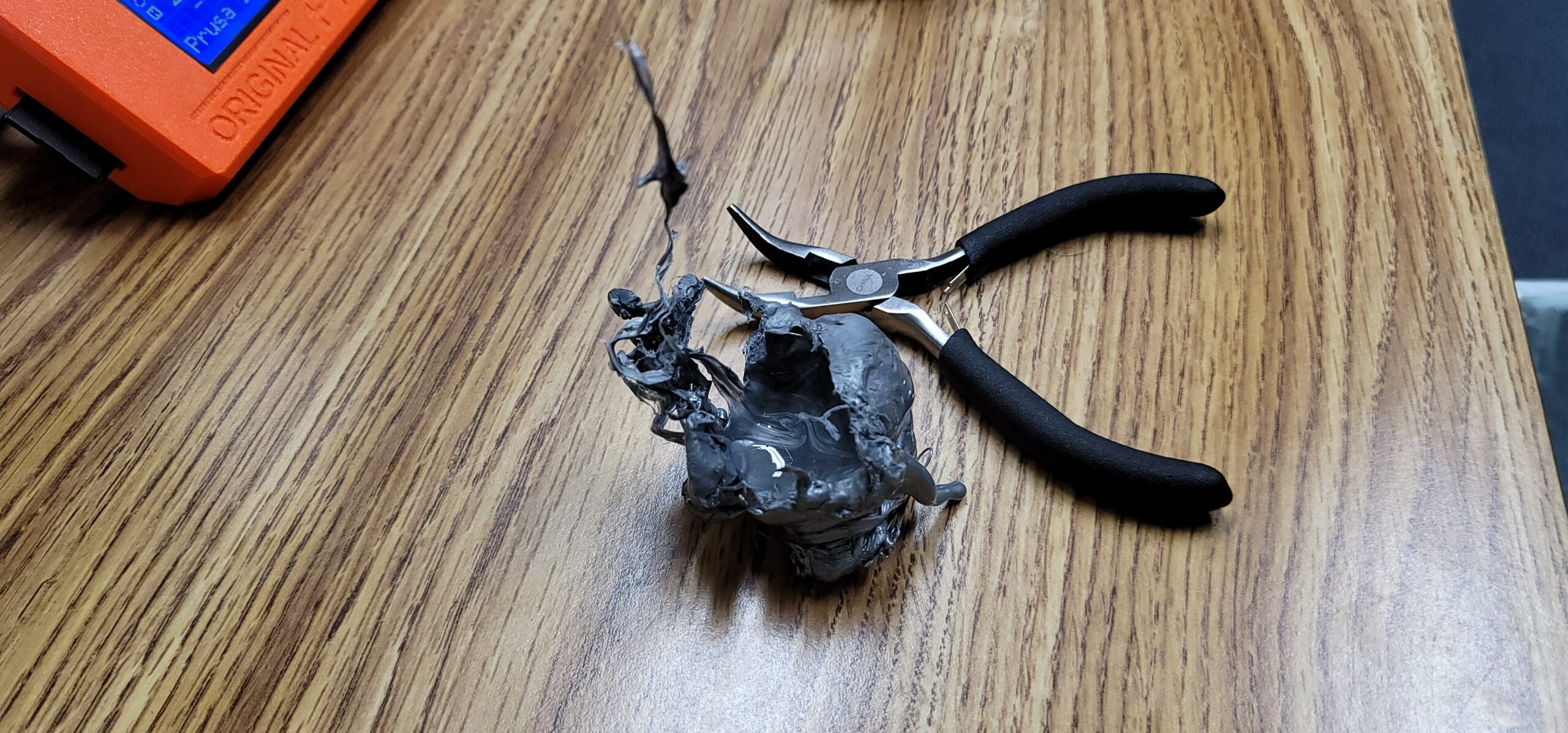

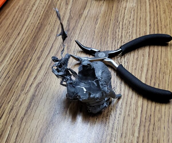

I have been printing for 6 weeks..............a newbie. But everything has been going great until today. I have a print failure and it looks so bad I do not know how to clear it without breaking something. Please help. Pictures attached/enclosed:

Just want to ad this to my post. This failure occured, my best guess, less than 30 minutes into a 6 hour print. I have done this print a half dozen times without a problem. Aside from info needed about how to clean the failure I would like to know why the failure did not show up sooner.

This usually happens due to poor first layer adhesion. Maybe this video helps you to remove the blob:
A heat gun may also be necessary for support. In any case you should work very carefully so that you do not destroy the wires of the thermistor and the heating cartridge.
Good luck!

Gerald, I hope you don't mind if I share your photo in the Blob Of Doom Gallery, which is on line here:
https://www.flickr.com/groups/14741465@N23/pool/
If you  look at the photos, you'll see that there are quite a few worse than yours.
I've only had a minor one, which I caught shortly after the print broke away from the textured sheet and I walked in to find a blob on the nozzle and the extruder dragging the remains of the print around the build plate like someone trying in vain to walk a cat on a leash.  😉
In my case, I got it good and warm, let it sit for a while, and with only some gentle persuasion the blob dropped free.
What I have done, in case I do have a more serious blob that damages some of the extruder pieces is to print spares of them in advance.  I keep them in the 'crash kit' with spare belts and other goodies that it's better to have and not need than need and not have.
As was stated, if I were you, I would simply let the thing get very warm and, CAREFULLY - a little goes a long way, use a heat gun to soften the blob and GENTLY coax it loose.   It's hard to tell from your photo, but some thermistor and/or nozzle heater wiring may be involved, so please be VERY careful when you attempt to remove the blob and don't force anything!
Posted : 06/10/2020 9:43 pm
RE: catastrophic failure
These happen because the plastic adhesion fails - the part comes loose from the print sheet and - well - here you are.
Once you get the blob off the extruder --- and as stated before be very careful with any procedures because the wires to the thermistor and heater are beyond fragile --- take some time to do a thorough cleaning of the print sheet. And watch for fingerprints and plastic residue that builds up over time and do diligence to inspect and deal with it before every print.
Posted : 07/10/2020 12:23 am
