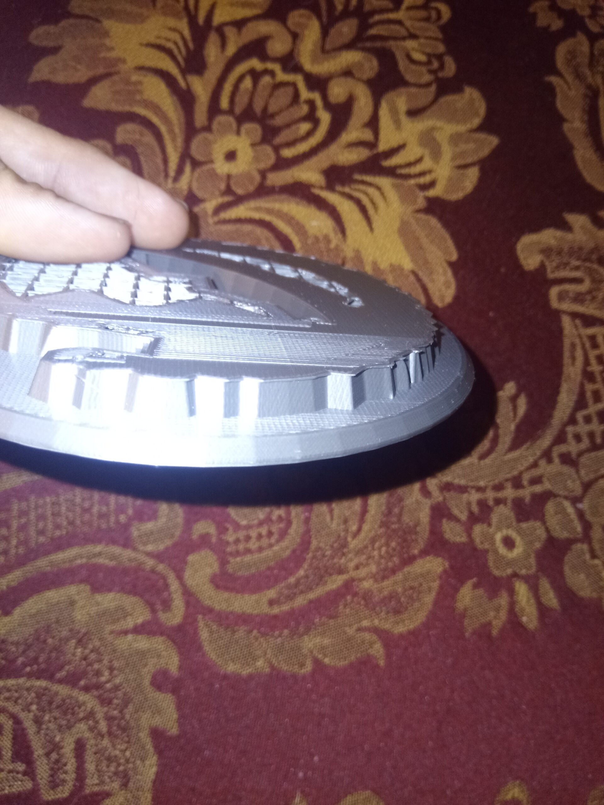

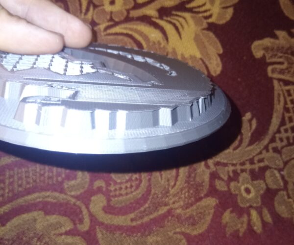

Well, a quick update, I stumbled across this image on the pruse3d website, see below. It's got the same slippage in the same layer! I don't know if this is good news or not, because you'd expect a photo on the main Prusa website to be perfect! I guess that means I don't need to worry about it unless the same fault starts cropping up in other models. I'm still curious what causes the condition of the starting layers of the first attempt though, if anyone has any ideas?

Hello this happened to me in the exact same spot because of a power outage and when resuming I got a layer shift, it happened later that night and got a layer shift on my frog too so every power out I get the shift but the odds this happened to you in the same spot are astronomical lol so weird (got uninterruptible power supply never happening again 😄) Power out layer shift
