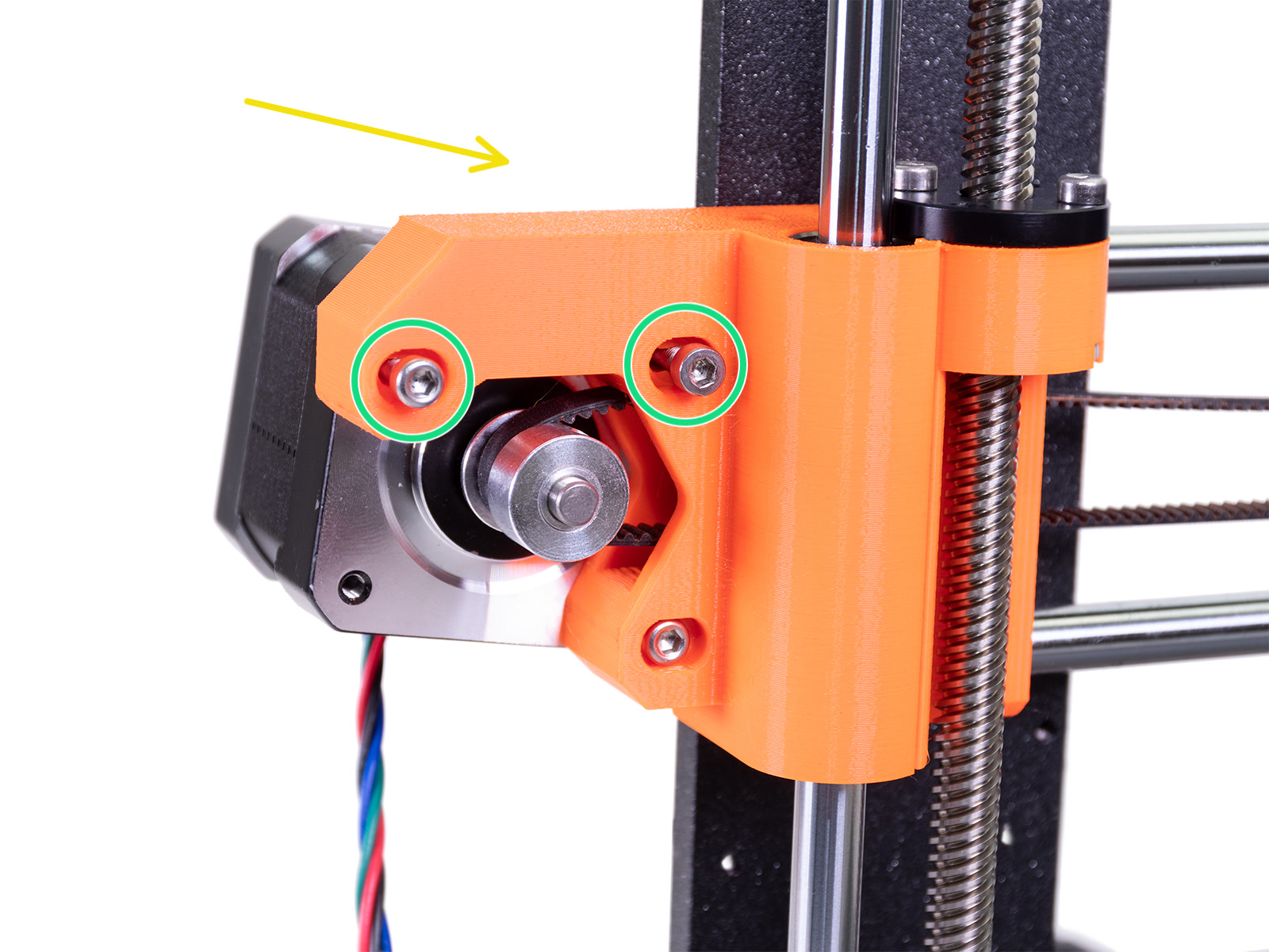

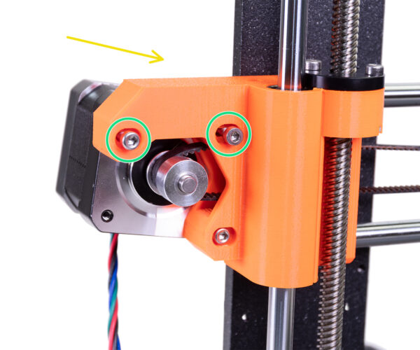

Here are some pictures of my motor and extruder. Each time I calibrate the extruder moves a different distance on the x axis. Sometimes it almost completes a full pass other times it moves half way across the axis then stops. The belt doesn't slip, like I said earlier I don't know the normal amount of resistance I should feel when moving the extruder. The print bed moves much easier than the print head.

That looks OK.
the X axis should move as easily as the Y axis.
So it sound like something is binding.
Is the idler pulley on the right, free to rotate Try loosening the retaining screw about 1 turn.  see if that loosens the motion
check that the belt is not rubbing against the X axis end pieces
try loosening the screws in the back of the X AXIS rear cover say 1 turn, see if that helps one of the bearings may not be properly seated.  If it dose not help, re tighten the screws.
If the belt is VERY Tight, try loosening it a bit.
I See lubricant on the bearings, a bit of lubricant is good, too much is bad... is it possible that there is so much lubricant in the bearings, that the balls  are having difficulty re circulating inside the housing?
Try moving the X axis side to side say 20times, then wipe the smooth rods clean, and try moving the X axis side to side again say 20 times, see if that frees up the motion. if it begins to help, clean and repeat a couple of times.
best wishes, Joan
