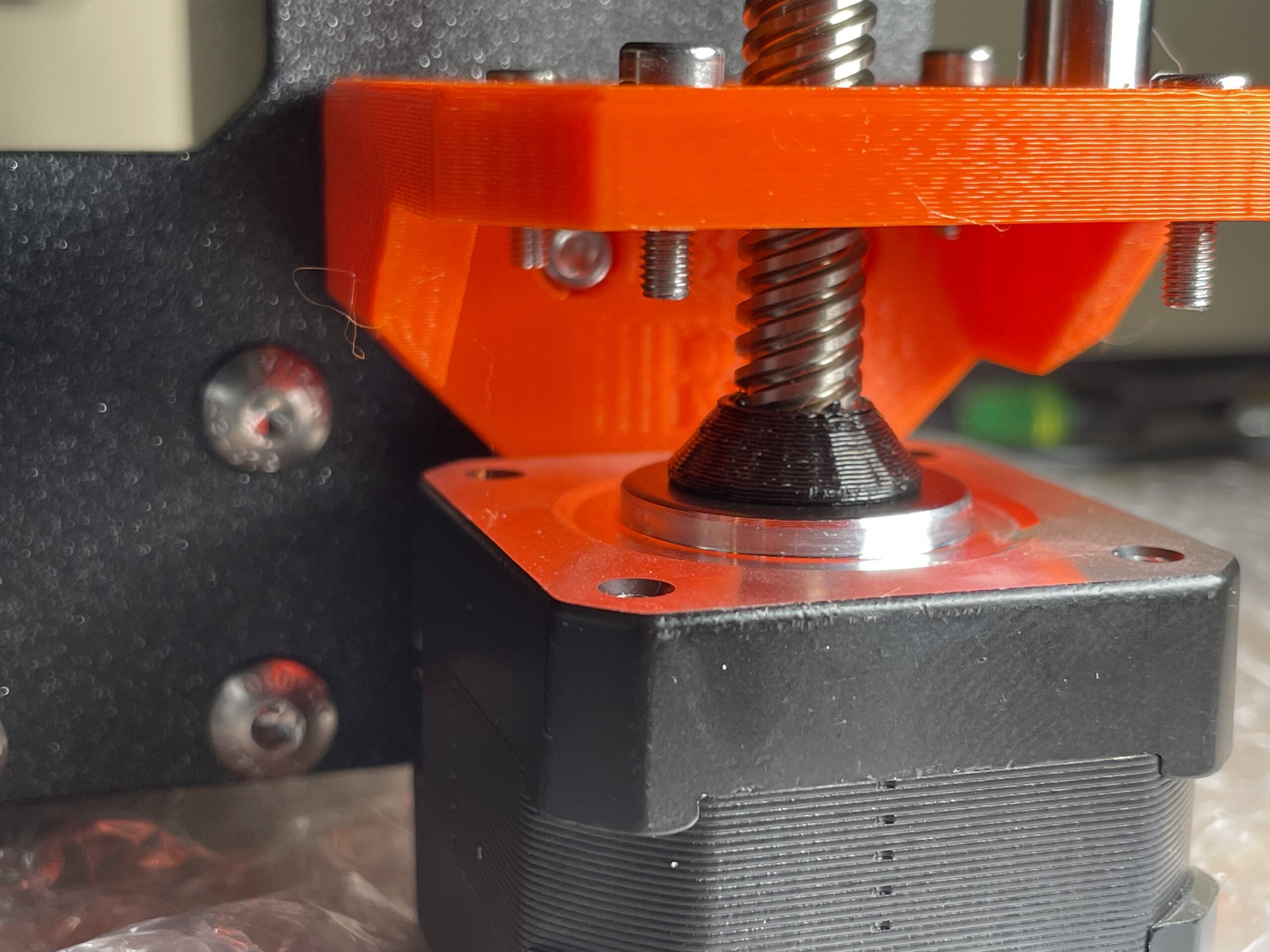

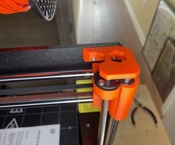

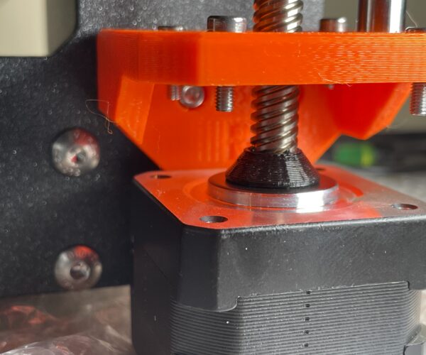

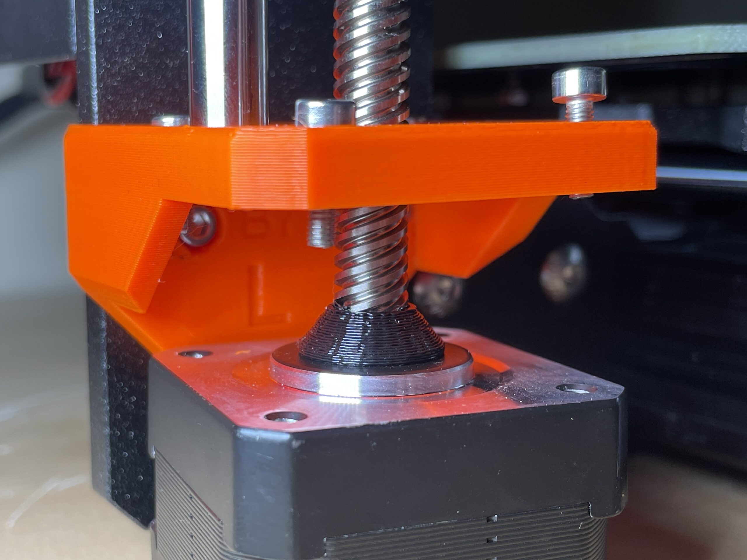

I redid the PIDNA sensor setup. I checked I can manually move both bed and extruder with 1 finger and the full range is achieved. I can go beyond the print area in the front side of the build plate, just over the white lines. Photos of the trapezoidal nut at top of the range manually are shown. The self test restarted worked fine, photo shown. The belt on both x and y motor with screw tight on flat of gear is shown.
Top trapezoid 2Top trapezoid Belt state
Posted : 27/12/2022 4:17 pm

Check whether the trapezoidal nuts at the *bottom* of the vertical axes are no too tight. The black nuts screwed on the axis, sitting flush on the motor at the bottom end of the axis. See step 3: https://help.prusa3d.com/guide/4-z-axis-assembly_168629
Manually move the extruder to the top of Z and only then start the calibration wizard.

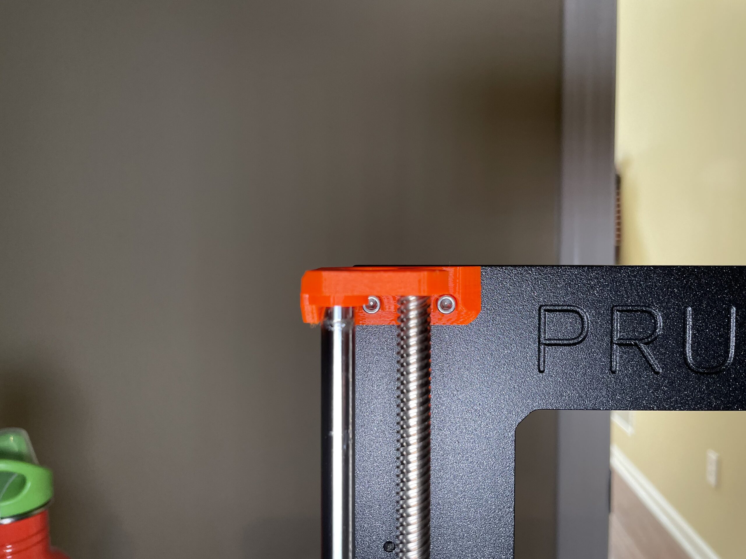

The photo of the left trapezoidal nut is suspicious. The upper top axis part is not even. Check that the axis is fully inserted both in the bottom part and in the top part.

From images 2 and 4 it looks like the Orange Z bracket on the top left is not straight. Make sure the Rod is properly inserted both ends as otherwise your entire Z axis will be out….

I have realigned and tightened the top left Z axis end stop.
I have tried starting the calibration from the bottom, the top, the center, and everything in between.

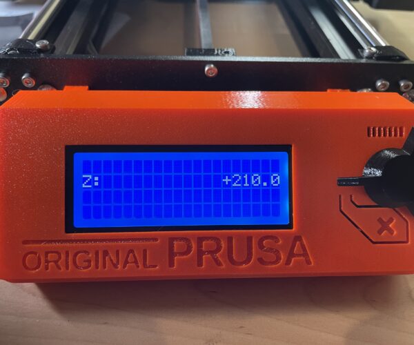

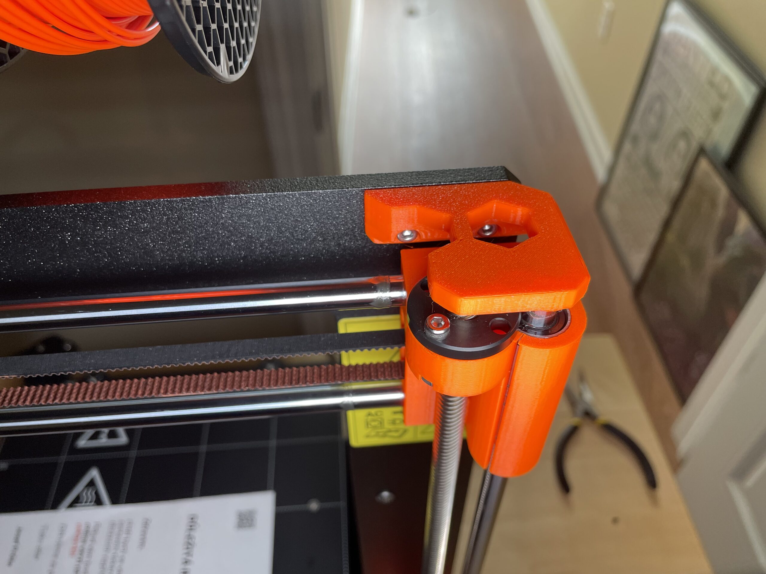

When it fails calibration the nozzle is still just a fraction above the bed and paper.  If I hold down the knob and drive the Z axis up, it maxes out at 210 but it is 2.7-3mm from the Z axis end stops. I got calipers out and measure 2.7mm my wife just grabbed a metal ruler and figures it is 3mm. The calibration failed always says it thinks it is at 5mm from the bed.  When it fails if I try to drive the motor down I can go from 5mm to 4mm and then the nozzle is just catching the paper. I have photos of manually driving to the Z end stop, and letting the calibration drive to the Z end stop they both look very similar and the plastic is flush with plastic on the x axis housing to end stop. Then I also have some photos of letting the motor drive itself up to 210mm after calibration fails and there is a slight gap as described
so what now?  I have tried the P.I.N.D.A. sensor placement and it looks identical to the photos online. Should I move it further away like higher up so it doesn’t error out as detecting the bed before the full range is achieved? Top left bracket end stop
Right side bracket at top of range in end stop from the side
Motor drove to 210mm from SW not manual after calibration failed.
After calibration fails, SW driven to 210mm leaves a gap.
Posted : 29/12/2022 9:18 pm

Z axis end stop at full range left side
Z axis end stop right side at full range
Posted : 29/12/2022 9:26 pm

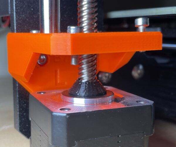

I checked the end nut on the Z axis motors. They both are flush and allow the shaft to turn.
Left side Z end nut check
Right side Z end nut check
Posted : 30/12/2022 8:24 pm
