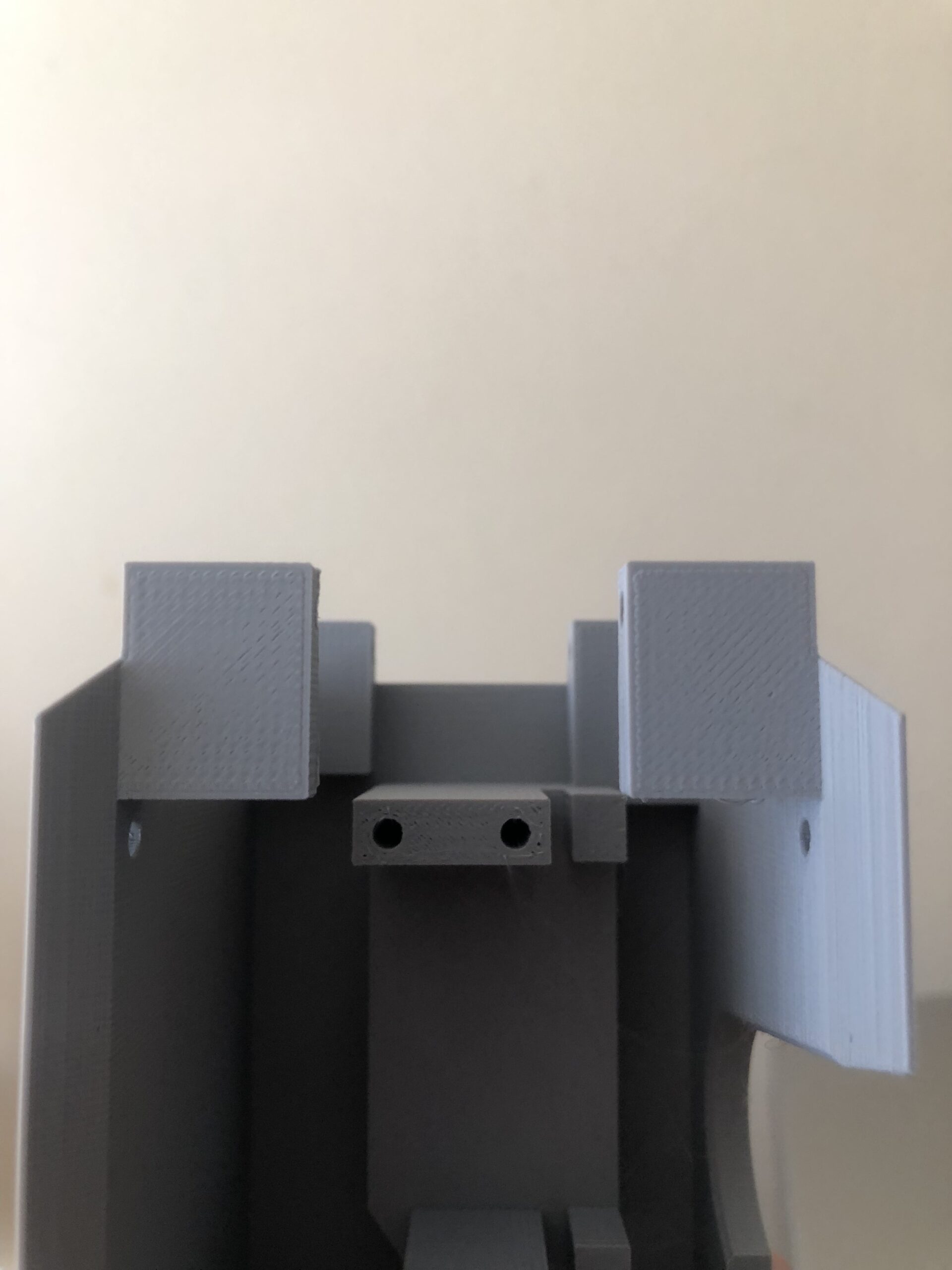

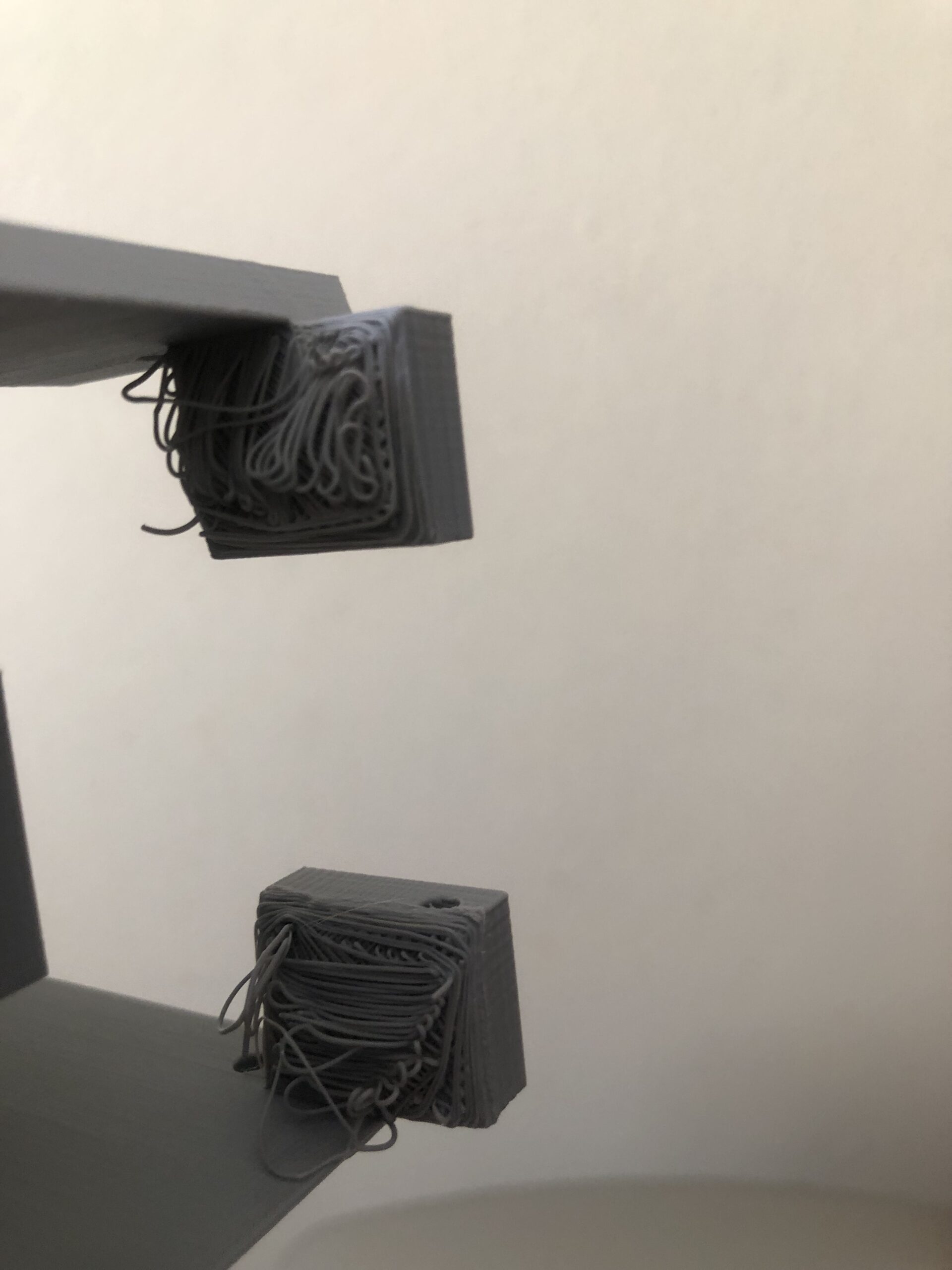

I have the prusa mk3 and I do not know how to fix the issue below. Prints fine but the undercarriage looks like spaghetti. The Pinda is level with the nozzle. Any suggestions or assistance would be much appreciated.

Slice with supports enabled.
Posted : 12/08/2024 2:43 am
Robin
(@robin)
@fabnavigator is right. I'd recommend the organic supports for that, because they will "grow" from the bed surface, the classic ones would have to be placed on a printed surface...
If you ask why this happened: The overhanging part is printed in midair, no support and nowhere to bridge. This considered your print actually came out quite good 🙂
If you attache the zipped project file, people can see what you did and make better recommendations or even do things with your model/settings.
