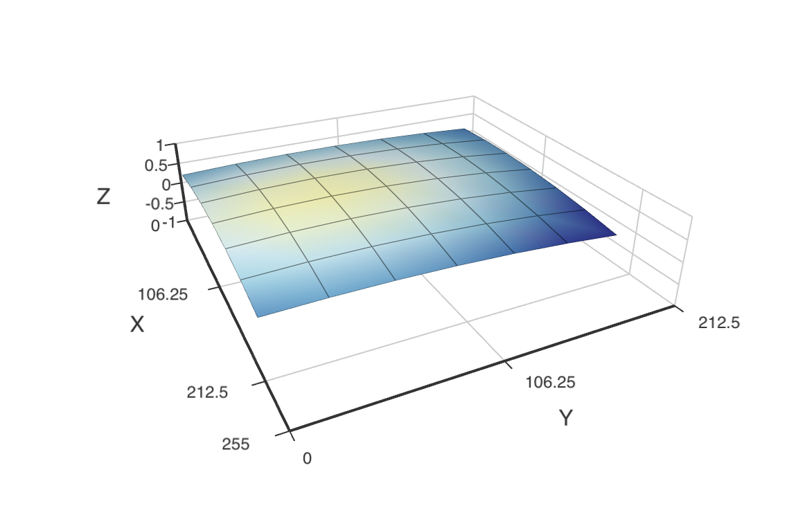

1. Second image, it is clear it is too high. First image is harder to judge.
2. The steps in the test are from 0,92 mm to 0,94 mm. That is 0,02 mm. Compared to layerheight of 0,2, this is only 10%. What is only a small range.
3. Imagine that the heatbed is not completely flat, differences of about 0,1 to 0,2 mm are a problem, but invisible for the eye (most people).
So go from here:
- If not installed yet, install octoprint and also a plugin for bed leveling.
takes some time to get it to work, but you will like the extra information.
- In octoprint use the plugin to get a nice graphical view on the level of the bed.
(my printer has a maximal variance of 0.4 mm in the bed (that is 2 layers of 0,2mm!).
If you do not want to use octoprint, there is also a method with 1st layer test, on all 4 corners and middle. (but only usefull when you are able to get at least a couple of good prints).
Do the test you did again, but use bigger steps. At least 20 um per step, so something like ,880 0,9 ,920. ,940 , 960 and further up/down.
The test you use has 9 fields so enough to test a variance of about 0,2 mm (1 layer height).
Check which row was best, and repeat the test untill you are about in the middle.

NB: Think negative numbers here. So 0,94 is the deepest position, being -0,94 (so downwards, not higher).
- You have a nice flat heatbed. The question then is, how come that in last picture at same level .928 it looks very different?
What caused the difference? One option could be position on the heatbed (if not leveled well enough). You showed it is not the cause.
Are there other differences what explain this?
