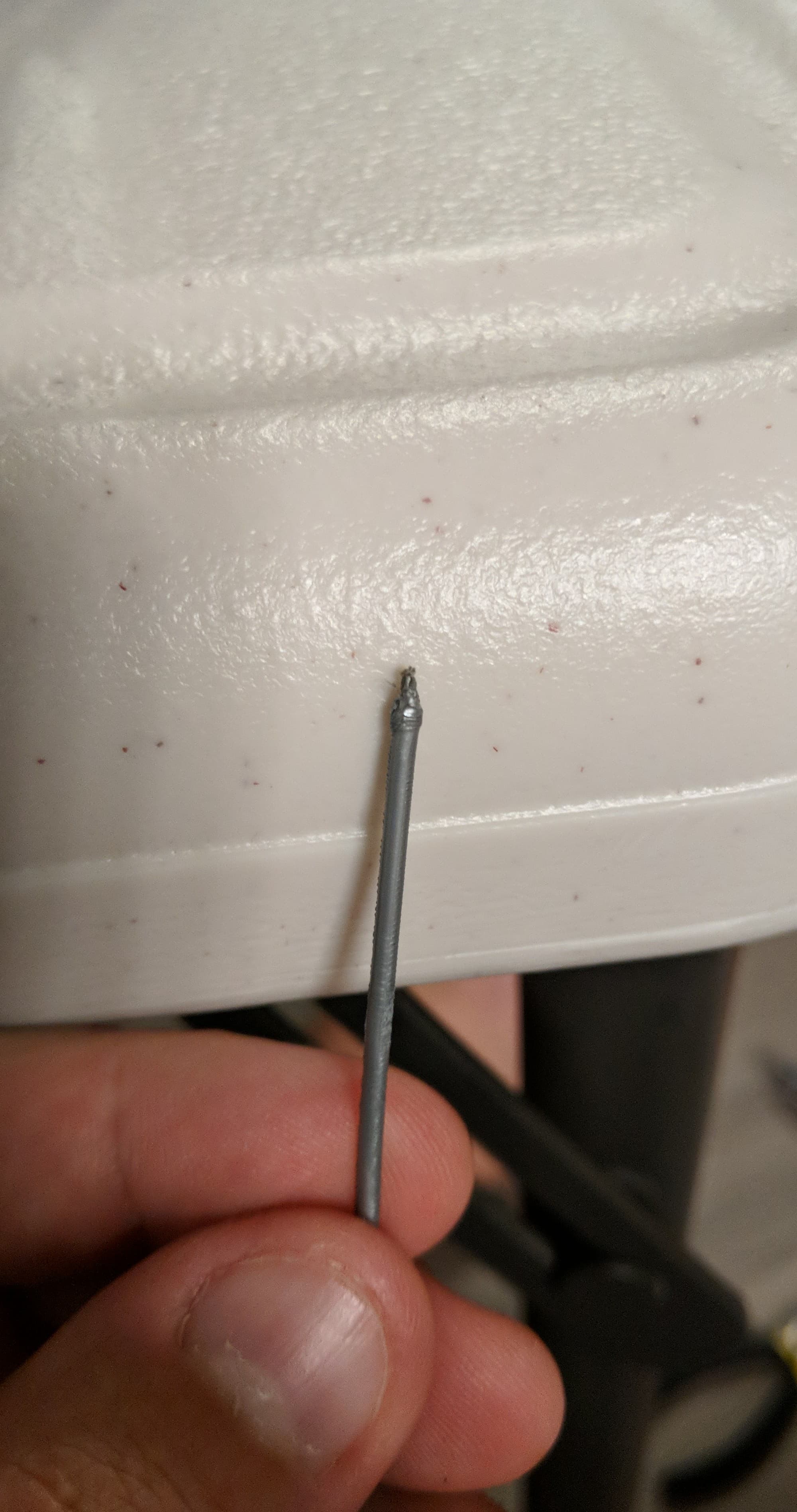

Hello All,
I'm able to print just fine with a .4 brass nozzle with my setup. However when I try and print with my .25 brass nozzle, it gets about an hour into the print and forms a small blob of plastic right after the tube but before the nozzle. The only way to remove it is to disassemble the extruder and pull out the plastic tube to remove the filament. This has happened multiple times, and I haven't had a successful print yet with my .25 Nozzle. I have changed my splicer setting as well as the setting on the printer. I don't know if I'm feeding too fast into the nozzle or if there could be another issue. If anyone has experienced this I would greatly appreciate the help. This is what I get when I take my assembly apart.
Thank you in advance

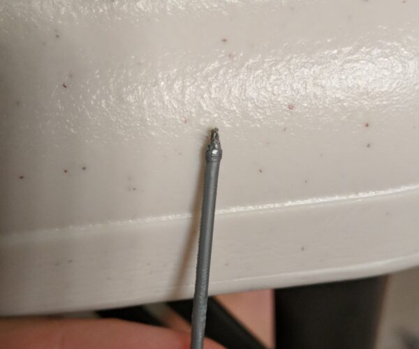

@joantabb Thank you for the quick reply.
I attached the picture I used at the start of the post (this is from the first time I had the problem). The other photo is before I remove the filament from the whole setup.
I am using the Prusa Preset for the 0.25mm nozzles, as well as changing the 'HW Setup' and changed the value for the Nozzle to 0.25mm. I have also tried to Reduce the retractions to 0.2mm with no success. I have also tried to slow down the print speed from 30mm/s to 20mm/s.

the photo shows the filament not the model, or the printer,  the model configuration might help us understand what the issue is.
someimes a picture of the printer can identify an issue...
