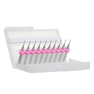

I recently had a jam that needed to be cleared. I did the atomic method but it still did not help with flow issues. I have a really small drill bit that is made for 3D nozzles. I used the bit to clear the jam and it worked. I did not use the bit on a power tool, i just turned the bit by hand. I could feel the bit catching old filament.

Thank you for your reply - i already did this, my extruder is very clean.
