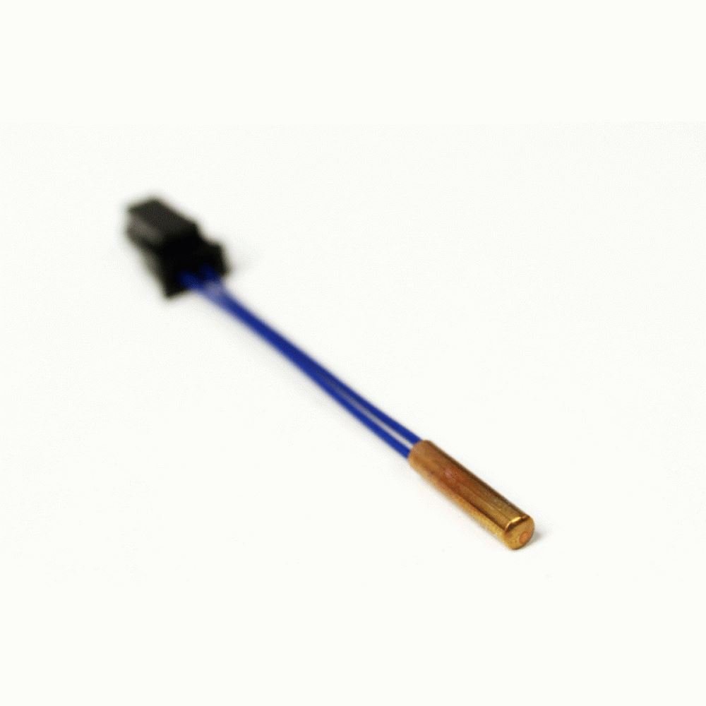

After replacing my hotend and having the z carriage apart everything is back together and a selftest completes. When I try to do a calibration it sits at "waiting on nozzle and bed cooling" i let it sit for 8h with no change. Any thoughts are appreciated.

What are the temperature readings while waiting for it to cool down (which it obviously does not)?

73/0° and 20/0°

So it seems one of both temp sensors is misreading and the board always "thinking" the temperature is too high.
Check on which of those it is and than check the wiring of it. (be sure you did not mix up the connectors!)
It is well known that those cables could get weak with the time (the only downside of this printer if there is any)
which leads to failures or misreadings which I had to experience myself eventually.
Wiggle those cables back and forth and check on the display for sudden temp changes.
The damage most probably will be somewhere where the cables are bent the most while the bed or extruder are moving.
Repairing with solder and heat-shrink tube is no big deal at all.

Both sensors are responding properly [used a heat gun to test and wiggled all the wires] are there standard resistance readings for the thermister and for the heater so I can check that?

I pulled the harness apart again and went through all the wires finally found a bit of damage to the nozzle temp sensor right inside the head itself just like alexander.s27 suggested (thanks again) it was to close to the sensor tip so i swapped in a cartridge style unit from another e3d hotend. I jury rigged wiring it up for a test run and everything worked and a cal. completed do you guys think i should clip the connector off the cartridge temp sensor and solder it in or should i look to find a connector and make the system easier to part out? I lean to connectors but then I have to find the proper mate to what I have.
