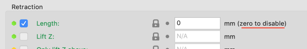

arkatcrime
(@arkatcrime)
RE: Print with TPU Flex
@joantabb
I have a doubt.  Your retraction is 0mm (Zero), but  zero you don't disable retraction?
