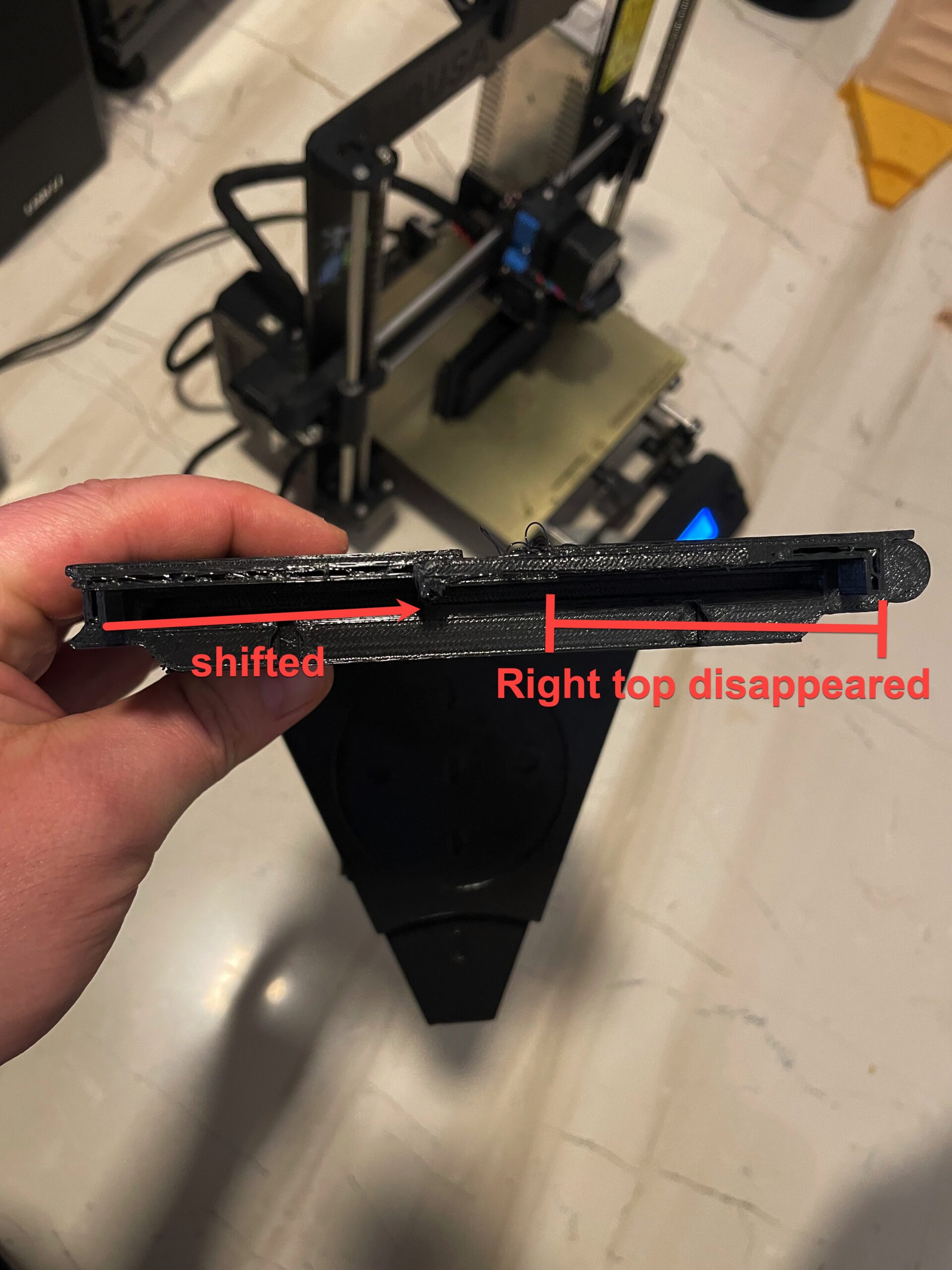

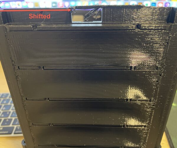

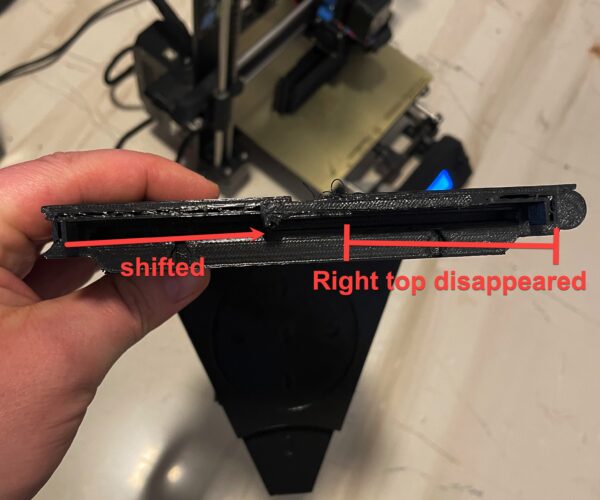

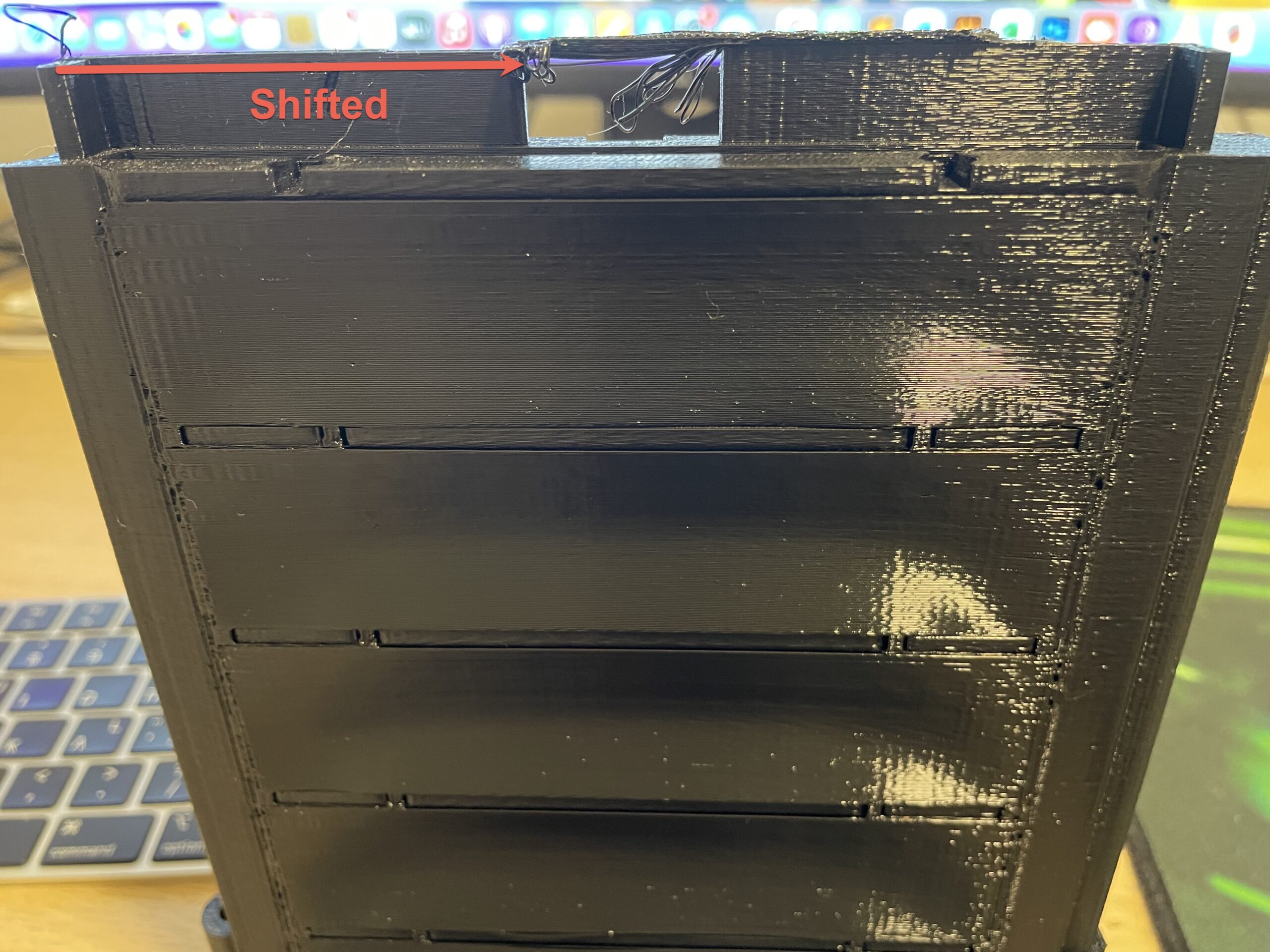

Hello!
I just printed this tower like design and got this weird finish at the very end, slightly below that everything looks fine,
it looks like the whole top left part shifted 5.5cm and ended up in the middle of the print, possibly the reason why the right part was not printed? so weird!
it was printed with a MK2.5s+/PLA/.20mm 100mms Linear advance and the bad part is right above 19.7cm
the rest of the print looks fine
any suggestions what could cause this?
the stl
Thank you!

It turns out the extruder was crashing on the base of my spool holder, attached to the top of the printer, it has never happened to me before because I never printed something this tall, any suggestions for a good spool holder?
thank you
