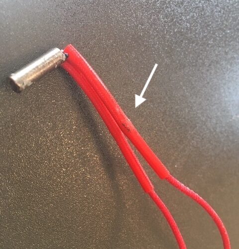

I also had thermal runaway shutdown occur after the 2S > 2.5S upgrade.
It seemed to shutdown shortly after the parts cooling fan starts.
Replacing the fan shroud with a different type seemed to help, and installing an E3D hotend sock seemed to cure it... for about a week.
Then yesterday the single beep signaled the shutdown on a PETG print and a restart failed to warm up!
A check of the heater resistance at the MiniRAMBO connector indicated 200 ohms or so. Shouldn't it be only a couple of ohms?
So, out with the original 40w E3D heater and in with my spare E3D 40w heater and the printer now works correctly even with no sock. When the parts fan starts up, the hotend initially cools down about 5º then quickly recovers. So, I'm back to 3D printing!
A recheck of the failed heater indicated 20 ohms. Huh? An order of magnitude lower by just removing the heater? Looking at it carefully revealed a burn spot in the red wiring sleeve, about 25mm away from where the wires enter the heater cartridge. Apparently the spot is molten PETG from the bottom of the X carriage.
As the high temperature sleeve is not heat shrunk, it pulls back away from the heater revealing a long brass crimping sleeve with a poorly executed crimp! The other wire has a nicely formed crimp. Wiggling the wires around at the crimp brought the resistance down to 4.7 ohms, apparently by temporarily cleaning the remaining contact area inside of the poorly formed and overheated crimp.
Apparently, removing and installing the hotend during the 2S > 2.5S upgrade loosened the crimp, causing high resistance, which in turn overheated the crimp and burned the sleeving while reducing the power available to the heater element, leading to thermal runaway... it was not the fan shroud after all!
So, if one has a thermal runaway on a PRUSA, it is probably a good idea to check the resistance of the heater element. Cold, on a 40w 12v heater, it should be around 3.6 ohms, on a 40w 24v heater, about 14.4 ohms. If warm, the resistance will be higher.
To do this, get or borrow an ohmmeter, unplug the hotend heater at the MiniRAMBO, and check resistance at the connector plug. After checking the resistance, tighten the little pinch screws in the connector plug and re-check. Also, inspect the connector plug and socket on the MiniRAMBO for signs of overheating.
