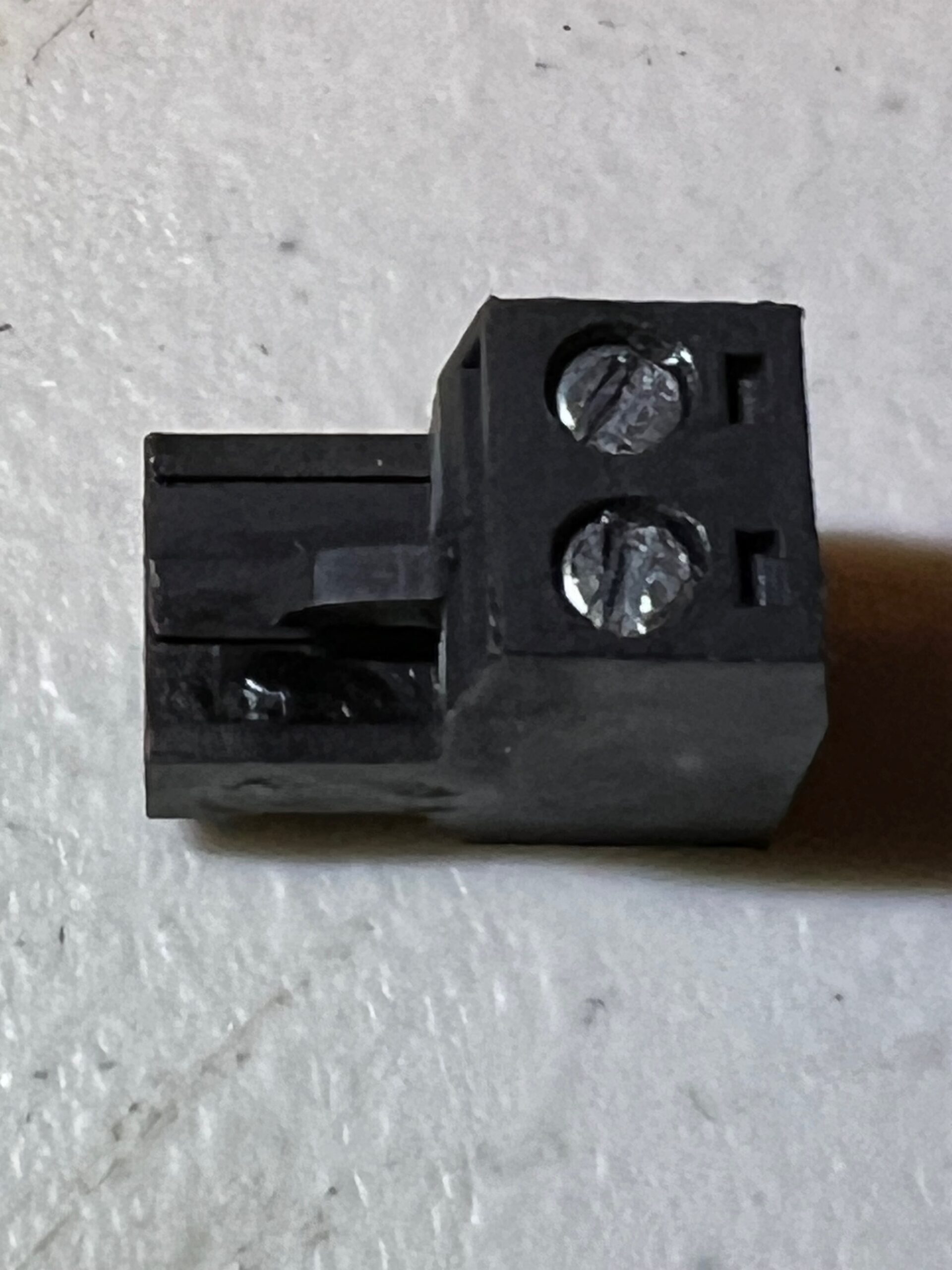

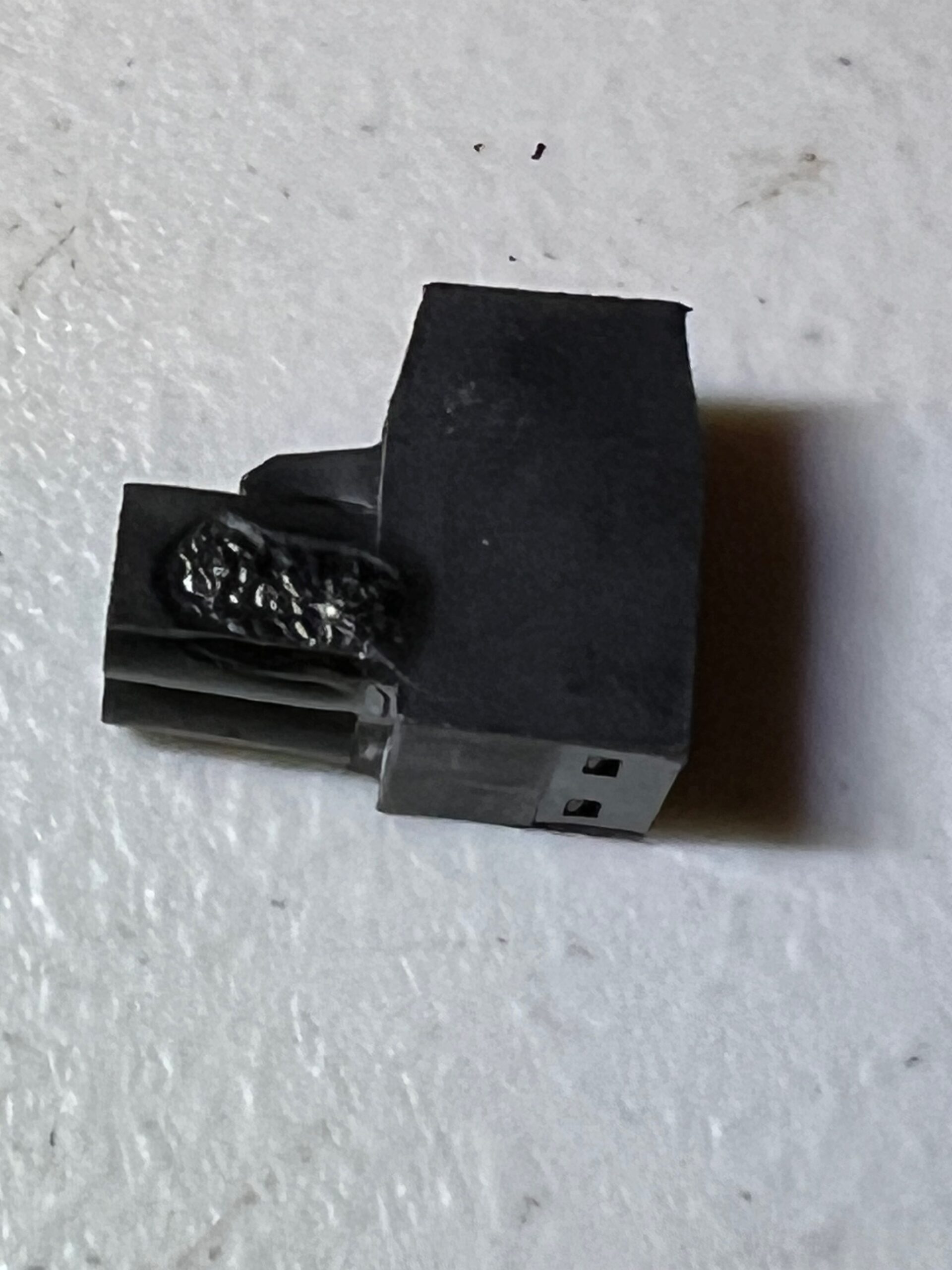

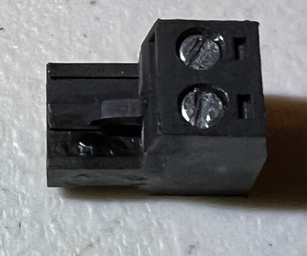

Tuesday I received the new Rambo board and began the disassembly to take out the old and install the new.  It was then I made a discovery that I hadn't seen before.  The Molex connector that supplied power to the bed side of the Rambo board had some blemishes on it.
This sucker had gotten hot, in fact the heat shrink tubing on the wire that entered that side of the Molex had burned completely away.  I checked the connector with my multi meter and it had complete continuity, in fact I could plug it into the board and read voltage on both incoming pins by reading the solder pads on the back of the board.  They seemed to be making good contact, still if enough heat had been generated to melt the case of the Molex there was no way I was going to trust it.  I ordered some new ones from Amazon.  I chose Amazon as I'm a prime member and could get them in 24 hours, I really didn't want to wait another 5 days and pay shipping from the Czech Republic.

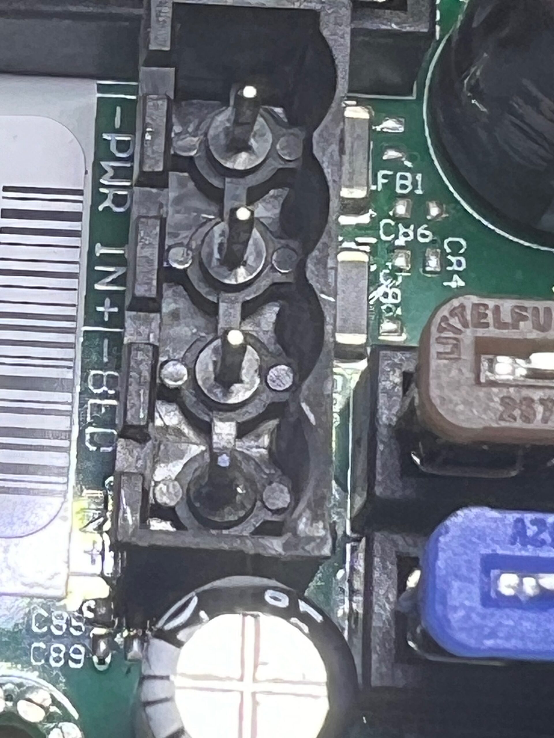

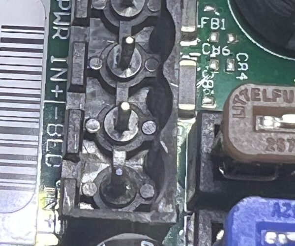

After installing the new Molex connector and mounting the new Rambo board in the case I took a look at the old board and noticed this:
The bottom pin that corresponded to the melty Molex was looking a little toasted.  It wasn't melted and the solder joint through the board looks fine so I don't actually know if my problem is in the board itself or if my problem was simply a connector failure.  Either way since I had the new board I replaced it.  Also, since the Molex connector didn't come from Prusa and may not be the exact same quality as what Prusa sells, instead of using the new Molex on the heat bed I used it on the connector for board power and am using the Prusa provided connector for the heat bed.  I think it's safe to say the board will draw much less power than the bed.

These Molex connectors need to be checked regularly, especially the tightening of the screws on the terminal block. This applies to all these connectors, not only here, but also on the supply from the power supply and the outlet on the extruder. Most of the faults on the MiniRambo board come from these connectors. After carefully cleaning the faulty pins on the old board, it might work too.

When assembling my Mk3s+ I noticed they no longer used the Molex connectors so it seems clear to me they went with lugs for a reason.  I think you're right that cleaning the pin may restore my old board to service.  Not sure how or when I'd get around to testing that. I don't know if a display is necessary or if I could just plug it into Octoprint and issue commands from there.
In any case, the printer is fully functional again, except for the led on the heated bed, it works when the bed is cold but not when the bed warms up.  Must be a broken solder joint, I may look into it, but I have no experience soldering SMDs and that led is small.
