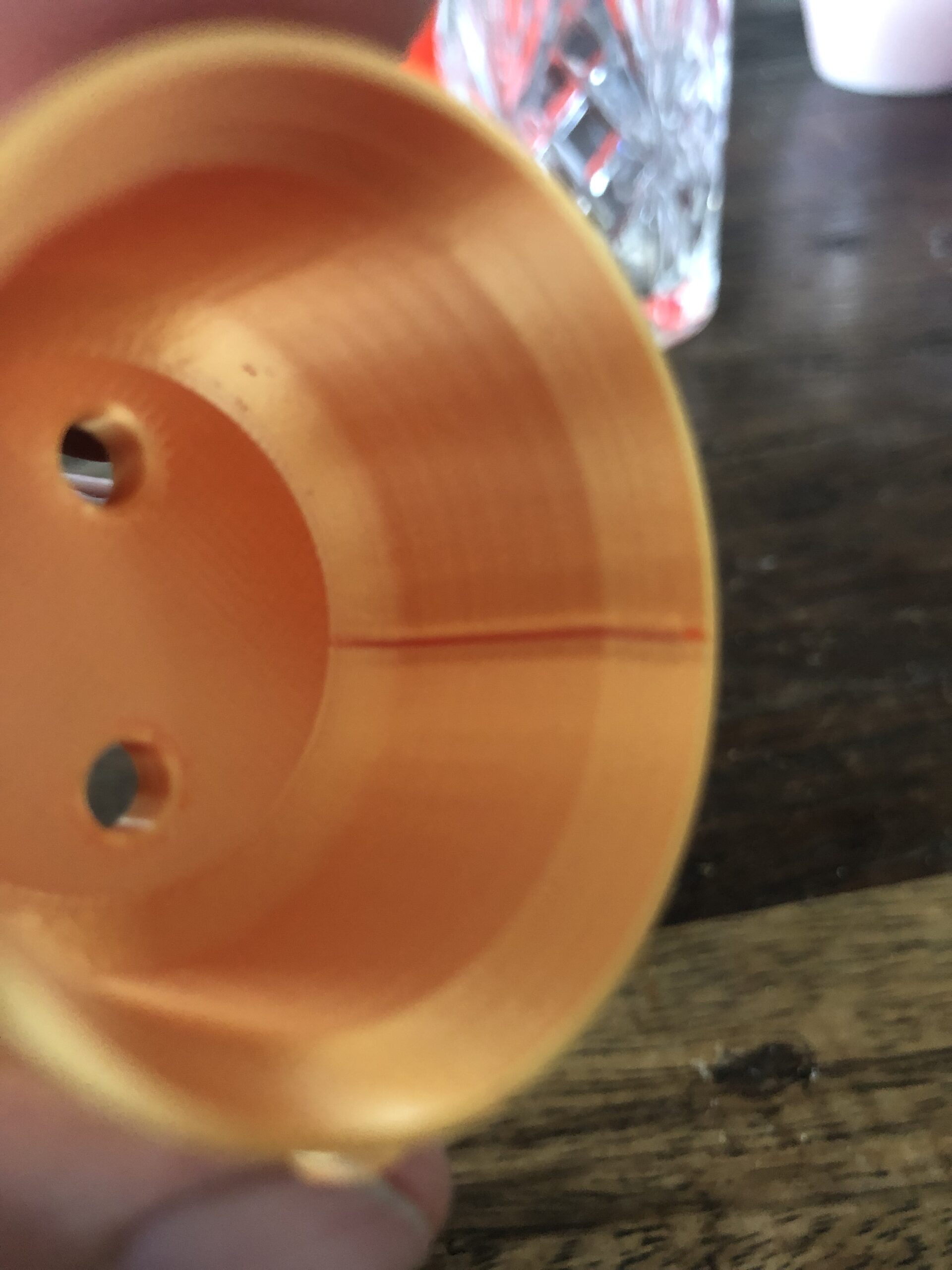

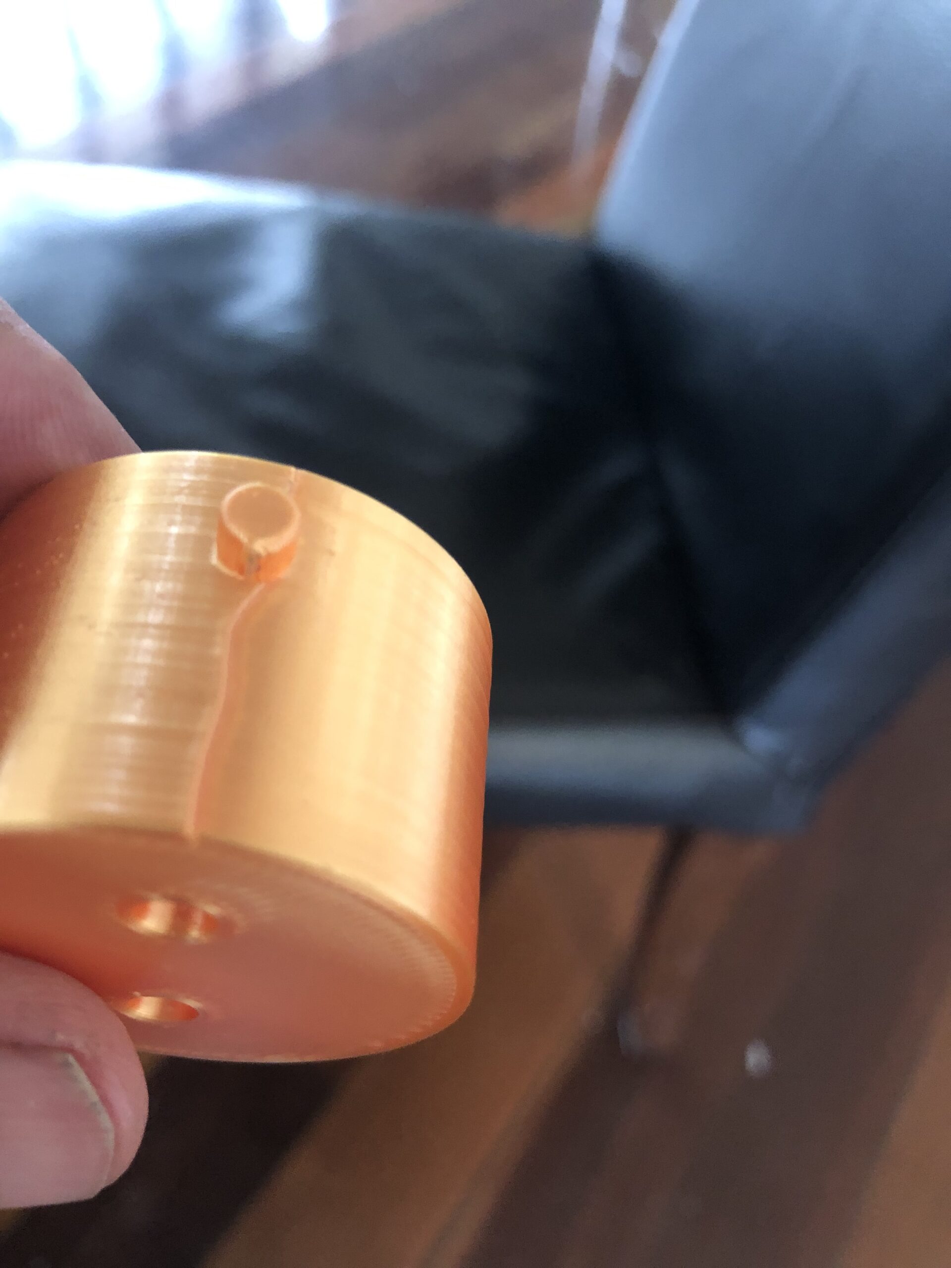

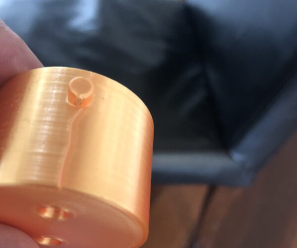

Crack appearance on inner and outer layer different areas
Earthmove1
(@earthmove1)
Posted : 28/10/2023 12:59 am
You can direct the seam by painting the desired position (button on left in plater) or change its type and position in:
Print Settings > Layers and perimeters > Advanced > Seam position
  - you will need to be in advanced mode.
Posted : 28/10/2023 4:19 pm
Earthmove1
(@earthmove1)
RE: Crack appearance on inner and outer layer different areas
Thank you for your prompt reply, will try your method on next print
cheers
Posted : 28/10/2023 7:50 pm
