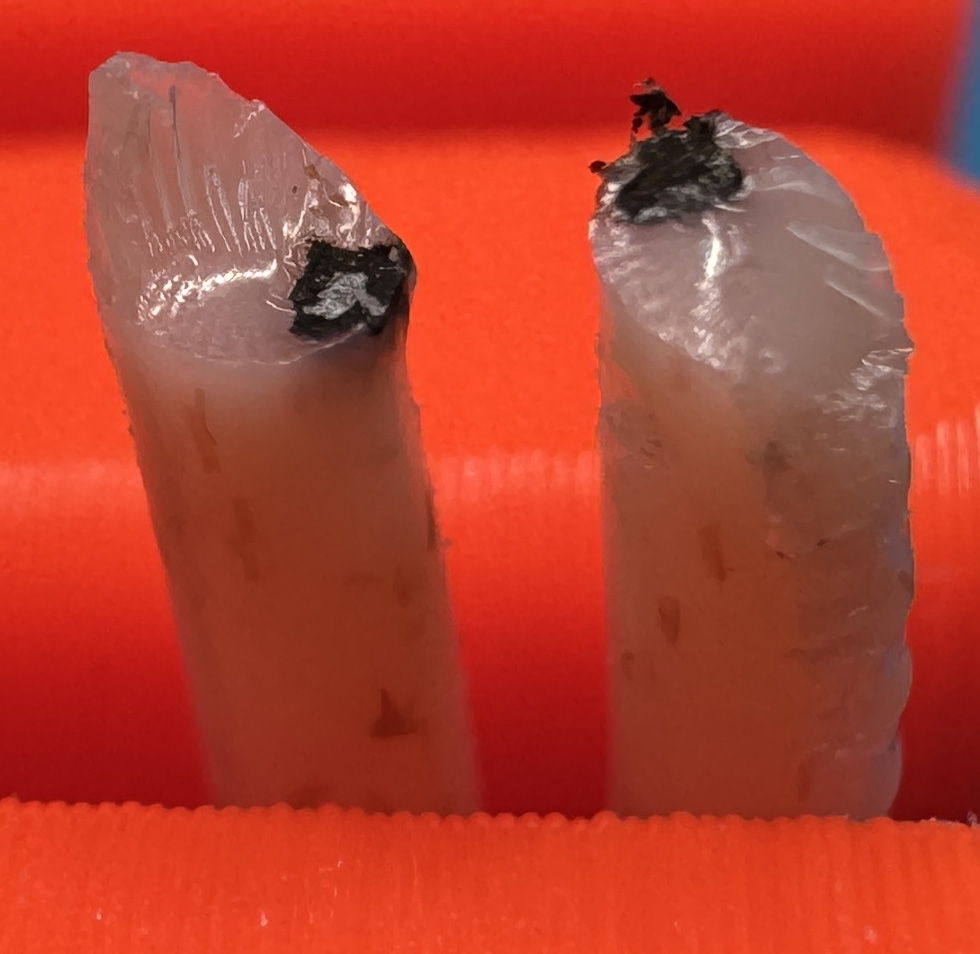

Seams like the filament (PETG) I am using gets randomly broken by the nextruder. My print was broken already twice. Worst is that filament sensor doesn't get it and print continues... without filament. So no way the print can be restarted.

What kind of filament?  Where does it break?  Is it looping and getting tight or something.

Maybe the filament needs to be dried. This might even happen with new filament, not only with filament that has been left out in the open for a while.

It looks like it was really the filament. Not even that it was not dry, it simply must have been faulty. Tried with yet another color, same producer, same petg type and there was no issues…

RE: Nextruder breaks the filament
I had the same problem with one PETG roll, there was a material defect. The filament has a black material inclusion and broke in the Nextruder. That's why the Prusa XL couldn't know that no more filament was being fed, because there was still filament in the filament sensor. Attached are a few photos of the  filament problem.I have send the pictures to the manufacter and get one new, errorfree roll from him. Nice support!
