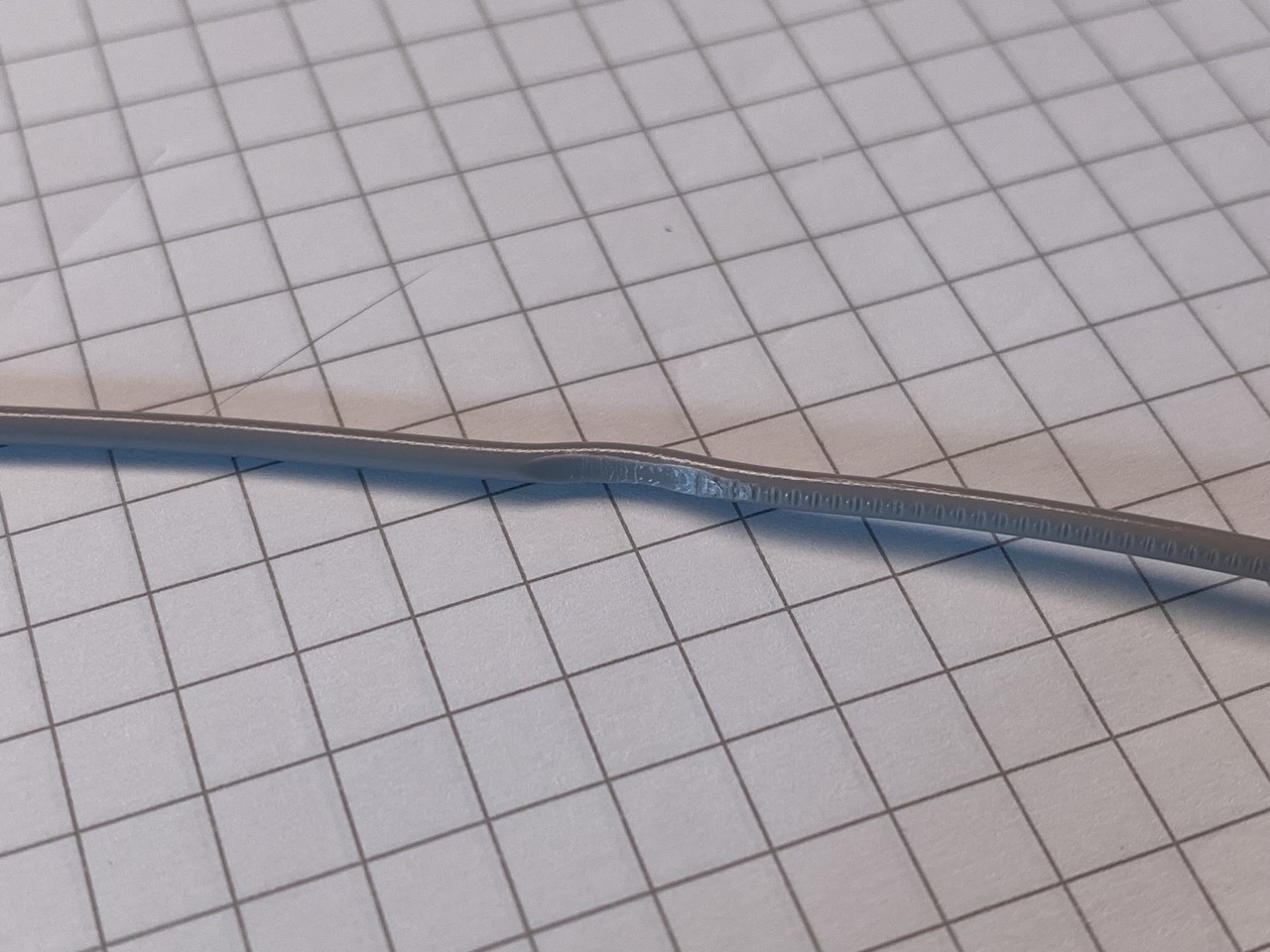

After having the last print without any filament sensor issue in the front area of the print bed, I used "repeat last print" on the XL menu and the filament sensor triggered again at that front area. After I finished the filament change process the print appreas broken (that's why I always had to cancel the print before), but looking more closely what the XL does (see pictures), I guess it continues the print at a higher layer not having proper contact to the top layer. It probably  printed a while without recognising that there is no filament flow anymore, before triggering the sensor. That might be supported by the look of the filament I took out when the sensor triggered. Makes sense? I did now increase the pressure on the extruder springs a bit.
Filament I took out when the sensor triggered.
Successful print without issues After filament change process the print continues maybe at the higher level as the is now contact anymore. Signs of under extrusion on the last row objects

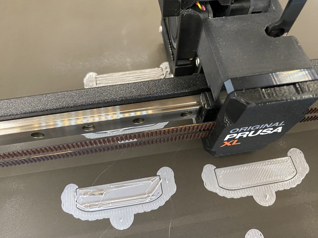

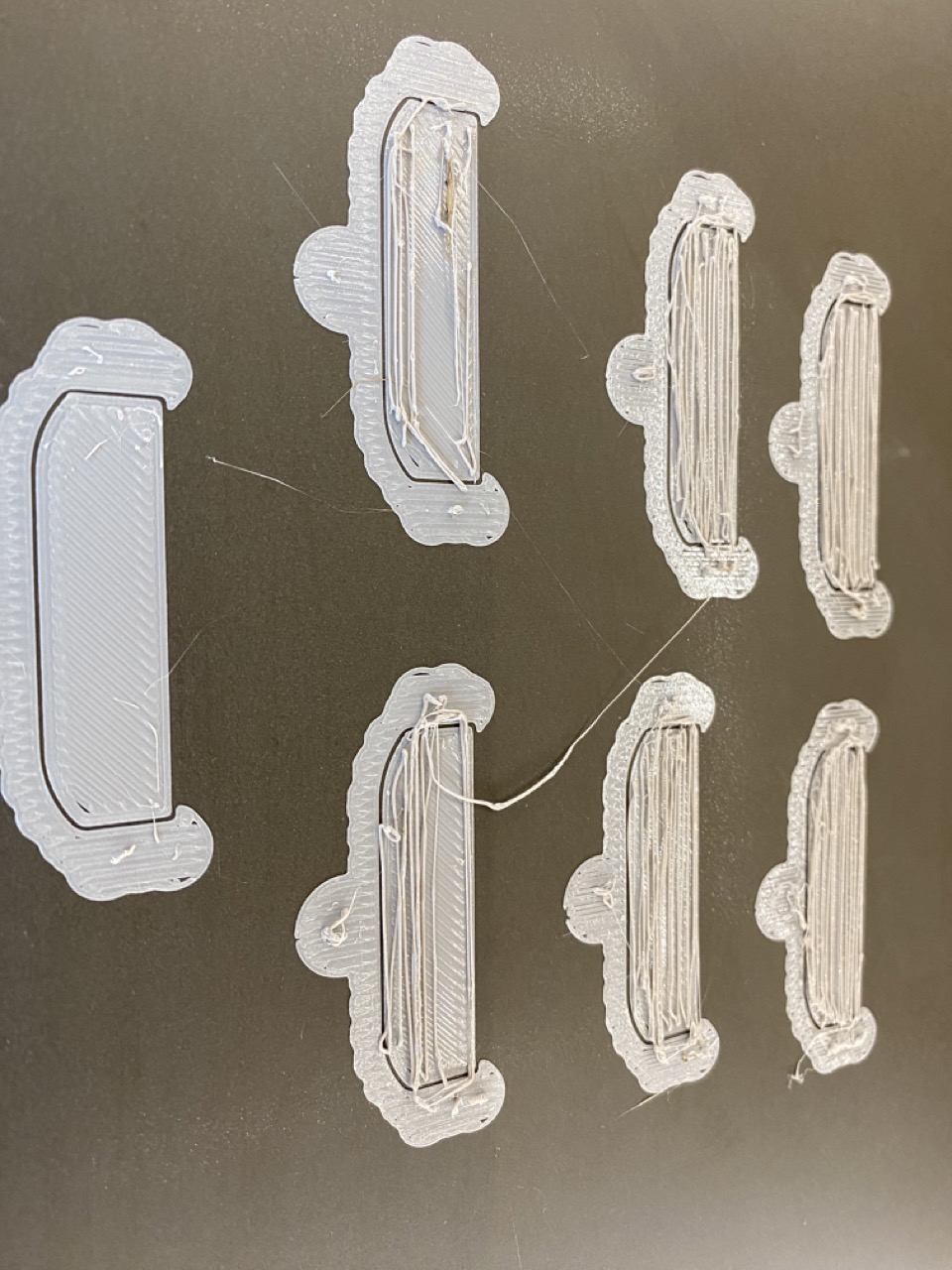

Some more pics. The second pic shows again some under extrusion in the support area of the objects in the rear rows.

The filament shouldn't be squished so much by the extruder gear. On first glance it looks as if your spring pressure is wayyy too high. Not an XL owner yet, but that doesn't look healty.
If that is not the case, can you somehow check if the extruder gear gets hot? I'm not sure if it can happen with the Nextruder, but if something is wrong with your hotend cooling (e.g. fan mounted backwards or airflow obstructed), or if your extruder motor runs too hot, on some printers this becomes an issue.
Another thing I would check is if one of the gears slips. It's one of the most common reasons for random extrusion issues, and progressively gets worse until fixed.

I agree, it shouldn't look like this. The odd thing is that it only looks like this, when the filament sensor has incorrect triggered. Normally the filament looks OK like on the pic. But could not yet find the real reason for it and it's still happening to me from time to time, but only with the 0,6 nozzle. I printed a lot of pieces in Prusament PETG carbon fibre and the hardened 0.4 nozzle (with adaptor), not happened a single time. BTW, the quality is much better compared to Prusament PETG and the 0.6 nozzle. I always used to presets which came with the PrusaSlicer. See the comparison on the pics (Pic 3 Prusament PETG CF with 0.4 nozzle and Pic 4 Pusament PETG with 0.6 nozzle; key caps are always printed with the SL1). I got a lot of artefacts on surfaces with the 0.6 nozzle and also realised measurements are not 100% accurate, e.g. holes are 0.1 - 0.2 mm to tide in direct comparison to the 0.4 nozzle.
I checked the fans, they work both. The are also no blockings as far as I can see. For the temperature of the extruder gear I can't say, but will measure it when it happened next time. (Will be a challenge, because I usually realise the false triggering when the nozzle heating as been switched off already for long time.) But, seeing the facts a hot extruder gear sounds like a valid reason. Still not sure why the sensor triggers though. BTW, I also found one day a tiny grub screw on the print bed. I know there is another post on this, but my 3 screws in the heat-block are all in. So currently I have no clue were this came from.
Keep you posted.
Normal look of PETG from Nextruder

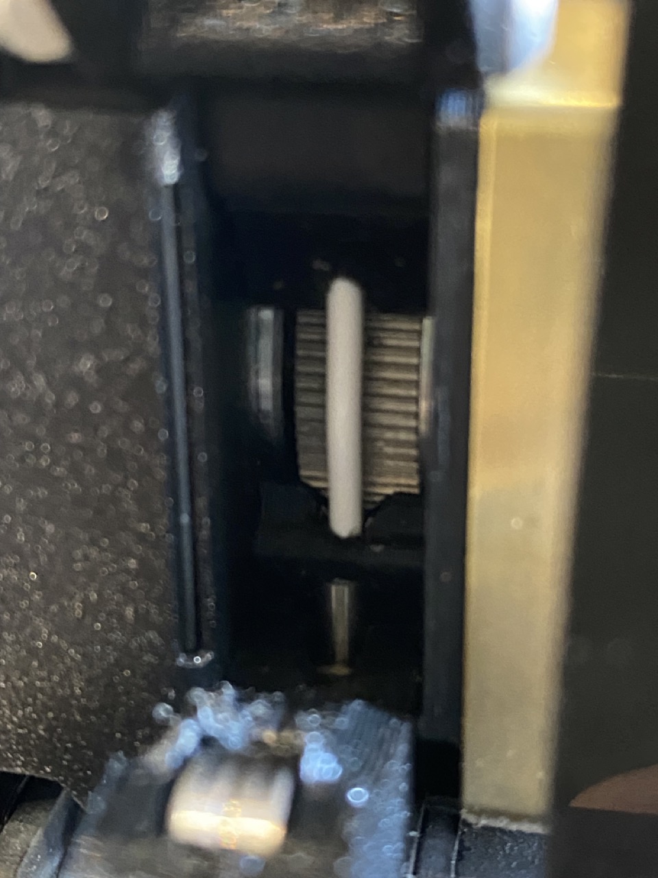

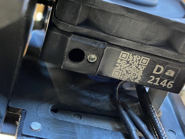

Uh, oh. If that is the one fixing the main gear to the motor you might have your culprit. I don't know how this looks exactly, but the motor axle will have a flat side for sure. If the gear keys in to that it would still work without the grub screw, but will wobble to the side under pressure because it needs clearance to be pushed on. Just guessing though. From your filament picture I cannot really tell if the material was compressed or eaten away by the gear.
It really sounds like the 0.6 builds up too much pressure while the 0.4 doesn't. Temperature a bit too low for 0.6? It could also be down to a broken nozzle (maybe a manufacturing defect). How does it look when you remove the filament & shine a light through it?
Edit: A simple thing you can do without fiddling around is measure the grub screw and ask chat where it belongs.

Thank you for the hints. The grub screw topic is resolved! I found it and the tech support in the chat confirmed it. It was for the heatsink thermistor and sits on the bottom next to the hole for the nozzle. (You can only see it if the nozzle it out.) So maybe the other issues are related to it, because of incorrect temperature sensing of the heatsink. I also ordered some other 0.4 Nextruder nozzle for some more tests. Keep you posted.

Assuming the fan speed is controlled by the heatsink temperature reading, it's actually possible this resolves your problem. Filament gets sticky if the heatsink gets too hot, which increases resistance gradually. It would explain why 0.4 works better, because filament is fed more slowly. Fingers crossed!

Thank you and yes I guess it did the trick. Made two long running test prints (2 times 9 hours) and not a single false filament sensor triggering 😅. Also the print quality with the 0.6 nozzle is normal again after the clamp "totally running out of shape" disaster from 2 days ago as you can see in the pictures. Just look at the edge. What to say other than "small thing, but big impact" 😃. Building up XL experience 👍

Thanks, that is good to know. I hope PR does something about these grub screws, there seem to be quite a few cases on the forum where one went missing. If you hadn't found yours it would have been very hard to narrow down. Happy printing 🥂

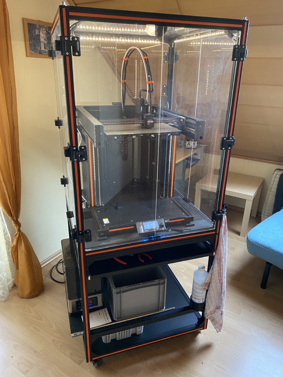

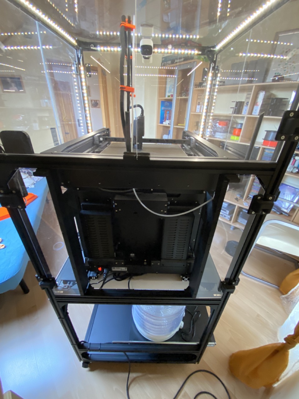

BTW, also designed and build the enclosure for the XL myself incl. additional light and camera. Kept the back of the printer with the power supplies outside for better cooling.
