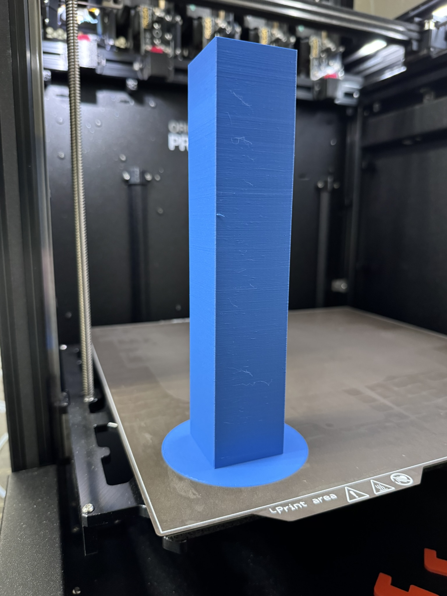

prusa xl noise
Is this what we are talking about here? I am on 6.4.0 and recently built the enclosure and did the pc-cf upgrades to the nextruders.  I decided to also do the upgrades to the cable connections during that upgrade using ASA and the noise coming from the printer during moves is insane.  I thought it was just the new covers rattling so I removed them to test and tightened them mroe. It did go away some but not completely.
I have followed belt tightening guides from Prusa as well as https://investegate.de/prusa-xl-guides/ (including using and validating with the Biqu Belter) I think my homing tower looks pretty good as well. (this was using some older undried Bambu PLA Matte)
Posted : 05/02/2026 3:55 pm

downgrading now - will run the same print jsut to see

Downgraded and ran phase stepper calibration.  It is quite a difference (crazy how much louder on video they sound).  Definitely some rattling from the covers.
prusa xl 6.2.6 noise

I am also wondering how much worse the rattling / vibrations are due to the new covers being printed in Prusament ASA vs the original PETG
