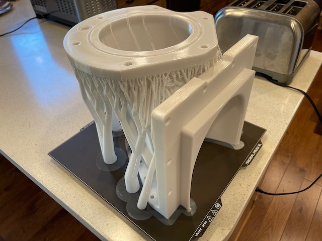

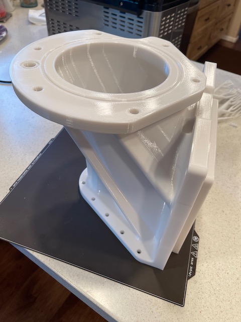

I wanted to get back to everyone on this thread and show that I have had success.  I will discuss what I did to accomplish this print.  First off, this was probably the 5th or 6th attempt at finishing this print.  Obviously a number of false starts.  I succeeded on Friday and I thought I would pass on what I have found out.
Root cause of my failures.
I believe the root cause of most, if not all of my failures were a combination of dirty and/or possibly defective filament.  My project was to print a custom water intake manifold for a custom jet boat my son's business is building.  This manifold is for a prototype boat.  It is not expected to perform across the wide range of performance of the boat but it is desired to function at low to moderate performance to determine the proper basic form and function of the manifold.  Because of this the design restrictions as initially set were:
1) Minimum of 3 perimeter layers on all outside walls.
2) Infill of 50% using gyroid pattern
3) 0.6mm nozzle using 0.32mm QUALITY Filament settings
Final Print parameters that worked:
These are the final value overrides that we found would work.  Yours, obviously, may be different, but this is what worked for us.
Print Settings Tab -> Vertical Shells Periometers = 3
Print Settings Tab -> Infill -> Fill density = 50% @ Gyroid Pattern
Print Settings Tab -> Skirt and brim-> Brim type = Outer and Inner Brim, Brim width = 12mm, Brim separation gap= 0mm
Print Settings Tab-> Support material0> Generate support material=yes, Enforce support for the first 2 layers, First layer expansion = 20mm
Print Settings Tab -> Options for support material and raft -> Style = Organic, With sheath around the support=yes
Print Settings Tab -> Organic supports-> Maximum Branch Angle=25, Preferred Branch Angle=15, Tip Diameter=0.9mm
Print Settings Tab-> Advance-> Extrusion width-> Support material=0.9mm
Filament Settings Tab-> Nozzle->First layer=230, Other layers=240
Filament Settings Tab->Temperature->Bed->First layer=90, Other layers=85
Filament Settings Tab->Cooling->Fan Settings->Fan speed Min=50, Max=65

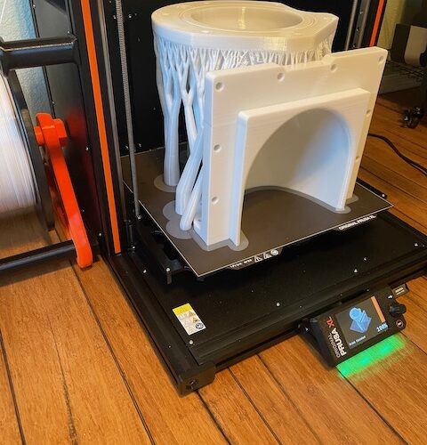

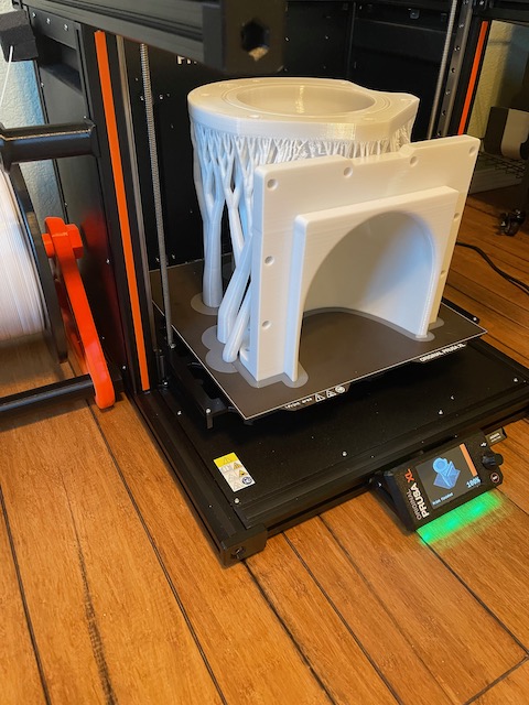

Basic Print Setup
After slicing the basics of the print were the print would require about 3.5days and about 2.5kg of filament.  Because of the large filament requirement we opted to use 5kg reels supplied to us from California Filament.  I've never used them before but they offered 5kg PETG reels at a sale price of about $75 so that looked like a good deal.  We chose to use organic supports as opposed to the more traditional rectilinear supports as it required about 1/3 of the additional filament and took about 2 days less in printing.  After  a couple of false starts with the organic supports we opted to use the very wide brim of 2omm around all structures.  We also found it was important to thicken the walls of the organic supports to close to 1mm because less than this value they failed too often.  The thicker walls and the very wide brims offered mechanical strength to the "trees" and they were not as sensitive to being knocked off by the hot end if some plastic goop on the nozzle forced it to hit the trees.
My Failures
Most of the print failures on this project were due to the fact that after 24 to 36 hours of printing the filament would ultimately jam in the PTFE tube causing it to not feed into the extruder.  This was initially, a very confusing failure as others on this thread appear to be having stuck filament possibly because the extruder head itself was possibly running to hot and the filament in the extruder was getting abraded due to the fact it was soft.  I initially thought this might be my issue.  I later determined the filament we were using either has dirt or filament dust on it, or, in the process of going through the long PTFE tube on the XL, the surface of the filament was depositing itself on to the walls of the tube and eventually it would jam in the tube.  I had one failure where an organic tree got knocked over and this then makes the whole project fail as there is no support for the final layers that needed to be supported by the tree.  I discovered the jam in the PTFE tube when by chance I decided to do a "Change Filament" command even though the filament did not need changing.  I figured it was worth a chance to see if this fixed anything.  When I pulled the filament out of the tube it came out with some resistance and some semi large chunks of white stuff (our filament color is white) came out of the tube when I pulled the filament.  This is when I knew the filament must be getting jammed in the PTFE tube.  I have a portable compressed air tank so I decided to "blow out" the PTFE tube with compressed air to see if I saw anything.  A white cloud of powder blew out of the tube as I forced air backwards from the extruder head back to the feed tube in the back.  This clinched it in my case for the real cause.
Success

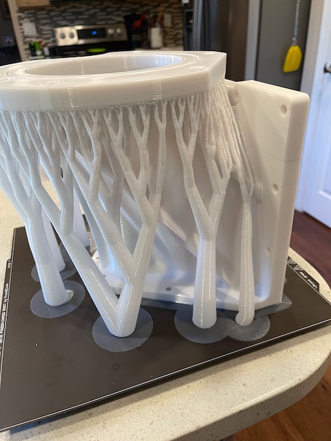

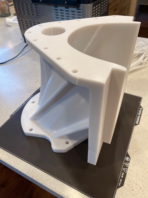

Ultimately the print succeeded because I did the following:
1) Every 12 hours I would do a "Change Filament" command.  I would pull the filament out of the tube completely.  I would blow out the tube, look for dust and dirt.  I would take a wire brush and clean the nozzle.  I would then feed the filament back into the printer and resume the print.  This kept the filament from jamming in the PTFE tube and it also kept the nozzle clean so it would not smack the tops of the organic support trees, which if they do not have very wide bottom brim supports, will cause them to fall off the bed and stopping the print.
2) The design of the organic trees were restricted especially on the Max Branch Angle (25) and Preferred Branch Angle (15).  What this setting does, is it forces the slicer to make more trees that are narrow as opposed to fewer trees that have very wide branches.  Wide branches have too much of moment arm from the top of the wide end branches and just a small tap from the nozzle to the far ends knock the trees off the bed.  Narrow trees with very wide bottom supports work far better.
3) We kept the bed temp to a max of 85 but started first layer at 90.  Not really sure how much this helped but it worked.
4) When the print finished, the model as well as the trees were still stuck well to the bed.  Not so hard you cannot remove them but they did not just fall off either.
Here are some images of the project:
Finished Manifold in XL Printer Finished Manifold in XL Printer Clean Bottom Clean Top Profile showing trees
Sideview Trees
We will be printing this again.  Next time I plan to use 2kg reels from Prusa and hopefully I don't have to babysit the print so much.  Time will tell.  In my case, bad filament I believe was the root cause of all of my real failures.  There were a few fails unique to being a N00B using organic supports but thats just 3D printing.  Hope this helps.
