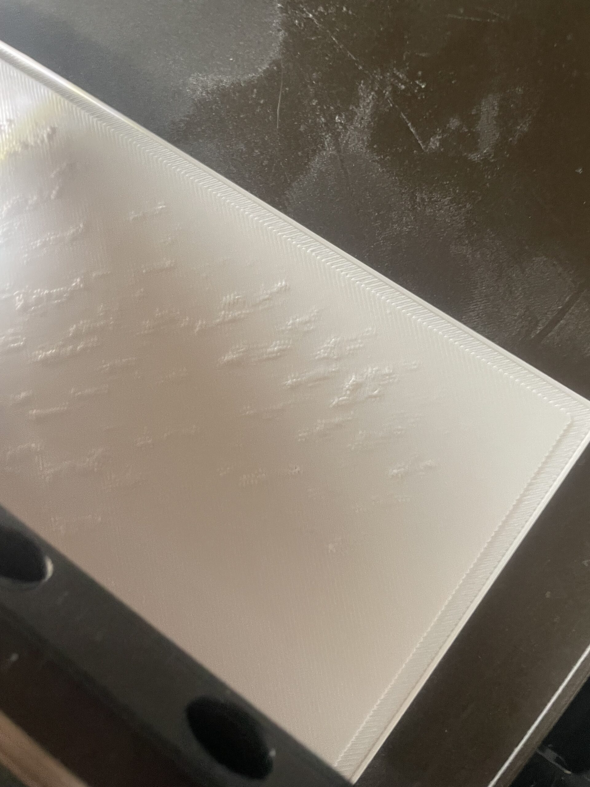

That look like a combination of slight warping and not enough infill-support below the upper surface - try adaptive cubic and make sure the first layer is sticking properly.
Napsal : 13/05/2024 6:58 pm
RE: Bumpy surface
Looks like pillowing. More top layers and/or more infill.
Napsal : 13/05/2024 7:21 pm
Topic starter
answered:
RE: Bumpy surface
The first layer was sticking correctly.
So I increased the temperature by 10, that fixed the issue. Thanks.
Napsal : 13/05/2024 9:04 pm
Topic starter
answered:
RE: Bumpy surface
Increasing the temperature did fix it for the test print but not the much larger print. Will try again with the suggestions given.
