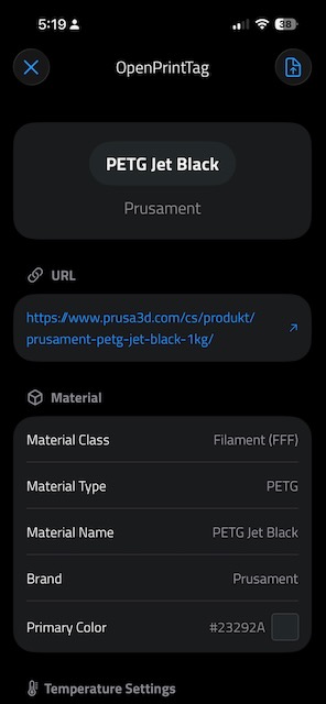

For iOS/Android NFC.cool can read/write OpenPrintTag. Can also import the .bin file created by OpenPrint Generator I just tested it and it works. On the NFC screen, goto NFC Expert -> OpenPrintTag  and enter in all the field information. In the upper right corner there an NFC button. Click on that and you can then write to the tag. Otherwise you can use the OpenPrint Generator, download the bin, click on the NFC button, import the BIN then write it to the tag.
The caveats are that the app is not free (there is a 3 day trial) and the UI is super annoying (to me at least). But it works...

RE: How to write an OpenPrintTag
The tag I created with NFC.cool is readable by the Prusa App. Interestingly enough, the app doesn't display all of the fields. I guess it's a WIP:

Note, if when trying to write to the tag and NFC.cool reports that it's "Read Only", use the "NFC Tools" app to erase it. Go to Other -> Erase Tag. Then NFC.cool should be able to then write to the tag.

Put a value in Consumed Weight to make it editable in prusa app.
