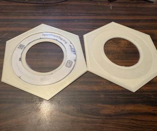

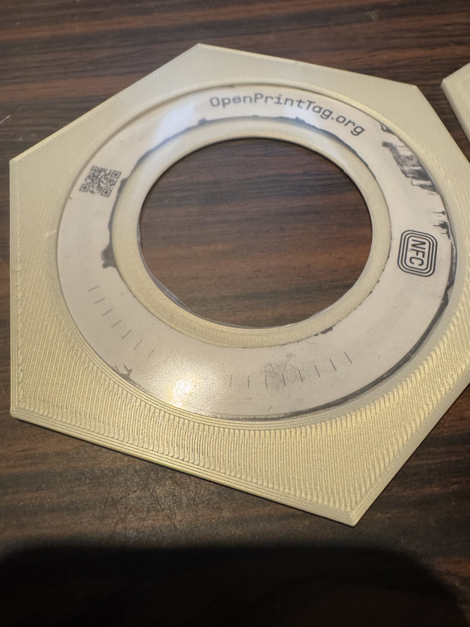

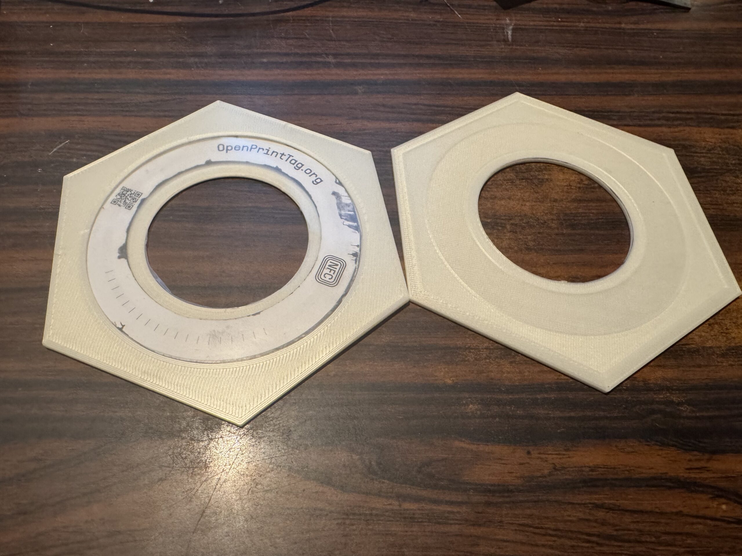

NickAtNight
(@nickatnight)
RE: How to write an OpenPrintTag
Can’t do that.  You told me it was mandatory to ‘roll my own’
So I learned how to use the basics of OnShape. And made this overly complicated tag holder.
Using a bit of plastic from a sheet protector to hold in the tag without sticking it down…
Printed solid at 0.1mm layer height in Prusa Vanilla white.  Weight 12 grams
 curious effect: it has trouble reading when it is sitting on my metal desk.  Works better when it is not near the desk.  Must be trashing the signal.
The second attempt with the first attempt.
There are OpenPrintTag spool adapters on Printables. Use one of those.
Posted : 24/12/2025 6:27 am
