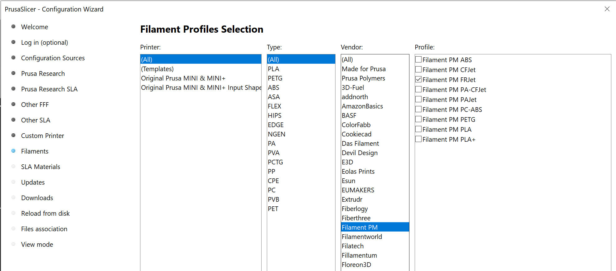

Michal Bartak
(@michal-bartak)
I just found that profiles for FRJet are available to be added via PrusaSlicer Configuration Wizard.
The print is pretty satisfying.
