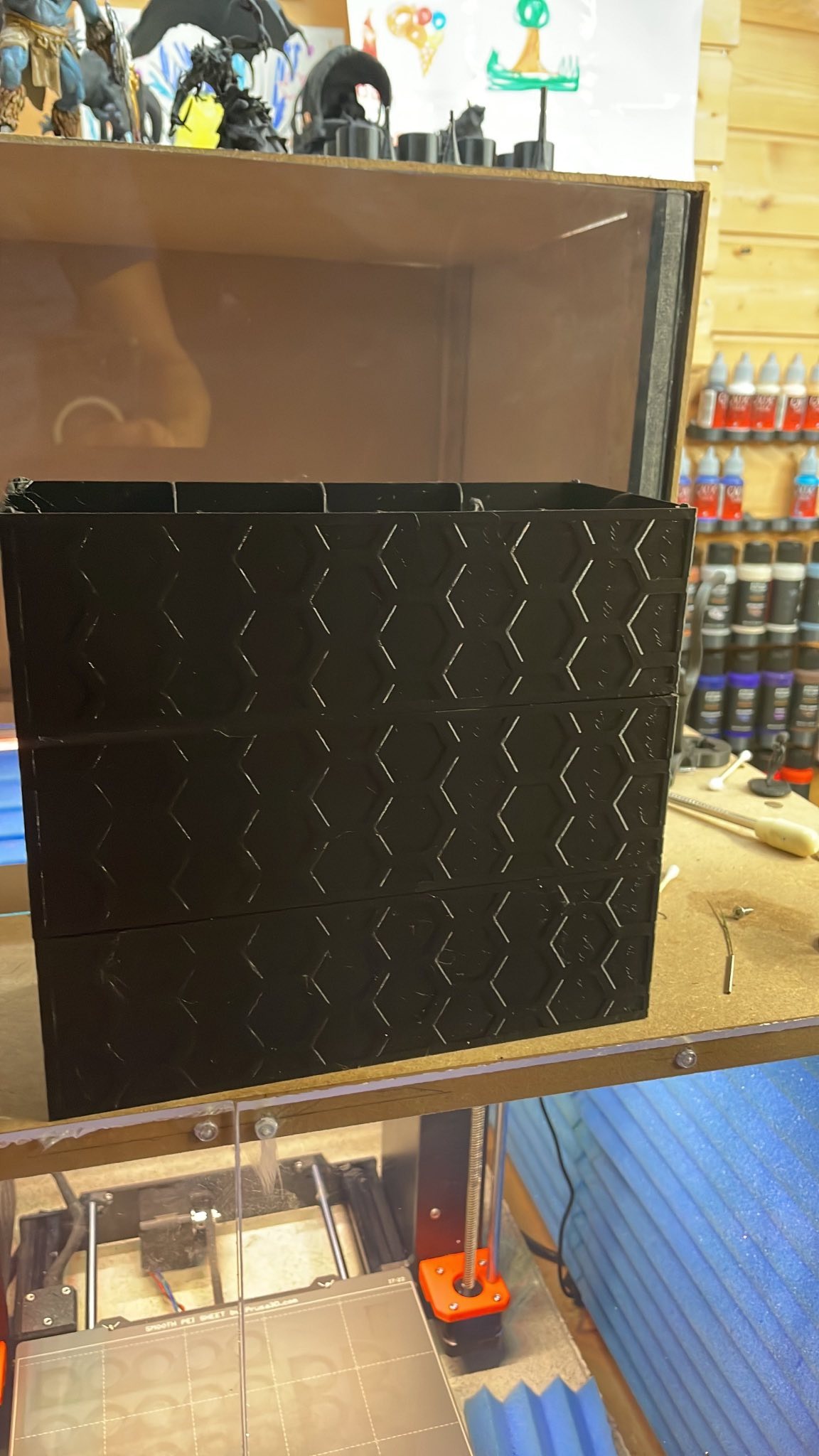

I printed the mini-bases only initial.  I can dig up the video comparisons of how this went with the only variable being a Prusa nozzle, that was "brand new" (ordered form the shop soon as they were on) replacing the shipped nozzle.  And only had problems. after one successful print that I made from a profile I built with alpha 1.  Soon as changed over to the V6, same print, same filament profile, same settings stock 170 no problem.  I even printed something thin, the Mini storage bins, but managed to get a clog. It was easy to clear, bumped up temps printed again on the stock 170 profile no problem.  The after action being, yes trying to print something thin with a 170 profile is a bit dumb, but can we do it? We did and it has some artifacts. related to heat I think. I tend to work through most of my problems.   I am fairly certain I had a defective nozzle that had some sort of heat break issue. Maybe a defect.  But support would only imply it was my failure or fault.   Now, my filament sensor is failing  ... and turning the machine off then on getting it to work again when everything else failed screams to me that the stable 5 is less stable than the RC,  Alpha 4 and 3 were for me.

 I use this profile to print Mini-RPG TT buildings, and I get no artifacts or Defects or issues.  I might bump up acceleration and speed a touch more on one smaller still.  But I ran out of filament.  Trying Esun this round. But also, I offered Bambu to smash my MK4 on video and supply my story, as the ban has pushed beyond my loyalty and ideals limit, for a heavy discount.  Seriously, if they offer me a solid discount, I am going to do it.  But I will still use my MK3S+ as it makes fantastic Minis for an fdm printer. that's sad.
