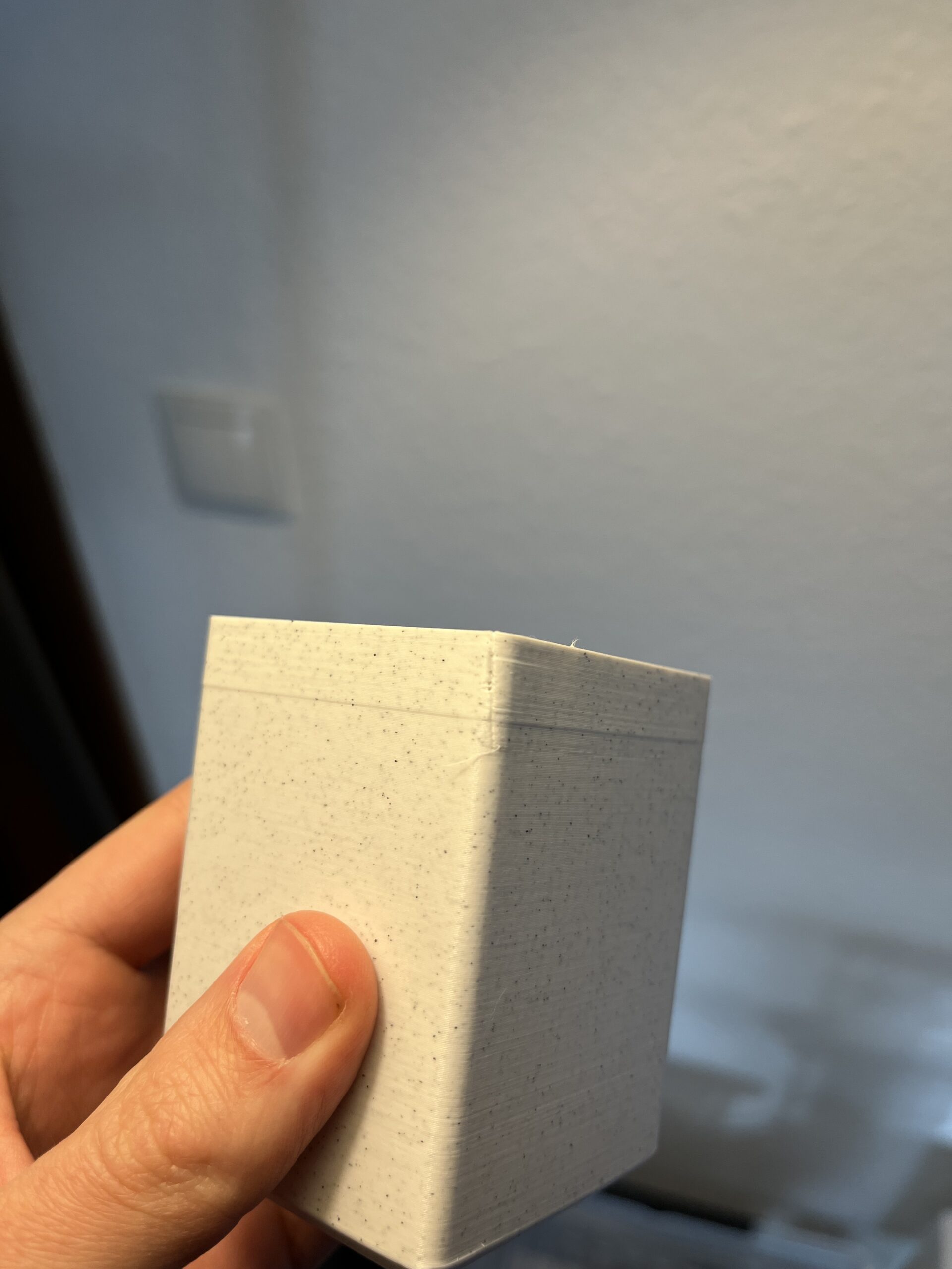

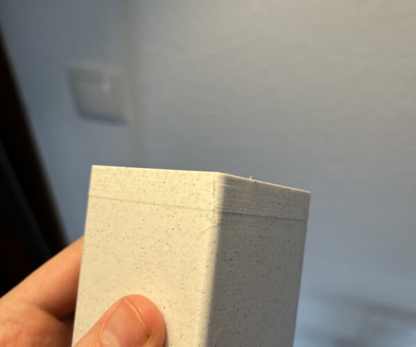

RE: Mk4 IS Seam scar
This is with PETG?
Something seems to be very off with firmware 5.1.0 on MK4... Same issues. But wasnt like this on 5.0.1
It's PLA and the scare is not on the normal profile for the mk4 without Input shaper
I would definitely mention this to customer service through chat instead of only mentioning it on the forum.
Can't get rid of this problem after a week and a half of trying out different settings and stuff. It always looks horrible, which is unacceptable because I sell my designs.
Which firmware is the latest one without this issue? Any idea?
I noticed this too. Worse than my old mk3. I get it on all materials, PLA, ABS and PETG so far. Why can't they do like vase mode where it lifts Z at the end of the loop rather than a hard stop and restart?
I´m running in the same Problem here. Since a couple of days in every print and with both dry PLA and PETG big seam scars.. Are there any updates yet?
It looks like an Slicer Issue.
With slicer 2.7.1 I have tested FW Versions 5.1.2, 5.0.1 and 4.7.2 and they all have this ugly seam. But with Slicer 2.6.0 it is much better.
Have you played with adjusting Pressure Advance settings at all? We have similar issues with our MK4 and just haven't had time to run any Pressure Advance calibrations yet, though plan to shortly. From the pictures it looks like you are not getting enough filament extruded right when you accelerate away from the seam position? Seems like it is occurring at a few other points as well. Little horizontal divots.
You could play with "deretraction extra length" but we find that just causes additional problems. Maybe try less retraction to begin with? Lower acceleration? Kind of defeats some of the purpose of the higher speeds with the MK4 but might help isolate the problem.
