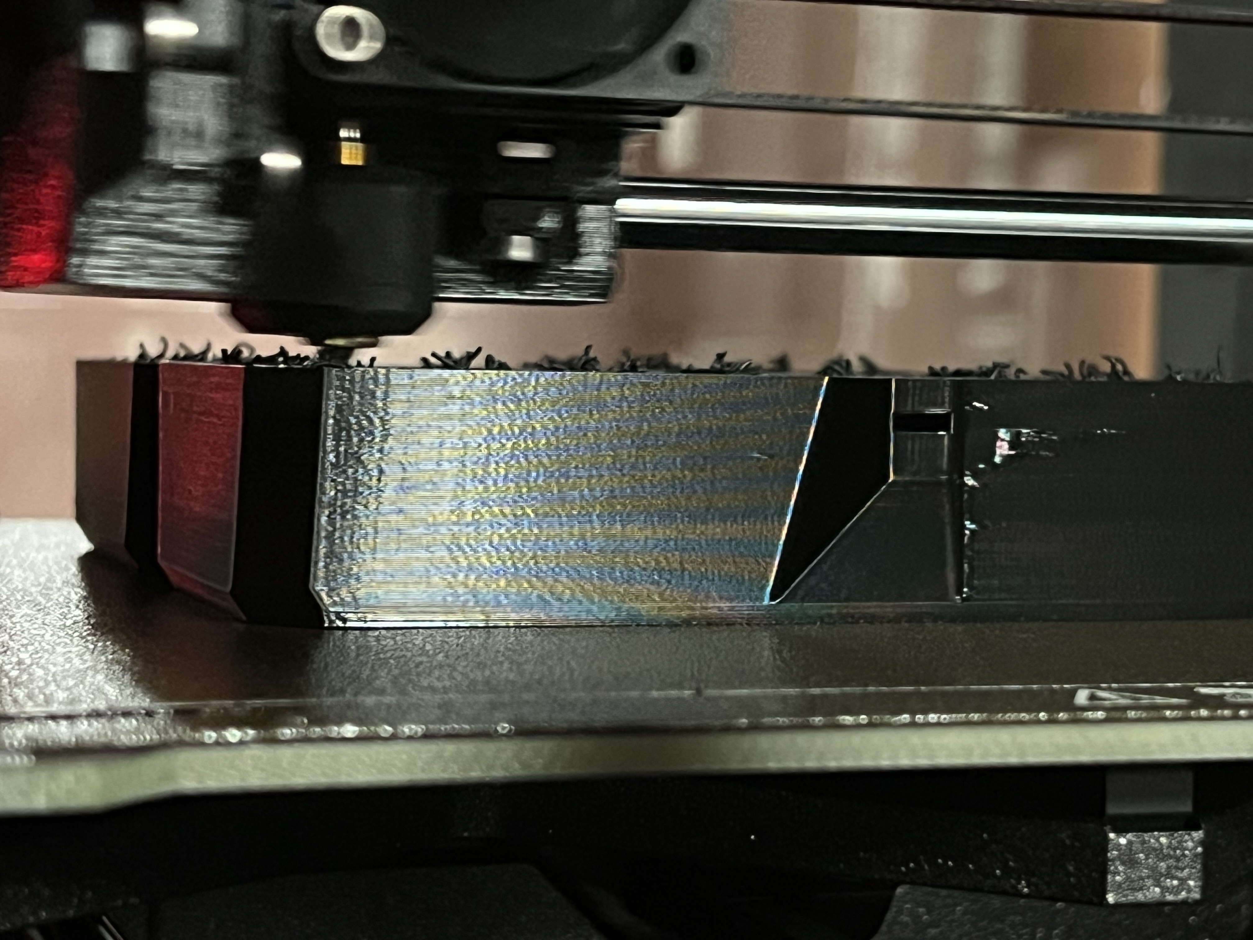

I've also recently experienced some very severe "infill lift" with the default Input Shaper profile. The attached image is an attempt to print the Prusa Enclosure transport handles using the default profiles. Setup:
  • MK4 + Enclosure, 0.4mm brass Prusa Nozzle + silicone sock
  • Prusament PETG Jet Black, dried and printed from a drybox
  • 5.1.0 (final) + PrusaSlicer 2.7.0, with Prusament PETG profile
  • 0.2mm Structural IS profile
I compared with the previous profiles and I noticed that 2.7.0's profiles reduced the PETG maximum flow rates and infill speeds. However, that did not eliminate the issue. It's possibly a little less severe after 2.7.0, but the default profile still results in nasty infill that causes nozzle scraping, and little fragments of PETG end up strewn all over the bed and around the printer, and a lot of bits also end up trapped inside the print. It's so bad that you can pick up the print, shake it, and it sounds like a maraca. I suppose that could be considered a feature if one wanted to 3D print some musical instruments, though. 🤣
In the past I've switched to Rectilinear infill (which alternates directions) in some cases where scraping was an issue, but I have also used Grid infill plenty of times before with no issues. I suspect a lot of the problems here come down to the speed and volume at which the infill is being extruded with IS. Going fast is nice but I'd rather have the "structural" IS profiles focus on reliability.
At a small scale, here's what I think is happening: when the nozzle crosses the perpendicular lines of infill that were previously printed at the same layer, it effectively "cuts" or "wipes" the extrusion off the nozzle, and it causes a break that then results in the next "segment" of infill not connecting on the other side of the crossing and it doesn't bond properly at the start. With the higher speed, plus the higher viscosity of PETG, that would result in the little curls of filament that we see.
Anyway, there's definitely some tuning needed to the defaults here. IS is nice but we can't be sacrificing reliability for speed.

Followup: multiple prints now with identical settings. The only thing changed was infill type to either Rectilinear or Gyroid. No failures, no infill lift, no maracas, and no "PETG sprinkles" all over the bed.
Basically, I think any infill pattern where the extrusions cross previous perpendicular extrusions at the same Z height is probably going to have problems at higher speeds, and that slower speeds could avoid "splitting" the extrusions. It looks to me like the speeds that IS enables are beyond that point. Of course different materials might also behave differently; lower thermal expansion and less stringing might both factor in to making PLA less susceptible to these effects, but it would require testing.
