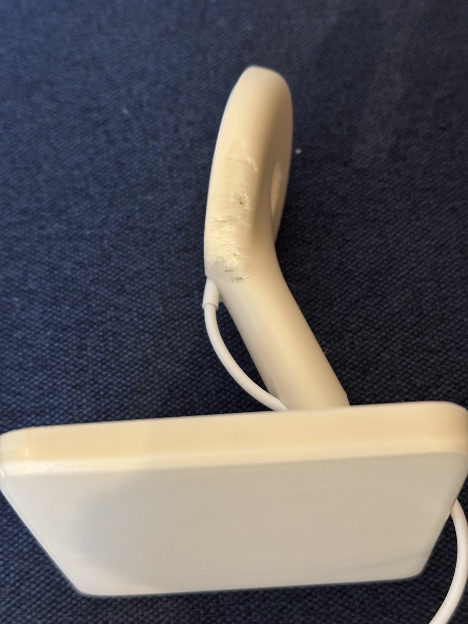

Aha, so that's what it is. I'm new in the world of 3D printing but noticed artefacts similar to mechanical abrasion in my freshly printed Magsafe holder. You even see some black marks which looks like the come from the residue on the nozzle hitting the print. MK4 in an enclosure with ventilation, Prusament PLA, all standard setting.

Overture PETG Grey, Standard Prusa PETG setting.  This is like my 5th spool of the stuff and I never had a problem until the official IS came out haha.
@zappes no question it's infill related.  Pic attached.
These are 4 separate prints:
Grid - Grid - Rectilinear - Gyroid.
They're different prints (kind of) printed at 0.15mm.  All required supports, relatively simple designs, single object on the sheet, everything kept default profile with exception of infill.
The outer walls are surprisingly well maintained and only the infill is a mess (except the gyroid).  Additionally, each of the first 3 prints was reprinted with Gyroid with no issues (the 4th is the actual reprint of the 3rd).
