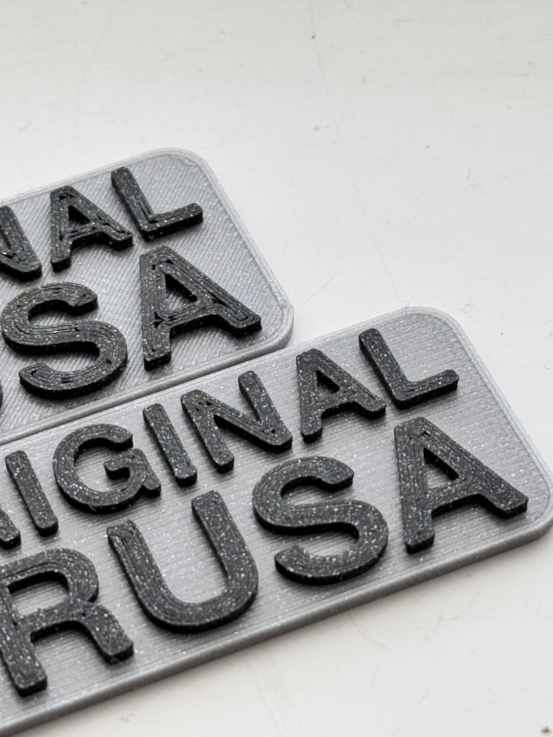

Noticed gaps in layers with Input Shaper - anyone else getting this??
See image below - the lower print was before input Shaper. The upper print is with Input Shaper. Notice the gaps in the letters etc. Any way to fix this or is it just a drawback of using IS?

Same to me (0,4 nozzle, PLA) - see below

It's sliced differently, likely not related to IS. It is sometimes better to switch perimeter generator to classic, instead of default Arachne.

Will give that a try, thanks!
