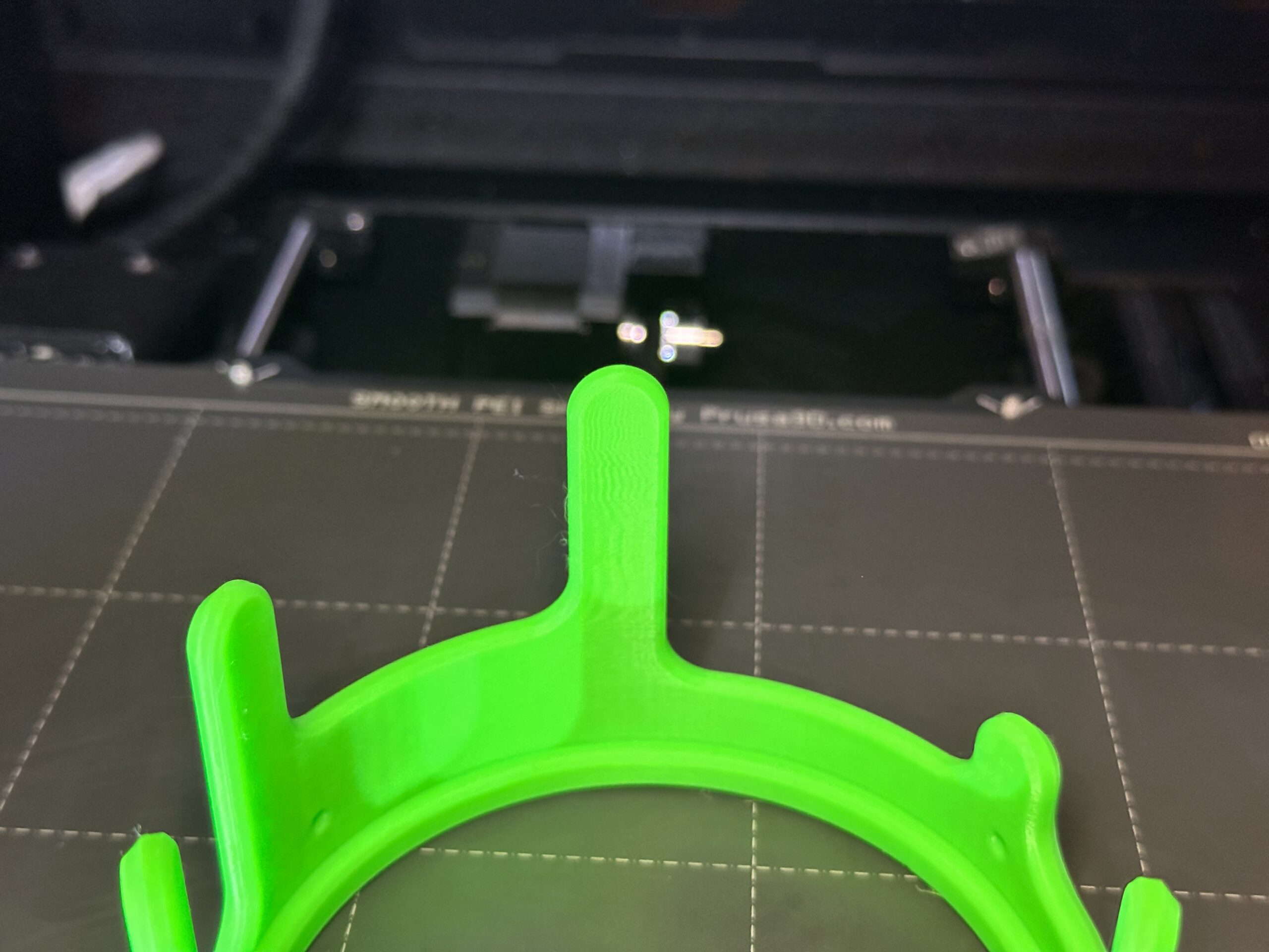

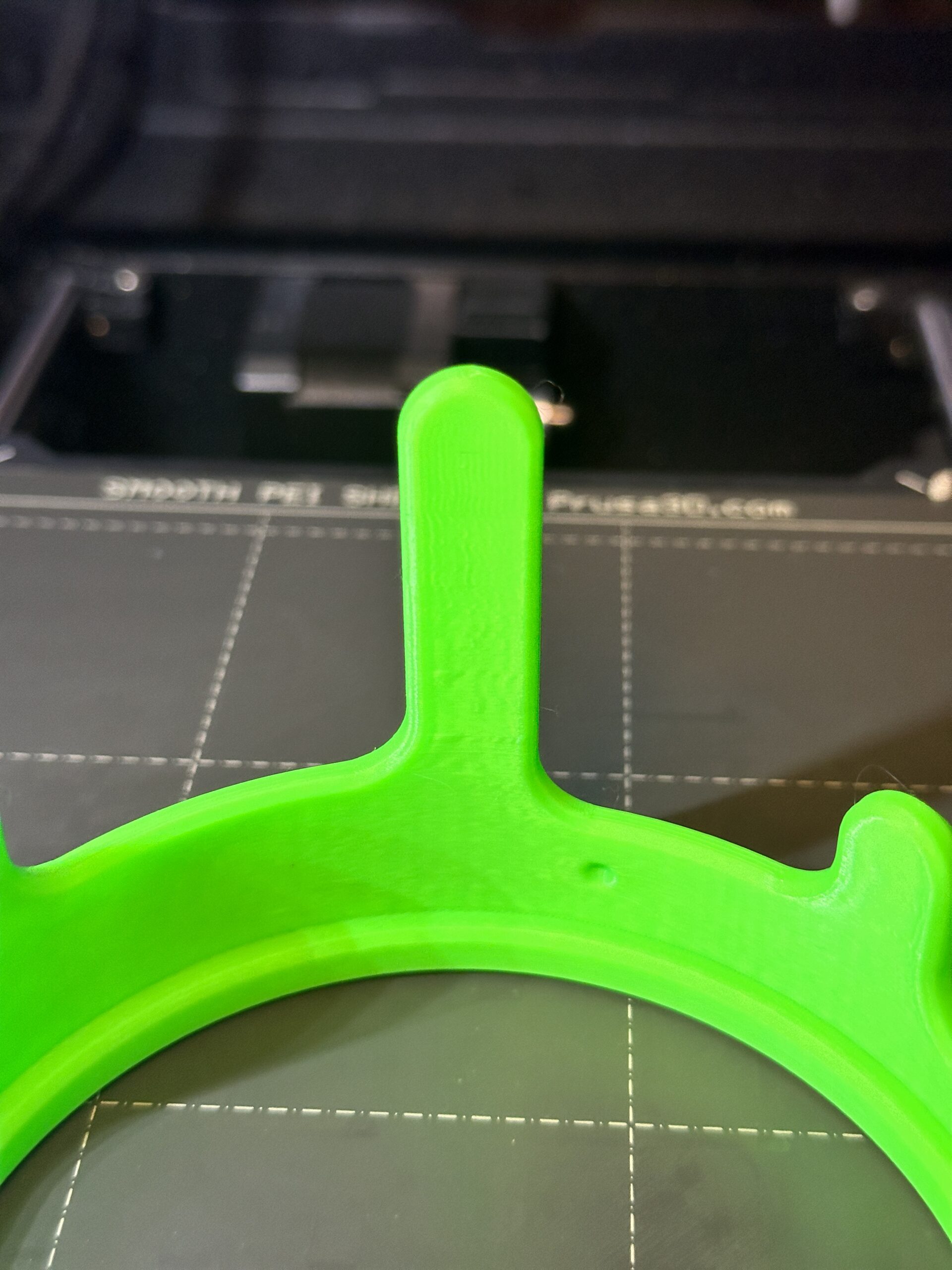

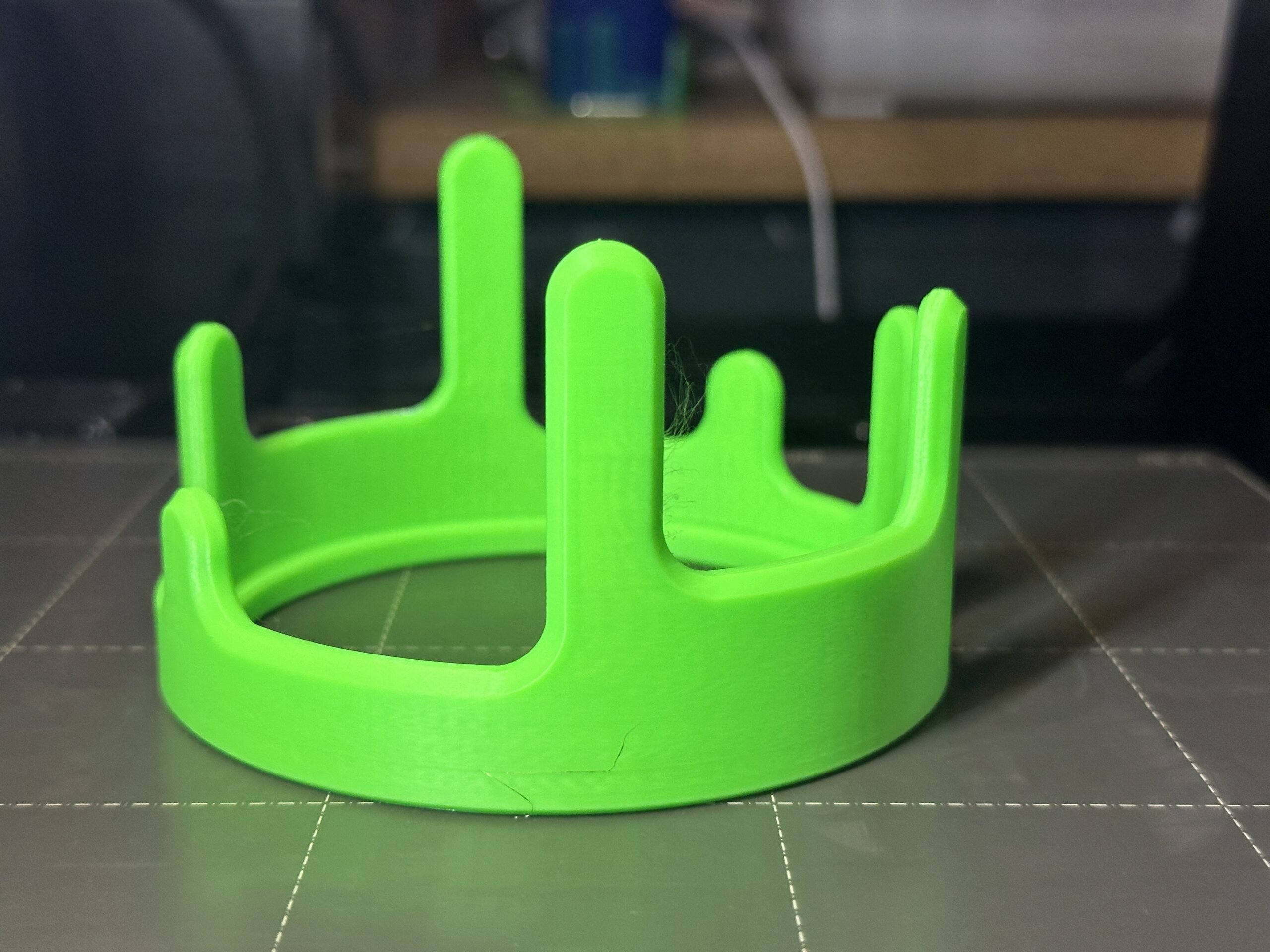

RE: Any idea why these lines are showing in my print ?
It seems that your part has warp a little, just the outer perimeter. That caused the plastic to bulge on the external perimeter of that layer.
Maybe try to increase the bed temp a little, like 5°C. Or to use some glue stick.
