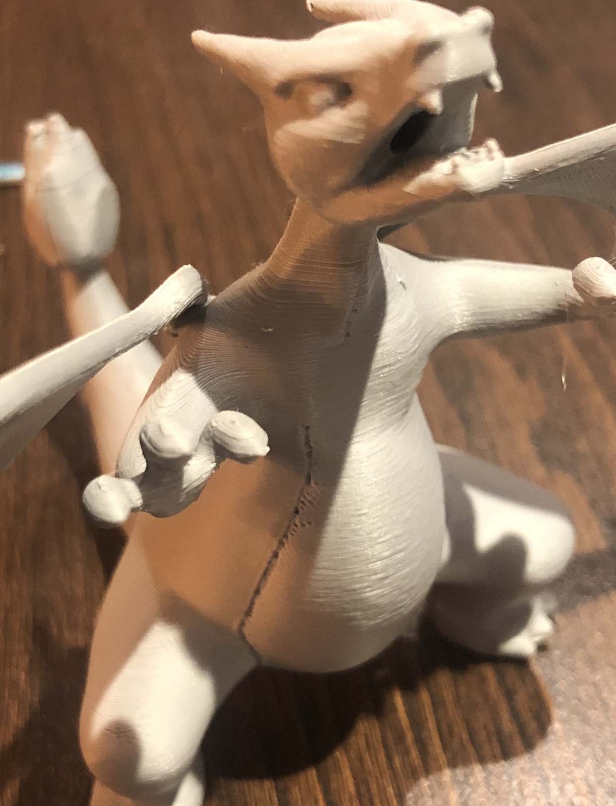

I have the seam as well 🙁 I love the speed but I also have visible layer lines. At first I thought it was the x or y belt tension but it hasn’t improved after tightening. I do hear the extruder some times so that’s my main suspect for the lines. The seam is something else I think?

Unfortunately, I agree, not an improvement with 6.0.0 firmware and 2.74 slicer. Here are two connected spheres. Seams are ugly, and before and after the seem on the overhangs are particularly ugly:
The other side, away from the seam, same overhang, is not too bad:
I tried various perimeters settings and none seemed to make much of a difference.

I think I'm on the path to resolving this issue on my Prusa Mini by significantly reducing default retraction length. My setup is stock except running a Diamond Back 0.4mm nozzle (which I confirmed was not the issue by trying a nozzle swap). I'm primarily running Prusament, Atomic, and Printed Solid PETG, but will verify that these settings work on other filaments as well when the opportunity presents itself.
What has helped?
  • Reducing default Retraction Length from 2.5mm to 1.1mm
    • This was the fix for me. 1.1mm is currently resulting in a slightly proud seam, so I may need to increase this a very slightly.
  • Deleting "M221 S95 ; set flow" from Start G-code
What did not help?
  • Calibrating K-factor
  • Increasing retraction
    • Made the issue much worse
  • Changing temperature
  • Replacing the hot end PTFE tube
  • Replacing the extruder to hot end PTFE tube
  • Adjusting idler tension
  • Swapping nozzles
Posted : 15/05/2024 9:53 pm

How is your top surface? I became wary of messing with retractions because the top surface went to crap. I'd be willing to try it again though. They really need to incorporate the scarf seams. Orcaslicer users seem happy with that. There are other issues with Orcaslicer running on my Linux computer though, and I do not think they have incorporated input shaper for the mini.
Can't you just change the extrusion multiplier in the slicer settings rather than deleting gcode? I left the M221 in but the extrusion multiplier is 1.1, so it actually gains about 10%

I don't think retraction should appreciably impact top surface quality. Here is a photo of the top of a recent retraction test piece.
Adjusting extrusion multiplier should have a similar impact to adjusting the flow rate via Gcode. I thought the Gcode route was cleaner since I generally dislike having this kind of setting hardcoded.
Your extrusion multiplier of 1.1 should have an effective extrusion multiple of 1.045 (from 1.1 × 0.95). Interestingly, my thickness measurements tell me I should have set mine 1.03, which I'll give a try to see if it gets me better dimensions without impacting the top surface!

Oh my goodness, thank you so much! I've spent a couple of days trying to sort issues on my Mini. Changing the retraction to 1.1mm made a huge improvement - couldn't find any info on this on all the various forms and posts I've reviewed up to now.

I don't know if you have solved this issue, but I too have encountered this problem with the Prusa Mini with Input Shaper and found a simple solution that works for me. But it took me a couple of hours to find the answer after trying to adjust the retract settings (retract length, retract speed), Extrusion Multiplier. It did not solve my problem.
I talked to Prusa support and they said I can try to change my filament and give it a try, as the filament may be for low speeds. I said yes, but stopped to check if the Panchroma PLA from Polymaker is for high speeds. The answer is yes. I was thinking there is another software solution, I need to check the retraction settings. I noticed I have Deretraction extra length and checked what this setting does.
I found this github discussion: https://github.com/prusa3d/PrusaSlicer/issues/11915 In the ticket it explains about an older BUG on an older version of PrusaSlicer and how these settings fix the problem.
I tried it and found that setting it to 0.5mm will work.
