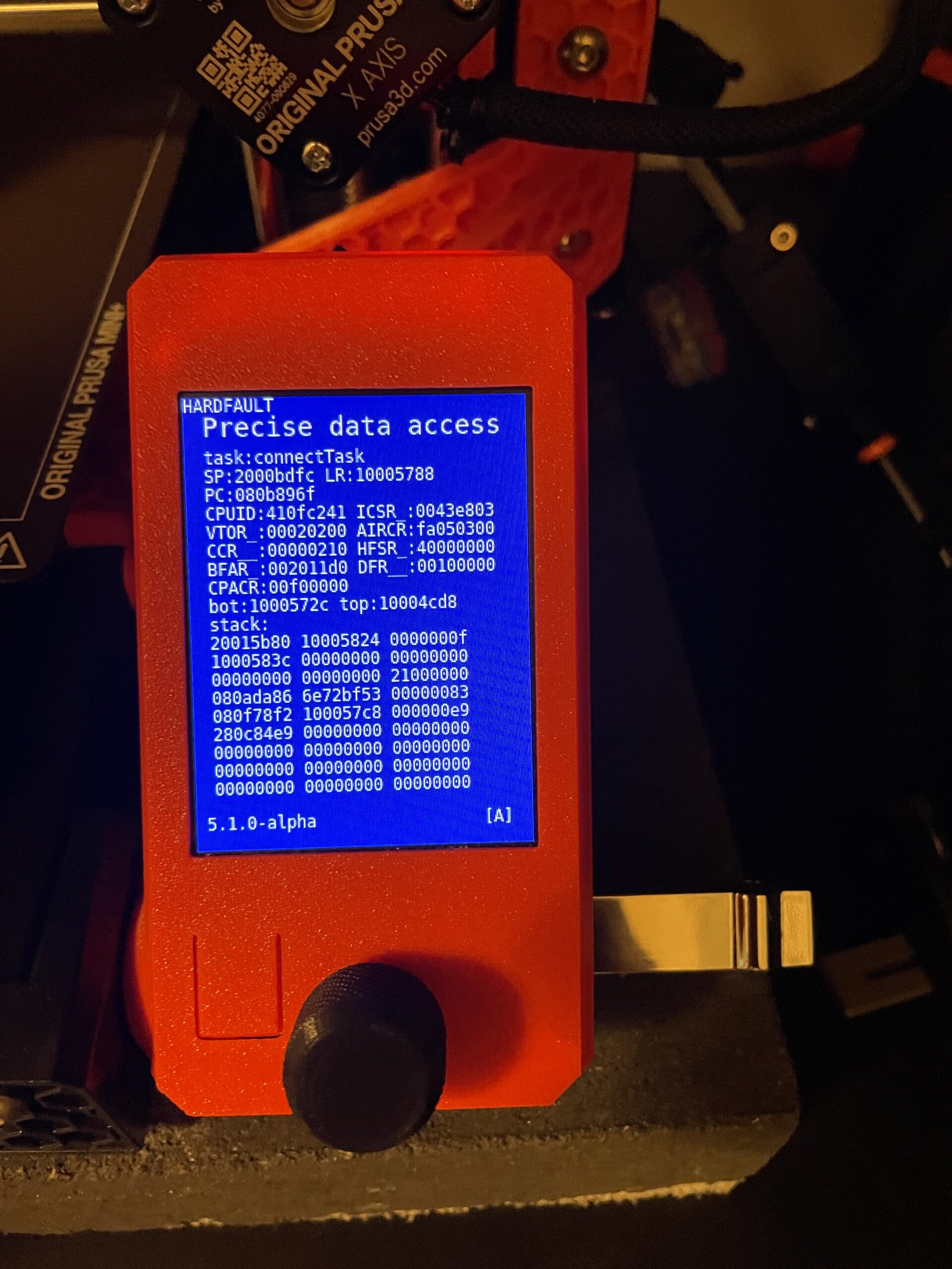

I got this error mid print : Precise Data Access, followed by a lot of characters. I can put an image of someone explains me how to do it. Here is a link to the image
Does anyone knows what this is ?

Here is the picture :
I also have the crash dump file, but I don't know if it can help here on the forum.

Yes add the crash dump that will help looks like an error getting to prusa connect carnt be sure until I get crash dump

So the dump is corrupt it took a while but I've debuged some of it was it when you were printing mgsafe clamp

That's the last known error I did see a 401 error with connect but that was on boot oh and the random characters are because it's corrupt
Starts below
not enough space for format expansion (Please submit full bug report
GCDE/home/admin/workspace/RELEASE-input_shaper_mini-alpha1/lib/Middlewares/Third_Party/FreeRTOS/Source/portable/GCC/ARM_CM4F/port.c�freertos configASSERT�/home/admin/workspace/RELEASE-input_shaper_mini-alpha1/lib/Middlewares/Third_Party/FreeRTOS/Source/event_groups.c�/home/admin/workspace/RELEASE-input_shaper_mini-alpha1/lib/Middlewares/Third_Party/FreeRTOS/Source/queue.c�/home/admin/workspace/RELEASE-input_shaper_mini-alpha1/lib/Middlewares/Third_Party/FreeRTOS/Source/tasks.c�IDLE�TmrQ�Tmr Svc�/home/admin/workspace/RELEASE-input_shaper_mini-alpha1/lib/Middlewares/Third_Party/FreeRTOS/Source/timers.c���St19_Sp_make_shared_tag�ð•@”not enough space for format expansion (Please submit full bug report N12_GLOBAL__N_121system_error_categoryE�*N12_GLOB
Posted : 11/10/2023 9:15 am
Hello
(@hello)
Try do a print without input shaper if it works try reflash the firmware that's all I can think of it's throwing a few errors anyone else got ideas

Yes it's when I was printing the Magsafe Clamp, I cleaned my usb drive, re-flashed the firmware and re-configured PrusaConnect. Now everything works correctly, except PrusaLink, but that's the case for almost everyone with the beta firmware I think.
