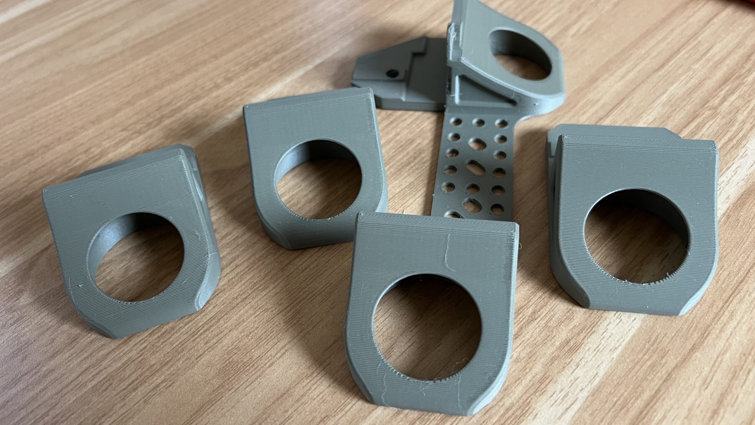

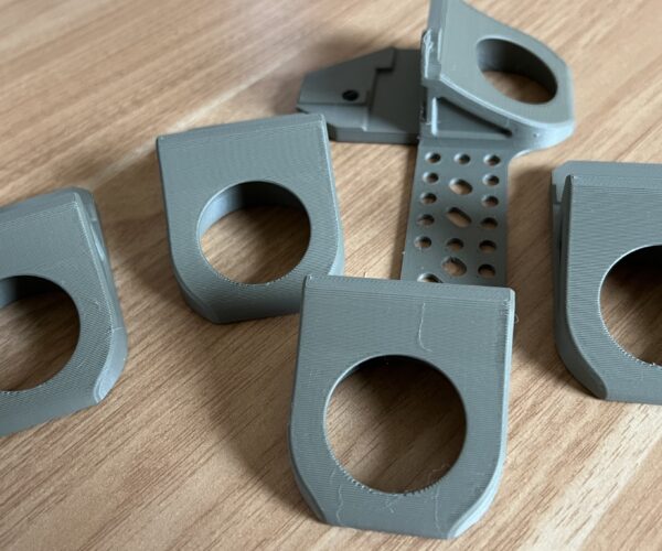

Hi all!
I am also on the journey of installing a DD extruder, in my case I opted for the TBGS from TriangleLab. I've been struggling to get some decent prints and I couldn't figure out why, nothing improved during my test for the perfect LA value.
It would be wonderful if who has their DD working could share there profiles so I have a better baseline to work with my extruder. More likely I will need just to adjust the input shaper values (M572)

I have and no result, anyway I’ll try to calibrate the printer with the default extruder and then install back the DD and start over step by step.
I am interested in others profiles because how these prints looks, it seems to me that I am missing a some settings that doesn’t regard with motor current and or steps.
Posted : 18/01/2024 4:41 pm

hey!
I’ve been working on the printer calibration and settings and everything. Also I started fresh with the original profiles to check things from a clean state.
Finally I made it work! Now I print nicely with PLA and PTEG!
Anyhow I am struggling to print TPU, the gears just jump trying to push the filament and it does not go through the extruder. I am not sure what could be producing the jams now, even with the Bowden system I was able to print decently tuning the flow factor each print.

I just got an update!
I think I found the issue and it wasn't straight forward, I was blaming either the extruder or profiles or the filament... and it was actually a PTFE tube.
What?? yes a PTFE tube, let me explain this.
I was seen the filament getting jam all the time, after the first print where I manage to print some layer properly before the first jam.
The estrange pattern I notice in the filament each time I was unloading it is a wave pattern periodic every time the extruder gears jump. And then I realice it was happening at a distance below the extruder gears actually. Then it was when a hunch started to come up in my mind, the bending of the filament it is happening after the gears are pushing it so it needs to be something else.
I just dismounted the extruder to notice that in my modified mounting for sherpa/TBGS extruder the path between the PTFE tube fitting nut and the extruder does not have a PTFE tube to guide the filament. This does not affect PLA or PETG because they are rigid enough to push through the hotend.
On the other hand I remembered the hotend PTFE tube was a bit melted and so it got shorted, making room to move up enough to allow the filament to melt in a chamber before it goes to the nozzle and therefore getting stuck.
In conclusion I replaced the hotend PTFE tube and add one after the extruder and before the PTFE tube fitting nut.
AND IT SEEMS TO WORK NOW!!!
