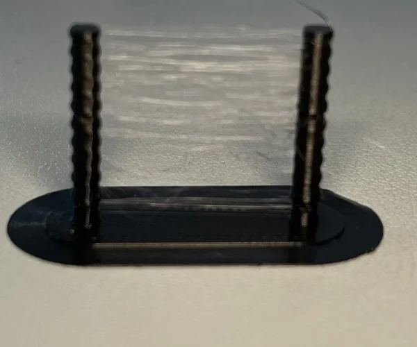

Hello! I have had my Prusa Mini now, for about 3-4 years and never had an issue. Recently found out I could update firmware to 5.1.2. I did so and somehow lost all my custom print settings. I deferred to the default print settings and attempted a stringing tower, and have had many fails. S.o.S. Please Help! Thanks in advance!
Printing on stock Prusa Mini (no super pinda).
  • Filament: Esun PLA+
  • Nozzle temp: First Layer 205/ Other Layers 200
  • Bed Temp: First Layer 60/ Other Layers 60
  • Using .4 Nozzle
  • Using .15mm Quality preset with some custom settings.
  • The following are the custom settings I set.
Things I've done:
  • Squared the printer (x,y,z axis)
  • Rebuilt Extruder
  • Recalibrated/Reset Idler Arm
  • Checked Tension on x/y axis belts
Most Recent Stringing Tower has very wispy stringing, but now wont hold cylindrical shape. I'm shooting for high quality prints, dont care to much about speed.

If the posts of that stringing model don't hold their shape, you may want to check Filament Settings>Cooling>Cooling Thresholds>Slow down if layer print time is below and set that to a 1 sec or so.

oof... actually i don't have a filament dryer. To clarify, there is no fuzz, its got wispy stringing, and the shape of the tower looks less cylindrical, and more like the dollops from a Dairy Queen ice cream cone. XD I hope that helps.

Here is a better picture. Sorry about that!

OOh! Just adjusted the cooling setting:
Changed:
  • Full Fan Speed at layer: 4 to 0
  • Slow down if layer print time is below: 15 seconds to 0 seconds.
follow up question, is it kosher to run the fan on 100% of the time its printing? except... the first layer for the sake of adhesion
Update image of the print after making the changes, it seems to start wanting to retain the cylindical shape its meant to have. The woopy belly waves have reduced! Now to deal with... the little notch of underextrusion/veiny textur at the 10th-20th ish layer....

Are you very new here?  IIrc the forum won't let you upload until after a certain number (10?) of posts.
You need to dry that filament.  I expect it to fix the stringing.
The irregular layer positions *might* be due to the drive pulleys slipping on the X&Y motors.  Or it may be due to belt tensions drifting out of spec.  Check the belt tensions first.
Print this: https://www.prusaprinters.org/prints/46639-tension-meter-for-the-gt2-belts-of-i3-mk3s-or-prus
It MUST be printed in Prusament PETG or the spring tension will be wrong.
Let us know how you get on.

Yesss.. I'm fairly new to the community. I've ordered a dryer which should be here in a few days.
Stringing was reduced significantly with the cooling advice i received earlier.
I checked the Tension and im a little on the tighter side, but made some adjustments to sit as close to the middle of the guage.
I printed a calibration cube and it came out near perfect.
However, I tried printing a regular model and found some zebra stripes/wavy/veins on surfaces with 1mm thickness. Which seems to correlate with the wavy cylinders of the stringing tower. No sure what's causing this.

How thick are the walls showing the worst patterns?
Napsal : 06/02/2024 6:52 am
Bryan De La Cruz
(@bryan-de-la-cruz)
RE: Stringing Towers Battle for the War on Stringing
1mm
Napsal : 06/02/2024 10:51 am
1mm is too thin for good results.  With a standard 0.4mm nozzle extruding at the default 0.45mm width there is room for two perimeters and no interior, it is normal to have problems with such a narrow wall.  As  rule of thumb don't expect good walls with fewer than two external perimeters on each side and one inner extrusion to take up variation; around 2.5mm or more.
Napsal : 07/02/2024 4:05 am

Right on. Thank you for the advice! I've checked my file and found exactly what you described. .45mm extrusion width for 2 external perimeters on the areas with 1mm walls.
Napsal : 08/02/2024 4:53 pm
Bryan De La Cruz
(@bryan-de-la-cruz)
Update: Rebuilt the extruder and found that I had a cracked idler spring!
I made the following changes.
  • changed every moving print speed to 30mm.
  • Greased the x/y rods
  • Added a z brace to the frame from (Printables)
  • Rebuilt Extruder
  • Used a Coil jig to create a new idler spring with 3mm ID from 22GA Kanthal wire.
  • Increased nozzle temp from 205 to 215
  • Increased bed temp from 60 to 65
I printed a new model and discovered I had some underextrusion (zebra striping ish effect) during the retraction "phase". BUT on the whole model ZERO Stringing!
Which leads me to potentially my last question, whats a good DEtraction speed/length to counter my retraction? or should I just use the same speed/length as retraction?
