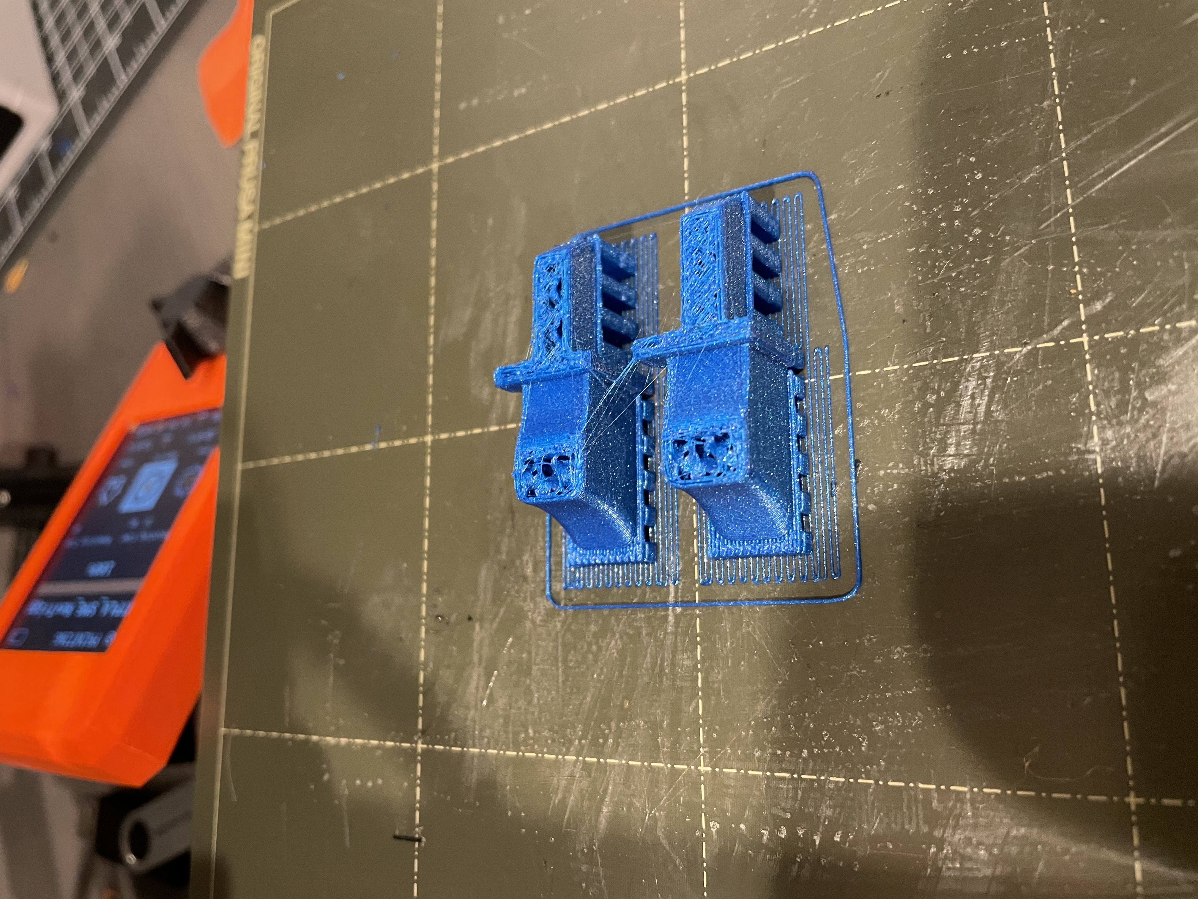

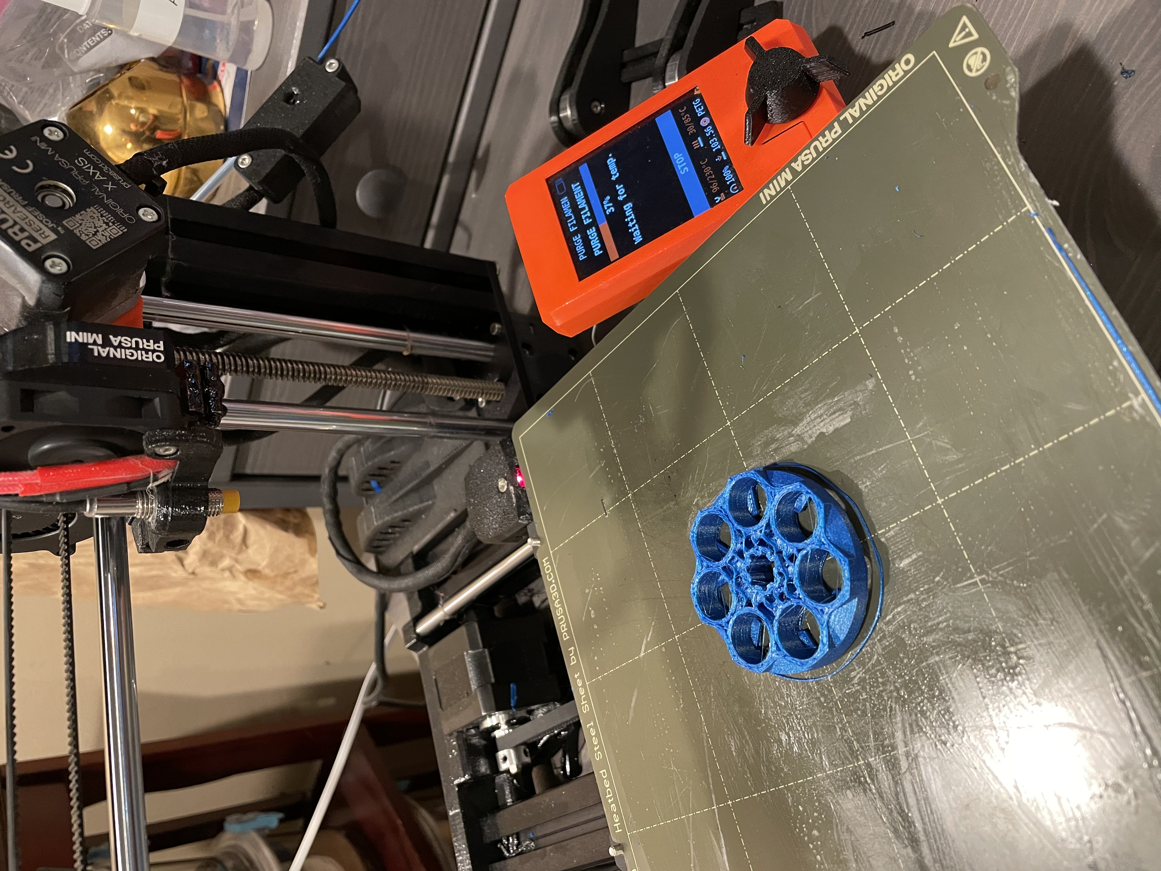

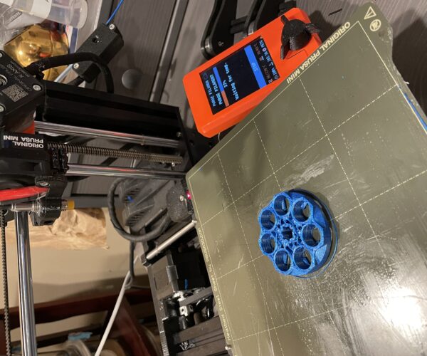

Not looking to hijack this thread but I'm having similar issues printing with Proto Pasta HTPLA. I set my temp to 225 for my first print (2 hour print) and it came out great, tried reprint the same print and it failed with at the very end with a clogged nozzle. Reprinted a different 2 hour print at now at 235 and if failed again at the end with a clogged nozzle. For my next print (6 hour print) I bumped the temp up to 240 and after the first hour printed fine then it clogged (see pic). Tried to reprint the same 6 hour print with the temp bumped up to 245 and it failed after 2 hours.
I've been printing on my Mini for about 6 months and last month replace my nozzle with E3D V6 0.4mm Brass nozzle from Prusa. Printing at .20mm and 0.15mm, prints with Prusament PLA and Hatchbox PETG and those come out fine.
What I don't understand is how I can have a successful first print at 225 degrees, but I can't repeat this. Proto Pasta HTPLA fail Proto Pasta HTPLA fail
