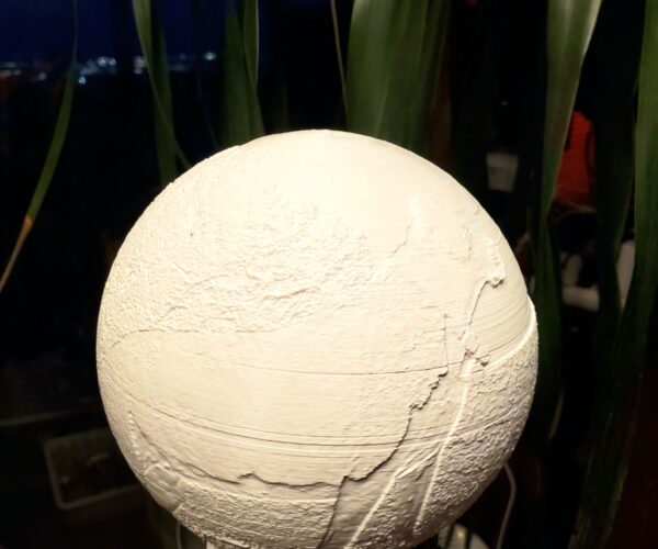

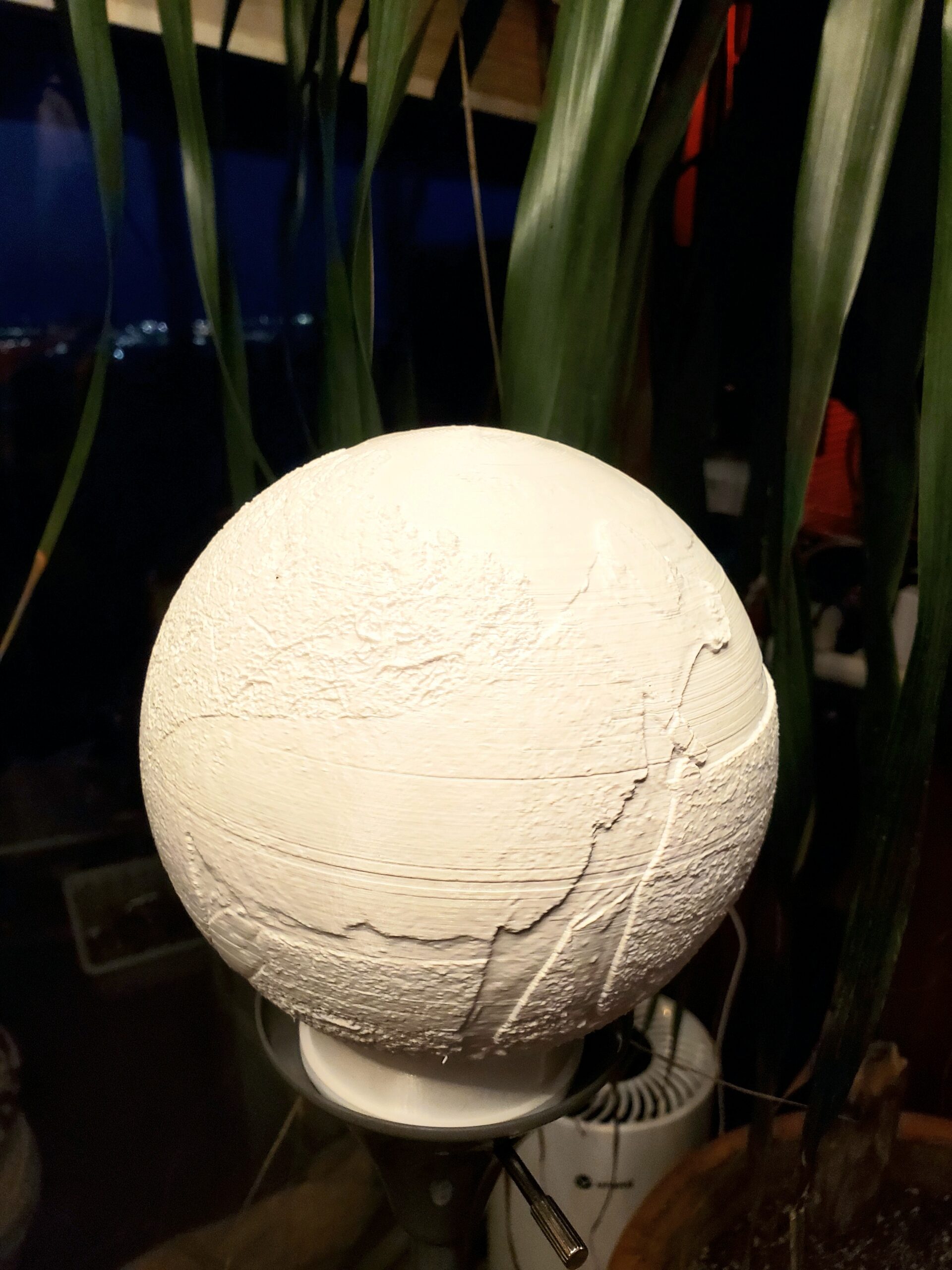

24kJames
(@24kjames)
Colorfabb XT White is a clean white, and opaque. It has printed beautifully on my MINI, though in the case of a 24hr+ spherical lithophane, I got some sort of banding, but it doesn't bother me a bit. I find the final result to be everything I wanted it to be. On smaller prints (everything is small after the spherical lithophane,) I considered  them to be, "perfect," prints, each time. If you want something in the flex realm, Filamentum Flexfill 98A White, is pristine white, opaque as it gets, and also prints beautifully on the MINI, at quite surprising speeds, too. Worth noting, all prints I'm referring to here were done with a .4mm Olson Ruby. (I print a ton of abrasives, and the Ruby relieves me of nozzles changes, as it prints everything filament I throw at it, abrasive or not. 95% of edits to my default profiles have been to achieve certain effects, as opposed to just getting a filament to print at all.)
Edit: I included a photo of it without backlighting but, for me at least, it isn't showing in my post.
