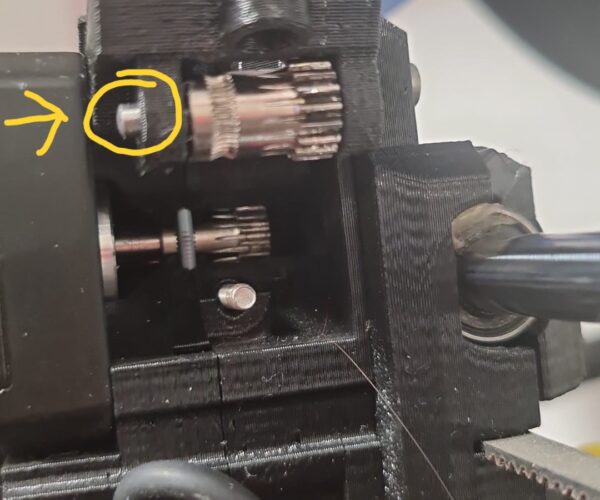

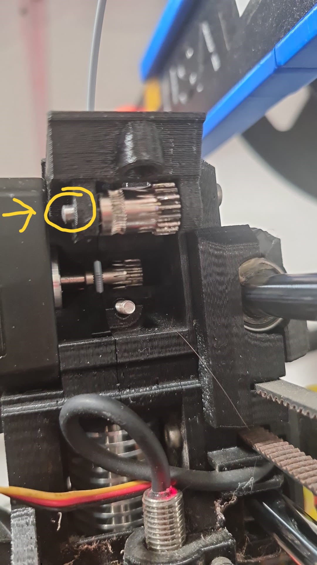

I had the same issue, went through a week of trouble shooting and Jerry from Prusa Support caught the issue straight away.
The pin holding the gear came loose and was running skew therefore not griping the filament uniformly.
I hope this helps someone save some time.

mchet
(@mchet)
RE: Issue with gaps in layers
Thank you for this post, I was having similar issues as above, and this instantly fixed it! The pin on the idler gear was loose about the same amount, so I just pushed it back in, and I have no artifacts now.
