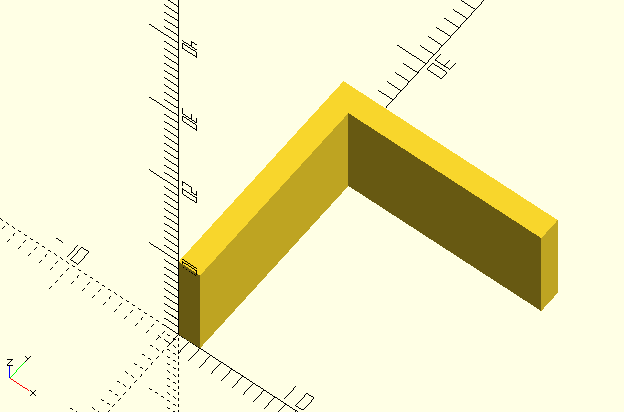

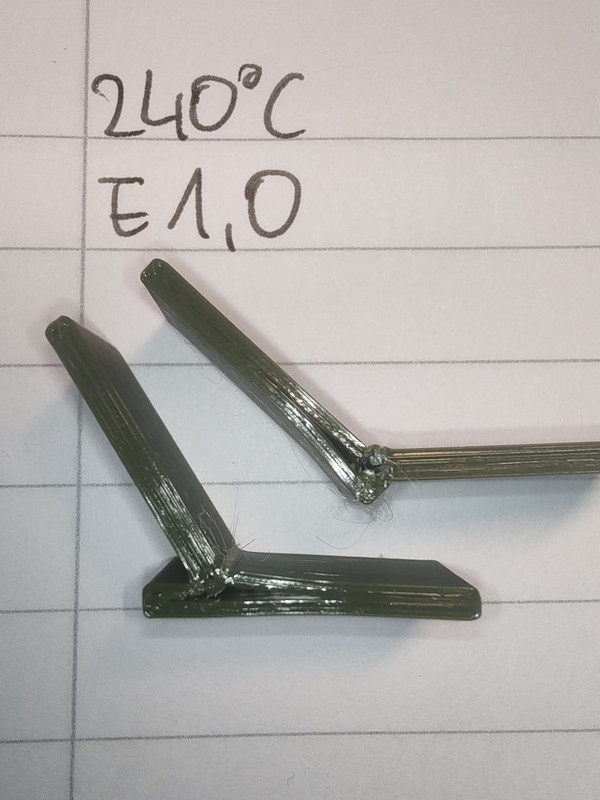

I wanted today to print some table upgrade, and i found that the part i printed is not so strong on the edges, while the rest of the model is quite robust, so with quite little force i was able to break it like on the picture below:
And some details:
So looks like the material is mot melted enough... I changed some settings for that particular PETG, which you can check in the attached project file:

Turn your print temperatures up and/or use less cooling.
Also from a design perspective a sharp transition from flat to up is a stress concentrator.  Change your design to bevel or chamfer your inner edges if you can to give a gradual change from the flat surface to the vertical.

thank you for reply, max. recommended temp. by the manufacturer is 230 and it's already set, i set also extrusion multiplier 1.1. and the fan is 20% already...
Now i'm printing it with 240 degrees... but probably while it's still PETG, i can try even more? Prusament PETG profiles are working on a hotter settings, so maybe i'll give it a try.

i just finished printing the same sample part but just increased the temp. to 240 leaving the rest of the settings the same, and it works much better... so the recommendation for the material is not the best... or my setup has some misaligment in the temp., etc.

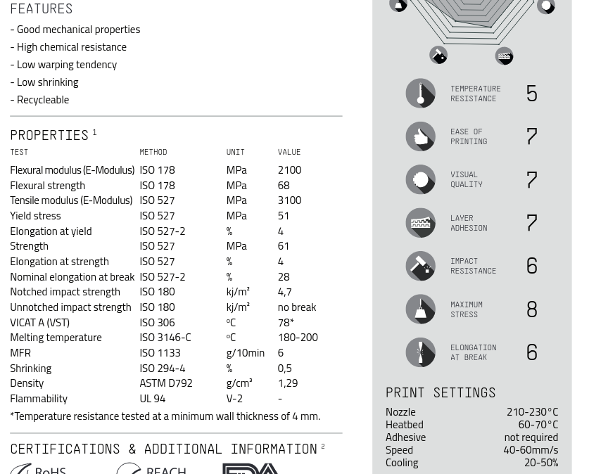

it's extrudr PETG, data sheet: https://extrudr.com/filerpool/download/datei/775/
on the beginning i had to raise the bed temp +10 otherwise material was warping since beginning, now i'm printing +85 first layer, then 80 without issue with the bottom layer

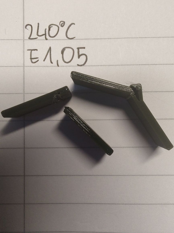

I did some  tests before and align a little profiles, even in manual from prusa is recommended to print PETG with 240... excluded some materials already after some weird behaviour. Also i tried to print that metarial at 243 C degrees, but while i'm using mini+ didn't want to mess the printer itself, so i stopped on this.
Also i increased extrusion multiplicator to 1,1 which i read that it will incre the performance of the parts,and i think it's like that, but introduced the need to check again supports for that settings. Should i use in general with  PETG  more or less "Top interface layers" for the support? I tried to use 0 with linear snug support, and it was quite ok, and with honey pattern i could not remove support at all. Especially that i found that supports are really tricky to remove when i print in the higher temp (240-243)... so now i will need to find better way to print supports with "better" temp. for PETG, because that tests printed with 230 are not realiable.

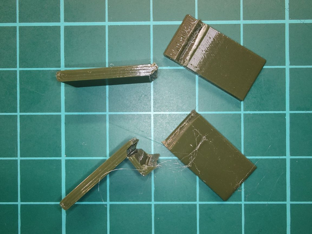

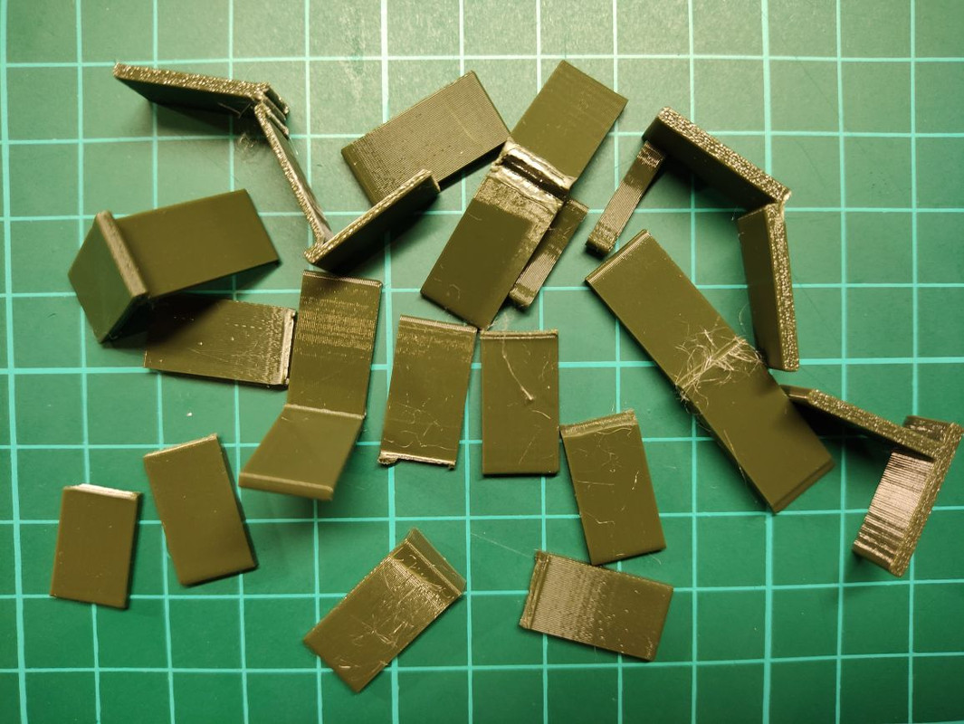

So i printed some of those little models for test... and for example i discovered that in general it was quite brittle, but for sure 240 degrees is much better than 220, which is far too low for this material, but i was also curious about what you wrote about extrusion multiplier, and i found also some prusa article referring to calibration of the printer to tune it a bit for particular filament here: https://help.prusa3d.com/article/extrusion-multiplier-calibration_2257 so i did that test too, but first my printed little brittle objects:
i tried multiple configurations... and those with EM1 are quite poor... still much better were printed in 240 degrees, some where so brittle, that the vase mode used to print calibration cubic felt almost stronger 😉
so i calculated according to the formula on that page, and first run in total gave me the result to put in the EM field 1.08, so with this new settings, i printed it again, and then was better,
but result after sum up was to set up 1.04 so i took average from two measurements and did 1.06 for that material... and now i'm printing third cube. Do you think it's good solution, or still i should look somewhere else? What i can see that indeed two walls seems to be thinner than the other two, and one corner seem to be a little underextruded... but i'm not a specialist, so do not know if this is a issue at all?

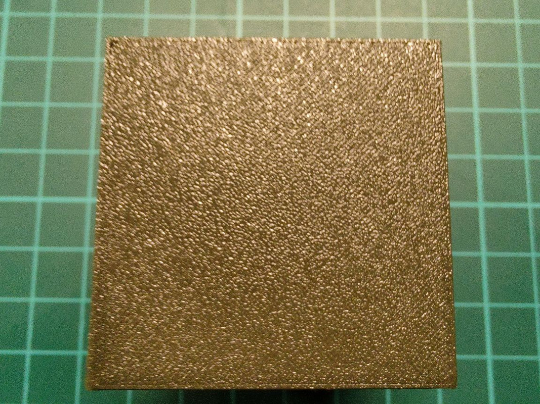

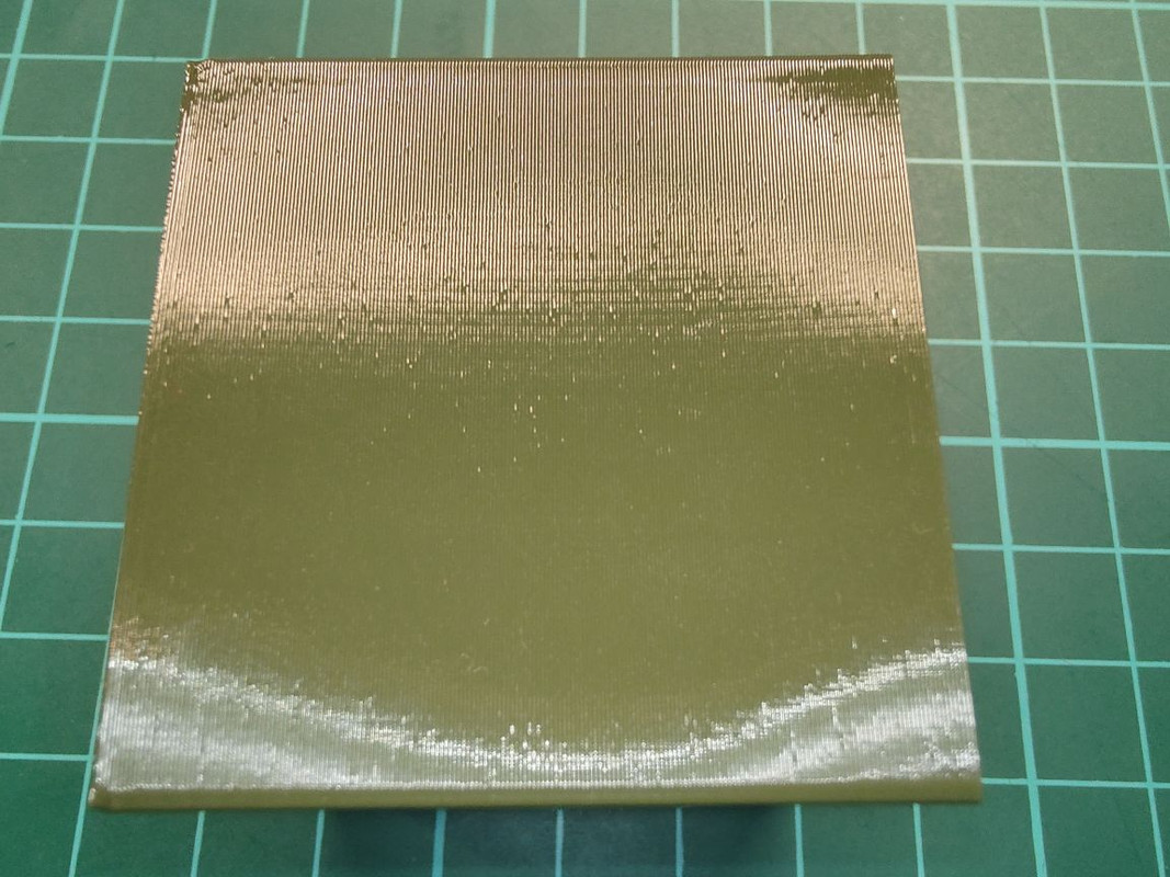

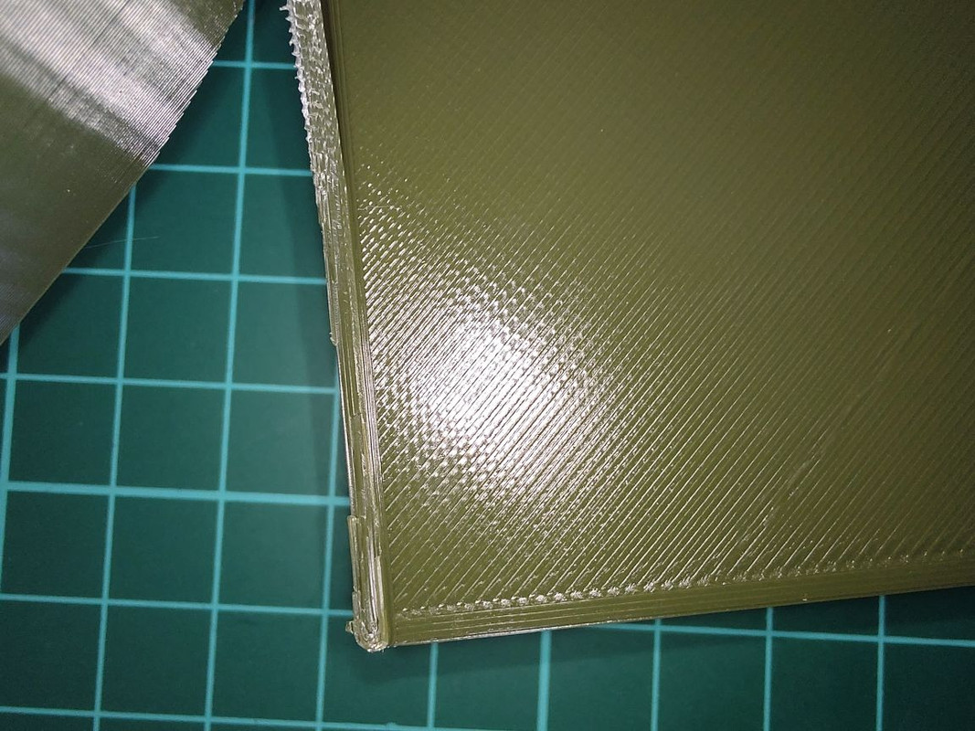

and photos of result, on the left there is a cube not well calibrated EM<=1.08, and on the right with EM=1,12:
and again closeup of the part which is not accurate (and brittle):
and after calibration ( https://help.prusa3d.com/article/extrusion-multiplier-calibration_2257)

ok, now corners are stronger, so some good direction...
