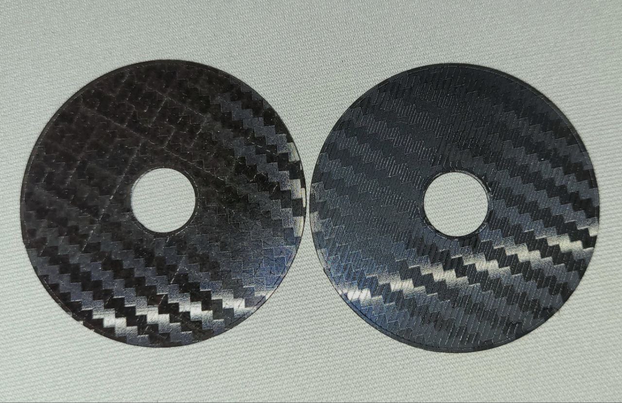

The best pattern in my mind to really break up the stripes was the Hilbert pattern.
A few years later, but after getting the Core One with really consistent 1st layers and buying one of these carbon-look sheets, I really wanted to get rid of the lines.
This post was the only one in over an hour of searching, that really got rid of them!
I now have some lines all over the place that look a bit like "scratches", but they give some kind of "used look" to the fake-carbon-look, which is fine.
Another benefit: the reflexions from the surface are way more uniform now.
I'll play around with the settings to get rid of these other kind lines and report back.
I've attached a photo, comparing 'Monotonic Lines' vs 'Hilbert Curve'. Worst lighting possible to really show the difference.
