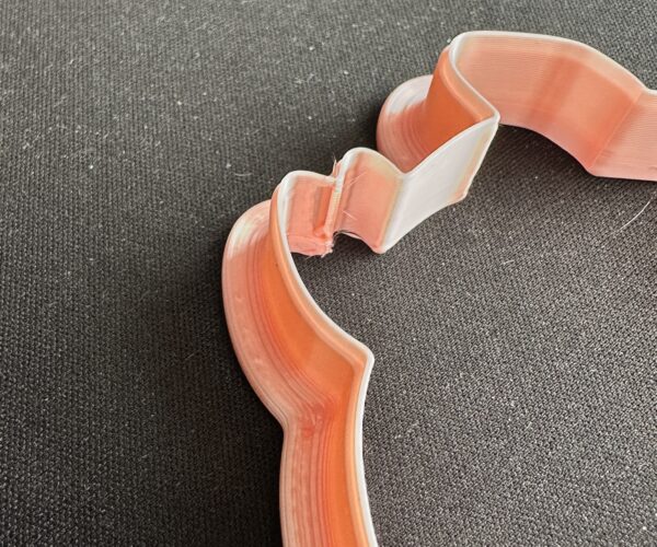

I'm printing cookie cutters and having an issue where the printer is creating gaps at the seams. When I select random seams it goes away, but then I have ugly pocks all throughout the print and I don't want that either. I tried staggered inner seams but his doesn't seem to do anything different and I'm still new enough to printing that I'm still trying to understand it all. I wish there was an option to have the seams hidden in edges of the printer, somewhat randomly but always at an edge where it's still 's still somewhat hidden. Is this possible? Using a Mini+ with a .6mm nozzle. I made the cookie cutter edge (top) .6mm and the bulk of the wall 1.2mm, hoping a multiple of the nozzle would help but that doesn't seem to affect anything either. The pics attached are using PLA silk but I'm having the same issue with a matte grey PLA as well. Using Prusa Slicer 2.8.1+MacOS-arm64. Any help? Thank you.

Try with different slicing algorithm or experiment with smaller retraction.
