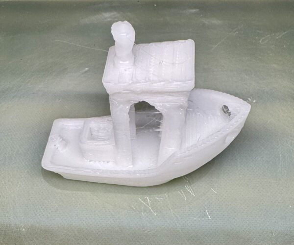

I also needed a very large brim to keep the part attached to the print bed. Here I've got the bed at 120° and the chamber at 58° to control warping. It also needs to be printed very slowly. I'm using a max flow rate of 2mm^3/s which works out to around 20mm/s with 0.4mm nozzle. The fans need to be off to keep warping under control. It means small features like a Benchy smokestack can be a challenge:

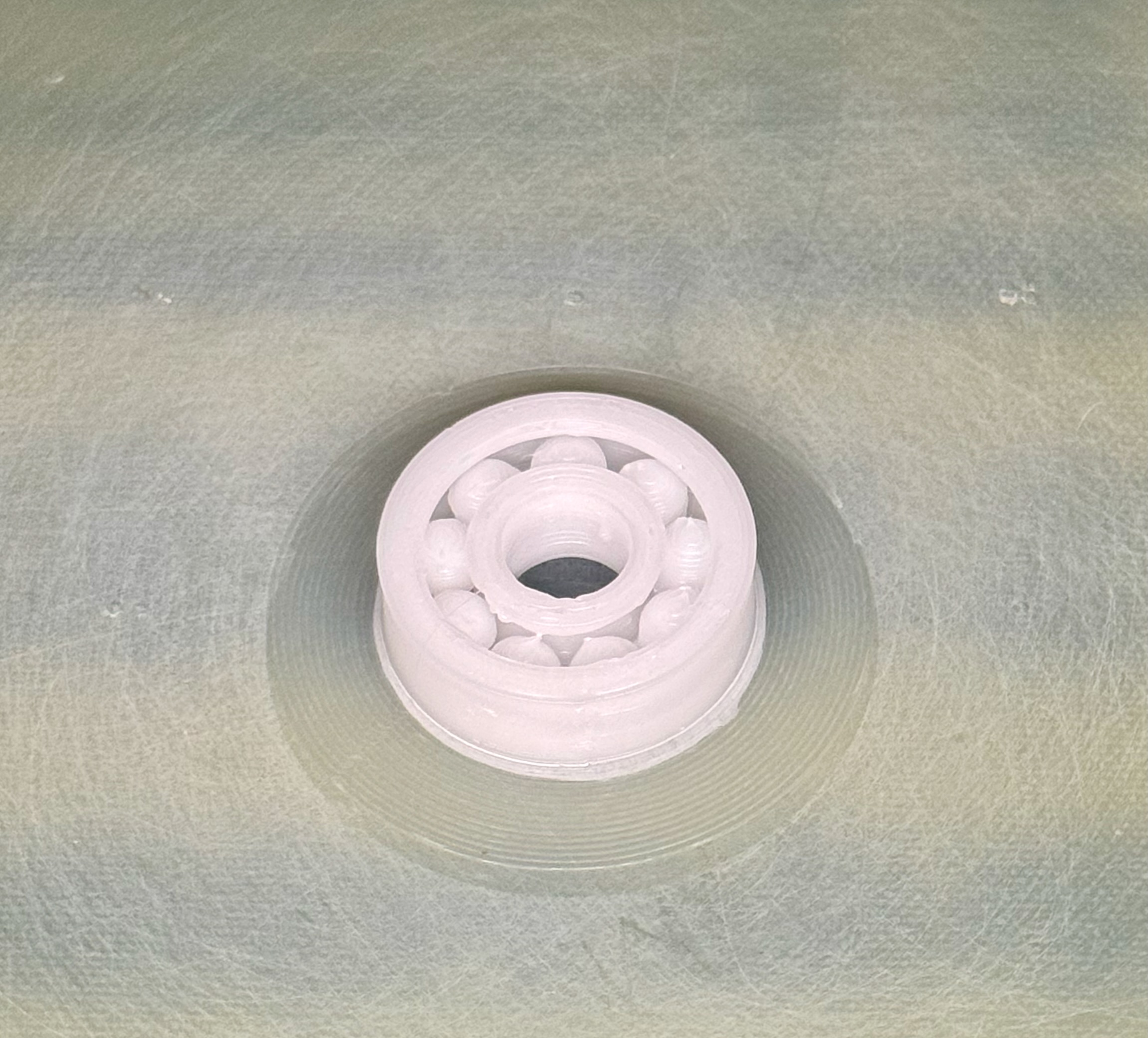

Working bushings yes, but not complex bearings. I did attempt one but the shrinkage made it hard to control dimensional accuracy. May attempt gears.

Thanks! Sleeve bearings (= bushings?) are what I was thinking of. Good to know that you consider that a realistic application for 3D-printed POM; that's a good option to have in one's back pocket for repairs.
Ball bearings are a tall order for most 3D printed materials, I would assume. They probably don't benefit too much from low surface friction, since the surfaces are not meant to slide vs. each other. I would rather focus on dimensional accuracy and wear resistance -- and realistically would search for a suitable off-the-shelf bearing.
