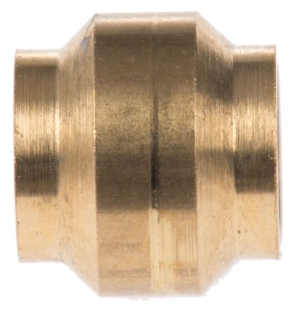

The tube from the extruder to the hotend keeps popping out of the fittings. Once on the end with the extruder and twice from the end with the hotend.  I can't seem to reuse the "brass olives", as described from ( https://help.prusa3d.com/en/guide/how-to-replace-a-bowden-ptfe-tube-mini_142572) Step 4.  I have some replacement tube but I know the technical name of the parts to order some more.  I can re-use the brass nut but can't get the olives to go over the tube.  I don't see where I can order just the "olive" parts in the Prusa shop either.  Also, what would be the size? Please help!

These compression fittings are very common, they are used in air con for example. There should be a number of local suppliers, there's no need to go to China. If I search ebay, I find 431 hits, delivery in a few days. The technical name is "4mm brass compression olive" 🙂

As @bobcousins mentioned they're compression fittings, similar to ferrules uses in Swagelok (or Eaton) tube fittings for air and gas service.
A couple months I was also curious if I could purchase them separately. After asking Prusa Support about purchasing them and getting the unfortunate reply that they don't sell them, I ended up finding these on Ebay: https://www.ebay.com/itm/10-Pack-Lot-4mm-Tube-Ferrule-Brass-Compression-Sleeve-Ring-Fittings-Coyote-Gear/222107931567?hash=item33b6aa13af:g:tsYAAOSwd3dZaA4~
They were $17.88 (w/shipping) for 10 of them when I bought them so not necessarily the cheapest thing but they do seem to be compatible.
The invoice they sent mentioned they have cheaper prices on their website but I didn't check into that to verify.
Below is a picture comparing the Coyote Gear and Prusa fitting (note the Prusa fitting is crimped).

Hi!  I'm not saying you should, but I just successfully reused one by expanding the squeezed end with a small pair of pliers, just pushing down a few times until it's enough expanded. Then I made sure to turn it so that it's the fresh end got crimped this time as I don't trust the reused part, you can tell it's been used, but since it's got two sides I figured why not? 😇

These compression fittings are more suited for high pressure applications. The problem with using PTFE tubes is that the inner diameter is reduced by too high compression and this can result in filament transport problems. If the compression is too low, the PTFE's can become loose, which happened to me several times.
For this reason I decided to use the PC4-M8x1.25 connectors, which are working fine without any issues.

It's recommended to keep (the solid end) of a 2 mm drill inside the tube when squeezing it to avoid this. ..which I missed at one point but then I just just carefully used the drill end of the bit to clear out the passage in the tube by hand, worked fine.

Thanks for the post, it put me on the right path. I ended up using a finishing nail punch to stretch the olives.  Put it on soft wood and give it a few taps with a small hammer until it fits.
