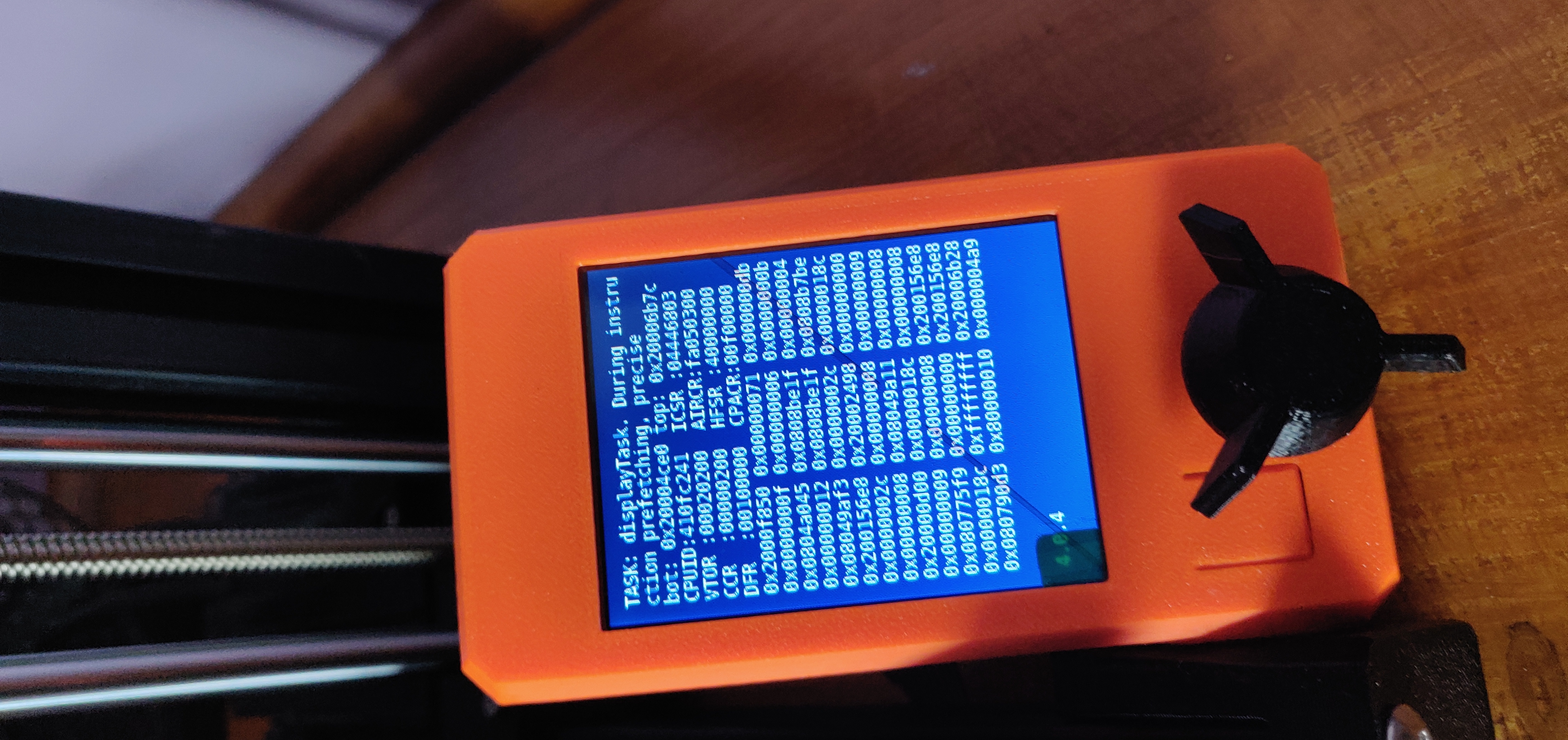

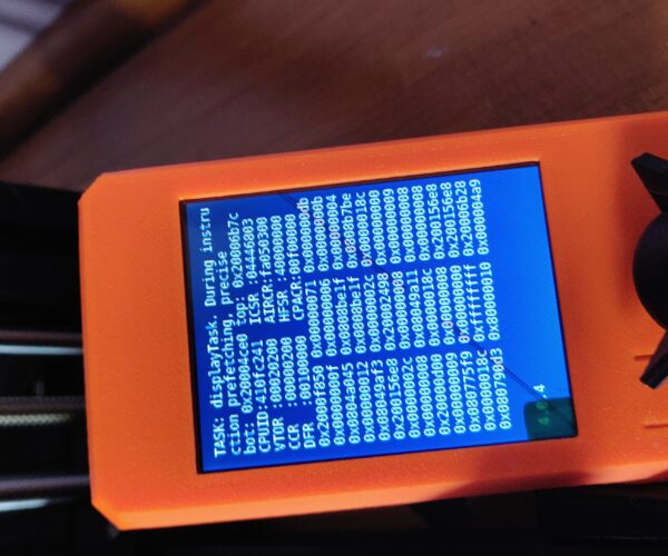

Hi. I am having the same kind of problem, but it is intermittent. Sometimes it works, sometimes it doesn't.  When it should heat the bed it just reset it self. Always comeback with the Watchdog reset mesage, but more then once it showed up the follow message. I don't know what does that mean Error message
If anyone know what it could be, please, let me know.

RE: Prusa mini resets itself showing watchdog reset
Instruction prefetch fault probably means the code jumped to a bad address. I guess that a watchdog fault could also occur if the code jumped to some random point in memory and got stuck in a loop.
In both cases, there is a small possibility it is due to a fault in the hardware, but I would expect the reason to be a bug in the code. I think a few other people have seen these type of issues. I would raise an issue on the github repo, it's the best way to get the developers attention.
