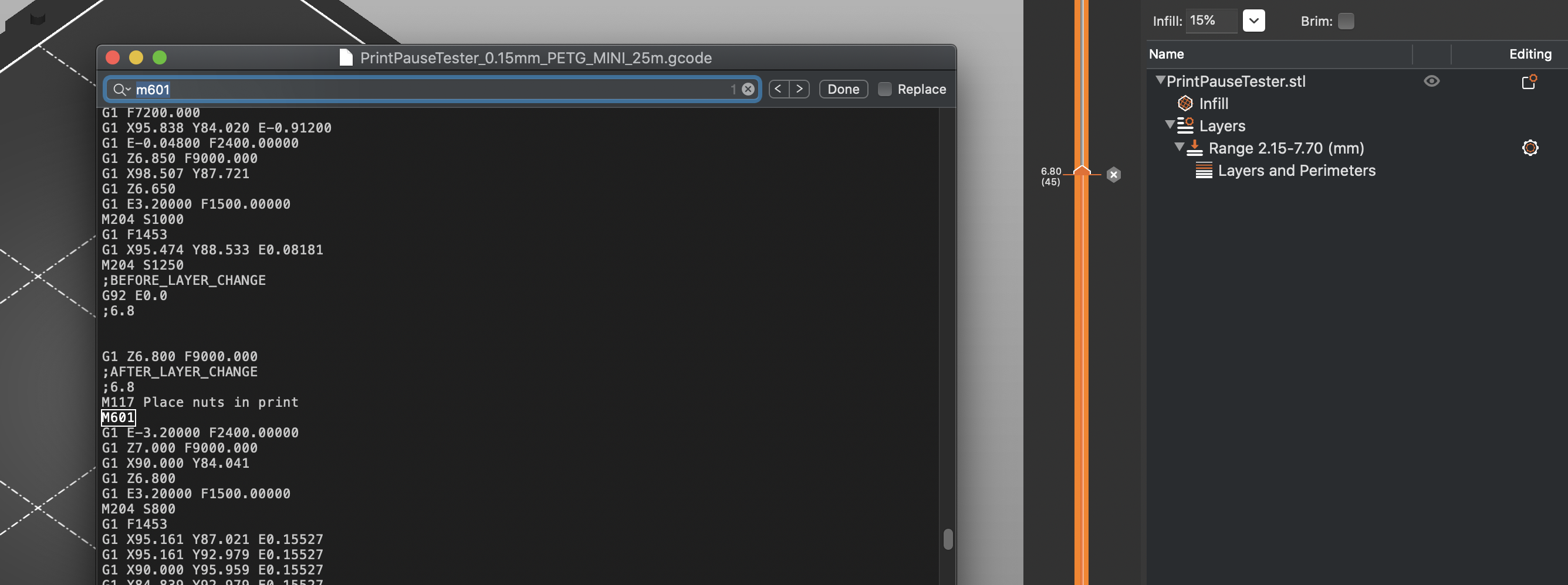

I am trying to pause a print to insert some nuts in a print but after 8 hours the print just kept going. I made a small test part with the same nut void and the pause after to verify the functionality and noticed the same issue. Checked the code (screenshot below) and the M601 command is there but the Mini just skips over it. Anyone have any ideas? Does the Mini fw support this command?
Prusa Mini running 4.0.4 fw
ps. from googling around I also saw some old posts that most peoples problems were with the print not being able to be restarted after the pause and the issue was that the resume M602 command and a brief pause was missing from the code. Didnt see those on my gcode so anticipating this could be the next problem.

It isn't supported in the firmware for the mini yet 🙁
I have an issue open on Github for it: https://github.com/prusa3d/Prusa-Firmware-Buddy/issues/283
Sorry for the bad news. I have been using a wait instead, which is supported but not as convenient.
