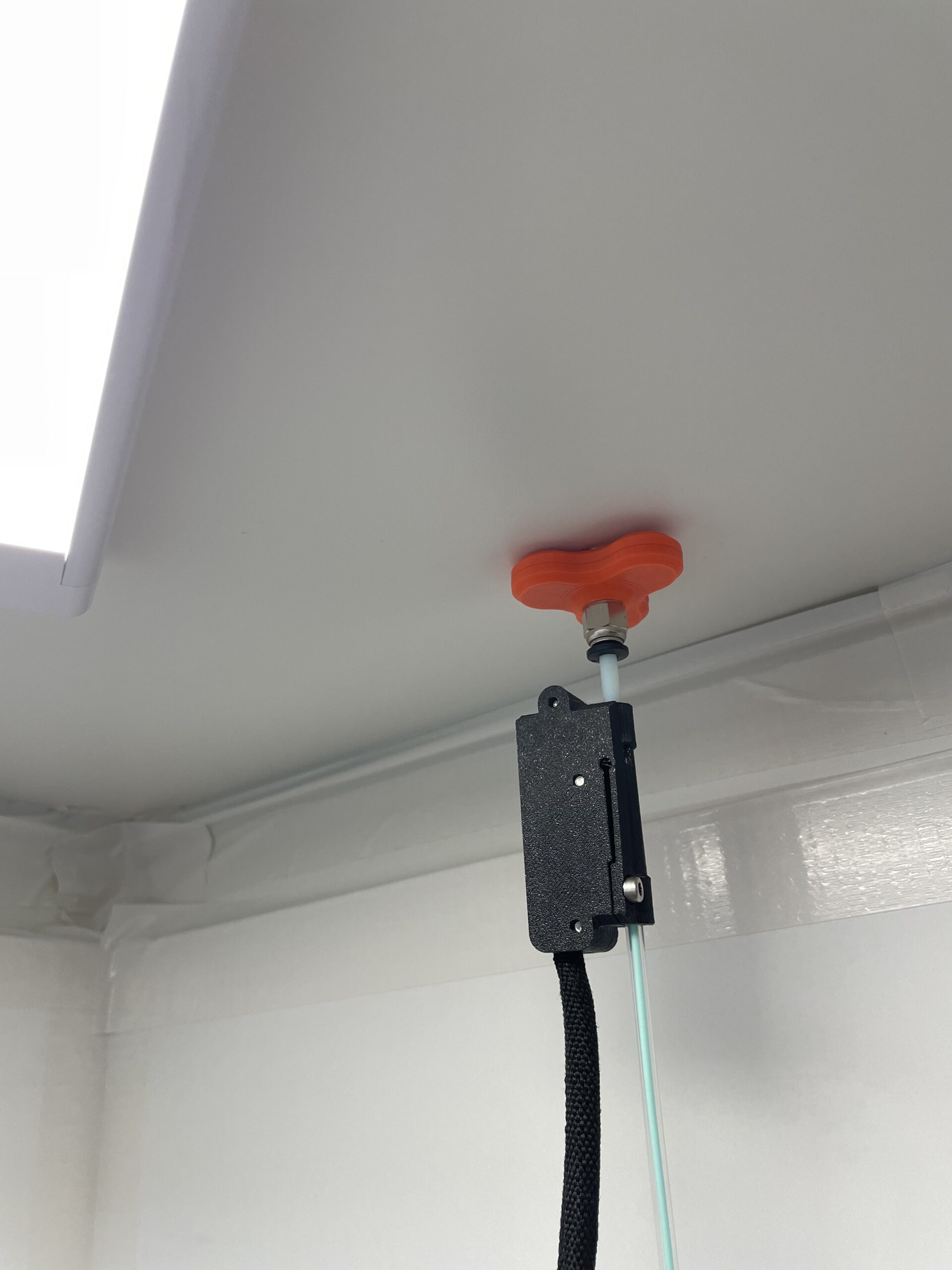

muhendees
(@muhendees)
RE: Filament sensor PTFE tube came off.
Here is how mine looks like inside enclosure. Filament fed from outside.
I took original tube and replaced it with 3rd party ptfe tube(I bought bulk)
also replaced other side with transparent PTFE so I can see it better 😛
