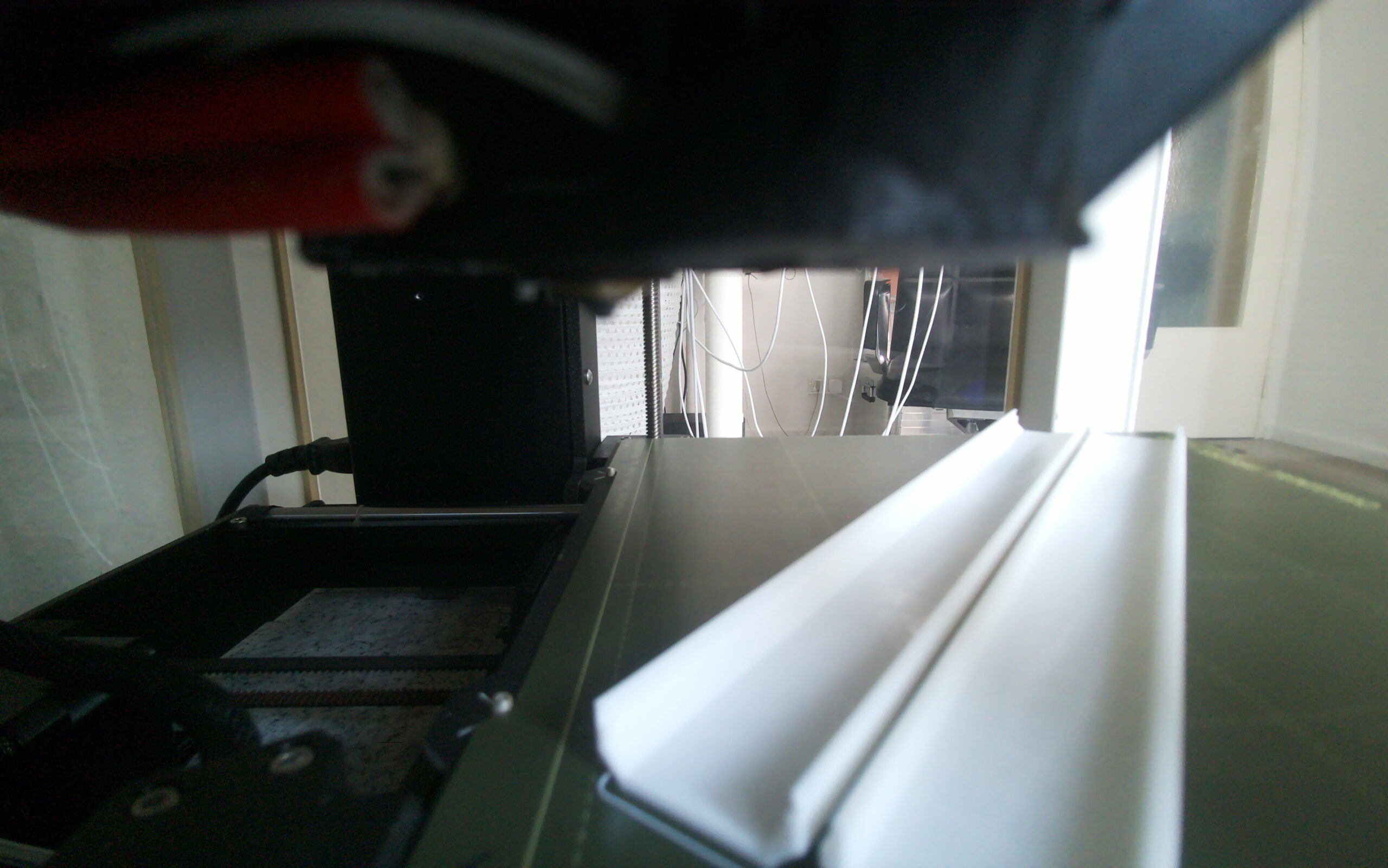

Hey everyone,
I’m still running into issues with blurry images when using the RPi Camera V3 Wide connected to an RPi Zero 2W on my Prusa MK3S+.
I’m currently running PrusaLink 0.8.1, and while reviewing the release notes for 0.7.1-rc1, I noticed the mention of the prusa_printer_settings.ini file. Inspecting it, I found that the focus slider in the PrusaLink web interface updates the focusvalue between 0 and 1.
According to the official Raspberry Pi documentation ( https://datasheets.raspberrypi.com/camera/camera-module-3-product-brief.pdf ), the focus range of the V3 Wide starts at 5 cm. I’m using this mount ( https://www.printables.com/model/1253492-prusa-mk3s-mk3s-pi-camera-v3-mount ), which positions the nozzle roughly 5 cm from the camera when the X-axis is set to 10.
At this distance or greater I can’t get a sharp image — changing the focus slider doesn’t seem to affect the image at all, even though the value in prusa_printer_settings.ini does change. However, the image remains out of focus in both cases and values in between as well. I will attach two images with both of the extremes focus values for inspection. To me, they look identical. I tried restarting PrusaLink in between setting changes as well.
Am I missing something to enable or use manual focus on this setup? Is there any way to activate autofocus instead?

Not sure if this has been updated in a while, but I was having a similar problem getting the pi cam v3 to focus while mounted with an X axis motor mount.  I found that there is now a setting in prusa_printer_settings.ini for camera focus:
[camera::quz390woShCB]
id_string = /base/soc/i2c0mux/i2c@1/imx708@1a
name = RaspberryPi Camera: imx708
driver = PiCamera
focus = 0
resolution = 3840x2400
trigger_scheme = TEN_SEC
I've tried changing this value to 1 or 2, but it doesn't seem to have any effect.  If set to 2, after a reboot it defaults back to zero, so I'm assuming 2 is not a valid parameter.  Set to either 0 or 1 it still wants to focus behind the printer or at closest the Z axis rod.  The nozzle is still blurry 20cm away even though the camera should be able to focus on anything further than 5cm away.
PrusaLink 0.8.1  running on Raspberry Pi Zero 2 W with an i3 MK3S+
