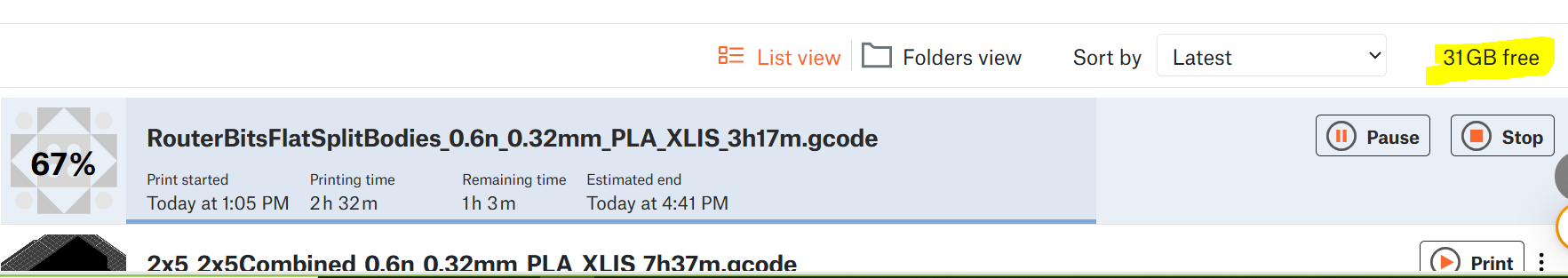

Hi, I am not 100% sure where to find that information but if I look into the Connect printer files page it shows 31g free space?? Is this what you need?
Posted : 25/10/2024 7:41 pm
JP Guitars
(@jp-guitars)
RE: Prusa Connect Download Error
That's the usb stick spare memory. I'm not in front of my PC at the moment so can't do a screen grab, when you first go into Connect, at the top next to the help and forum links there is a link called "Connect Files". If you click on that link you will see a little down from the top a percentage and a bit that says "x of 1.0GB", that and the percentage are the interesting numbers.

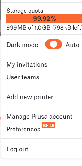

There might be a possibility I found what your asking for?
What is this storage of??
Posted : 25/10/2024 9:11 pm
JP Guitars
(@jp-guitars)
Right, that's your problem.
Connect gives 1GB of online storage, which some people use to store gcode for things the regularly print. In my experience most people just use it to pass data through. When you send a job via Connect, either using the Web interface or from the slicer it goes to the Connect Server which stores it then passes it on to the printer. If you keep doing it and never clean it out eventually it fill up and won't let you upload anything more, which is what has happened to you.
As you didn't know the storage was there, it is probably safe to delete everything from that page or alternatively you can selectively delete files.
Personally I just go into that page periodically and blow everything away. Anything I want to keep, I keep on my PC.
For reference if you send via Link it does not go to the server so never fills up but as I prefer the ui on Connect I always use that.
Posted : 25/10/2024 9:21 pm
