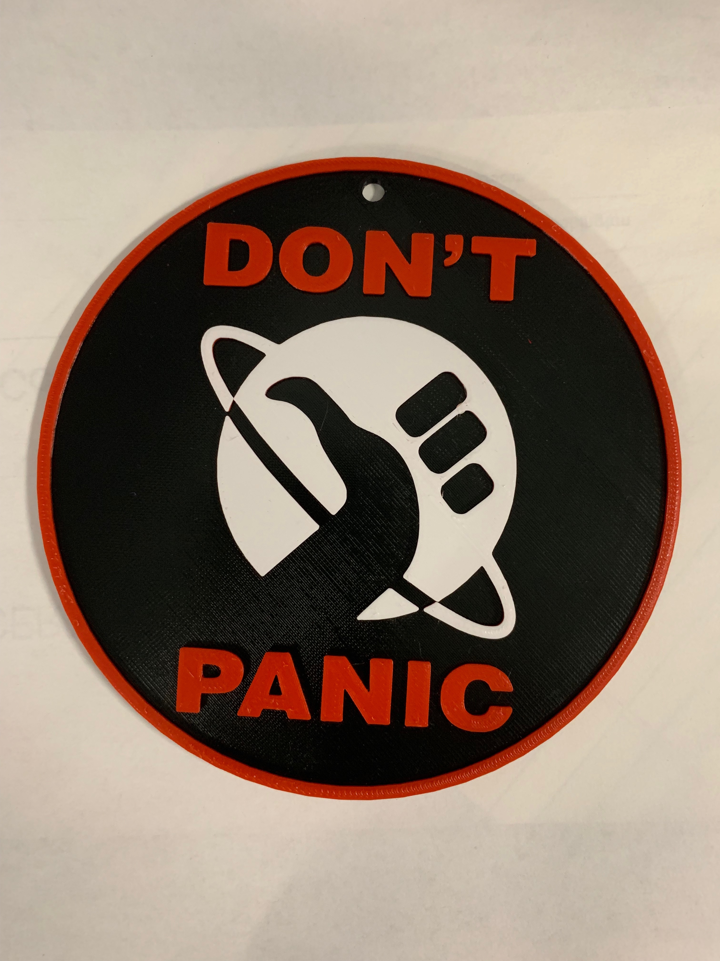

It's been awhile since I've done one, but as I recall when you get to ca color change the print head parks over the right front corner of the bed and beeps every few seconds to get your attention.  You then push the knob to retract the filament and it patiently waits for you to insert the next color, purges it, asks if the color is correct, you push the knob, it purges a little more then continues the print.
When I was doing this a lot I would leave the printer unattended and sometimes would go an hour or more before answering the beep.  Now, I don't recommend that, and I do try to change filament quickly, but I have let it go.  I want to say Joan is right if you wait too long that the nozzle goes cold, but I can't recall.  I do know that on my Ender 3 it does that because almost the moment it parks the print head it shuts off the nozzle.
In any case I don't think you're going to have nozzle damage.  The temperature the nozzle is at is just enough to keep the plastic in a semi fluid state, little bits of it get stuck to the heat block while printing and it takes quite a long time for that stuff to discolor.
Here's one of the fun ones I did with this technique.
Cheers
-Bob
